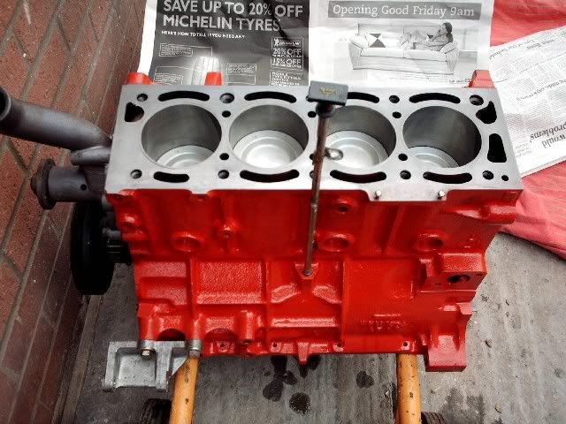

Wire rung block and bored 20 thou oversize.

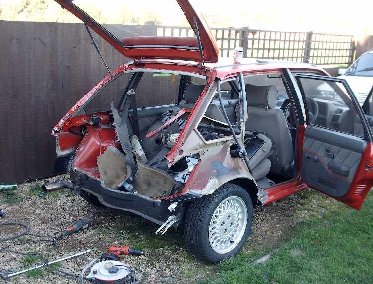

After an Astra modified my back end when i was stationary at a roundabout in sept 2005.
Close up of the non-existant door gap.
The rebuild commences.

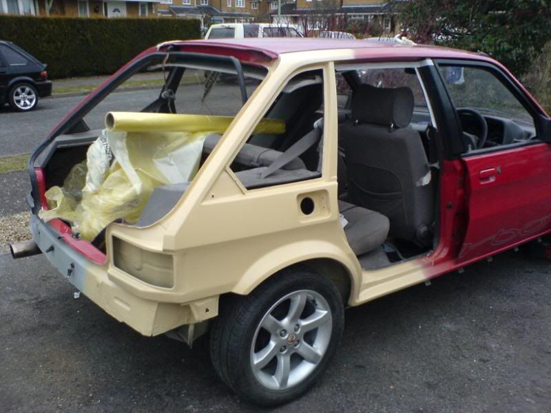

And the paint goes on -
Nearing completion
