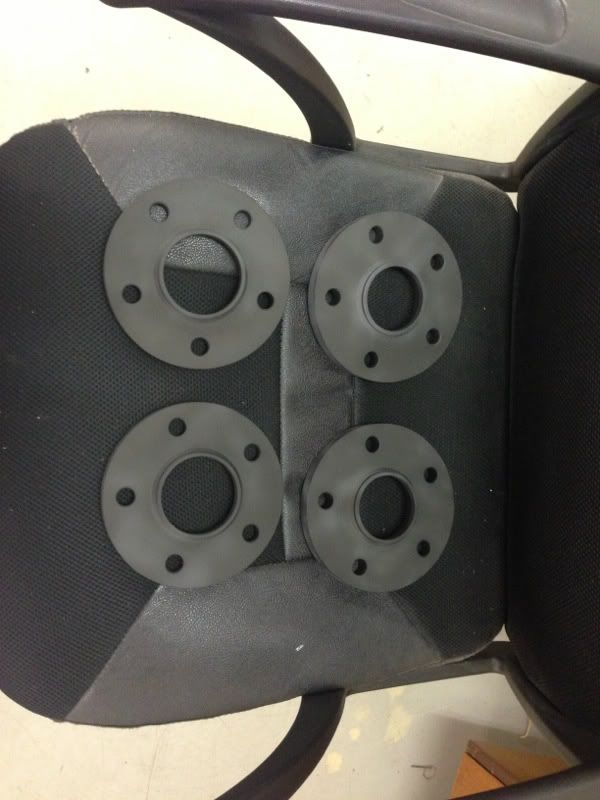

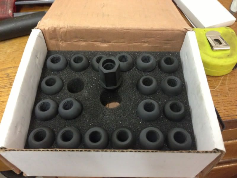

Wheel spacers and wheel nuts are back from being hard anodised.

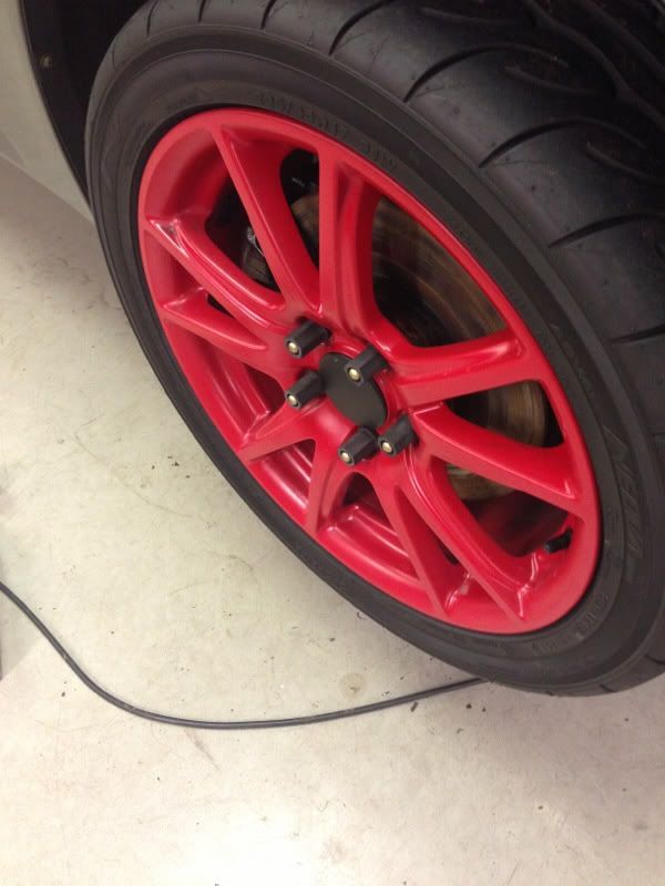

Then I tried a wheel on the car.
What do people torque alloy wheel nuts to?

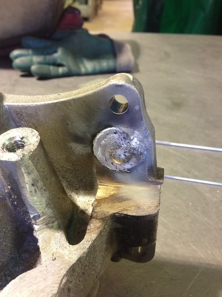

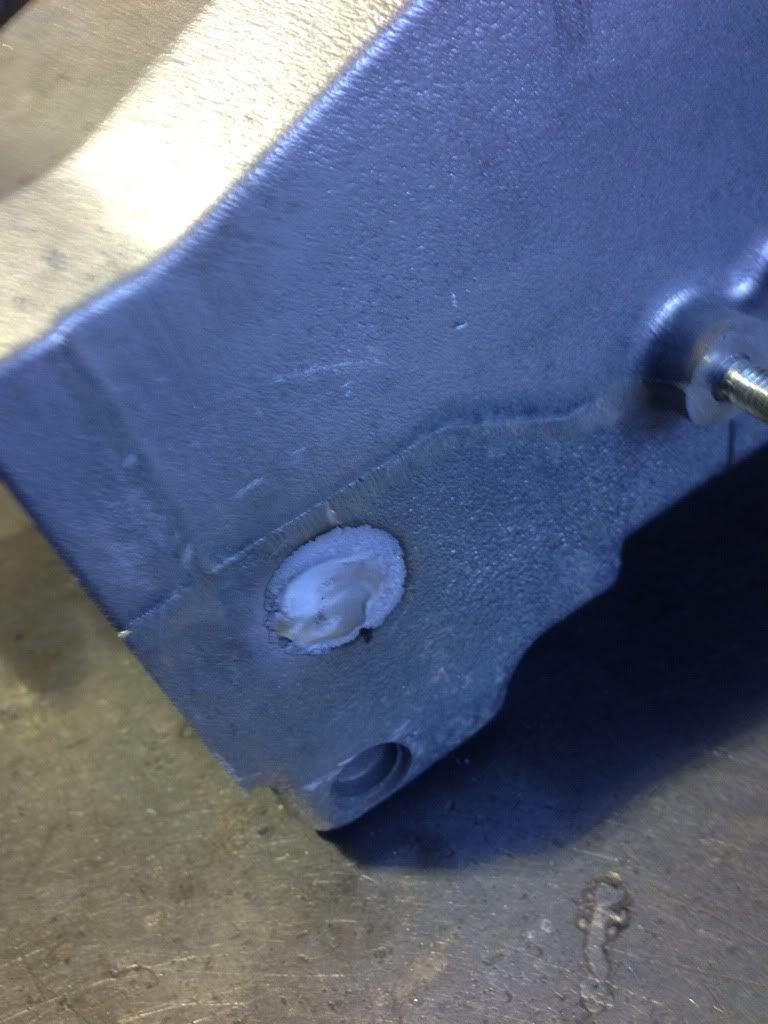

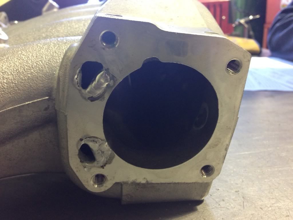

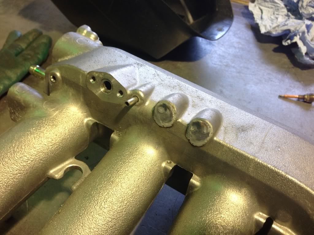

Been modifying a spare inlet manifold today whilst I was waiting for a bloody computer as it went wrong.
I have removed the ports I won't be using and welded the holes up. I'm also enlarging the feed to the Bov as it is only a 3mm hole at the moment and it needs a 5mm id.
I have cut off the egr valve port and filled the hole
Finally the new throttle body I have has a 74mm bore yet the manifold only has a 63mm hole. So it will be machined to suit the new TB but the idle control ports are within that diameter so I have welded them up partly so it can be machined and still have a mating face to seal on

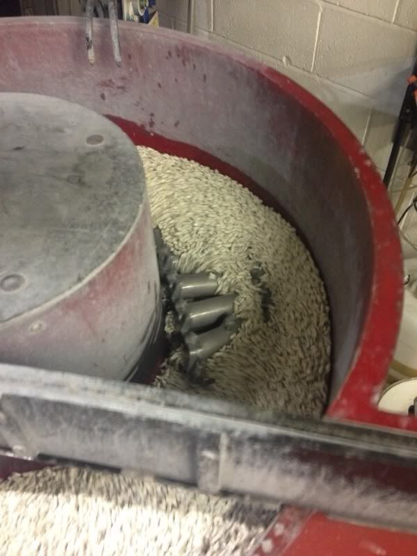

I have put the whole manifold in my rumbling machine to polish/clean it up inside and out.
And a video of how it works.

Used to have one of them years ago (or similar) fantastic things........used to love experimenting with the cutting media.
mattie170
Posts: 178
Post by mattie170 »
That's porcelain in there as it won't remove hardly any material. I put some polishing paste in with it to just clean the inside.
I have to say the quality of the casting inside is amazing. Honda must of spent serious money on the tooling to make it.
