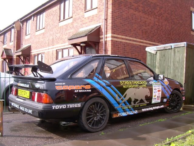

Alan had wanted to practise his launches as he was a little worried about launching this car with this clutch. Alas this was not possible. So once back at mine we continued the big clean of the car, including touching up the paint on the inside.
The other concern we had was that since changing the turbo the control pipe that plumbed into the turbo was now plumbed into the inlet manifold due to a diffent turbo housing. This was causing the turbo to overboost and the boost controller to kick in and switch to 'get you home' mode. Gordon had said he would come to the pod to give us a had if needed.

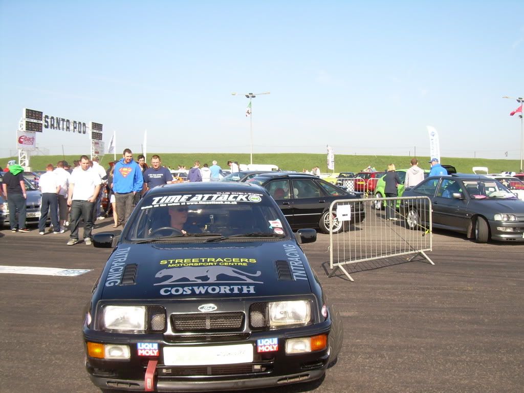

We arrived at the pod with very little traffic. I set to polishing the car again, under Waynes supervision, and Alan went to sign on. Once back Alan decided to go out early, so off he went.

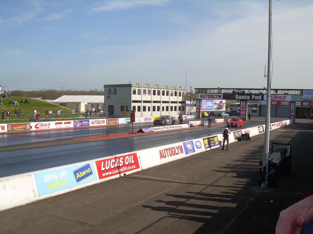

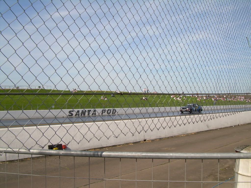

Run 1.
Bogged down off the lights and overboosted all the way down the strip. meaning that Alan had to press a button to reset the controller every gear change......Not happy.
Run 2.
Alan decided to try it from flat...not a good idea....and still over boosting.
By now Bart's toy's were well and truely out the pram, so i suggested he ring Gordon who was somewhere around. He reply was that I should do it, or words to that effect...So i rang Gordon and he said he come over. At this point Wayne following on from something Bart had said about the boost contoller pipe, layed it out in another route almost reducing the length by a third. Gordon turned up and said that it might help but that he would look at the boost controller and re set it. Basically he dropped the peak boost right down to prevent it over boosting. We had gone from 21psi to 14psi.
Run 3.
Better launch, no overboosting and his quickest time for the day, all added to make one happier Bart.
Run 4.
A repeat of Run 3.
