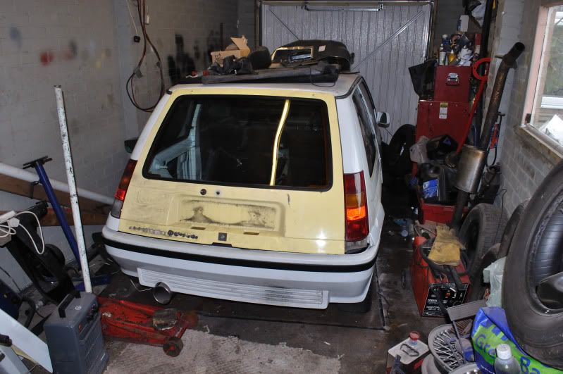

This is how the car turned up on my door step after being towed,
Carb and turbo had both been removed and put in the footwell

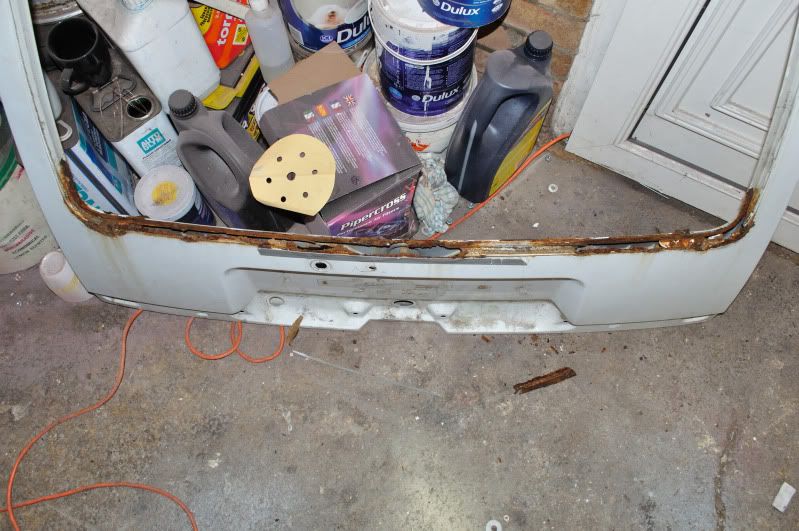

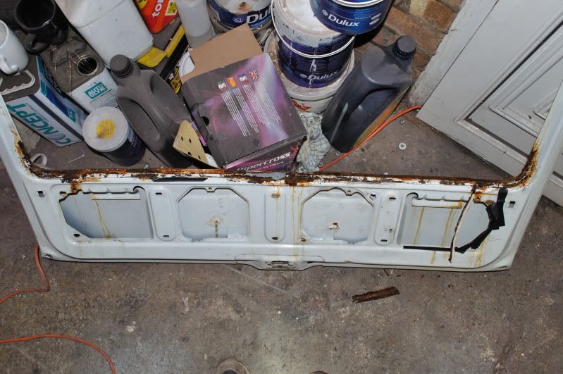

Found a few medium size rusted through sections in the drivers outer sill and a small hole in the passenger side outer sill.
So far have cut out the rusted sections and put in new metal and welded it, seam sealed and painted with paint, got to do the rear of the drivers sill as the inner sill needs a bit of welding but need to drop the tank as its too close for my liking
