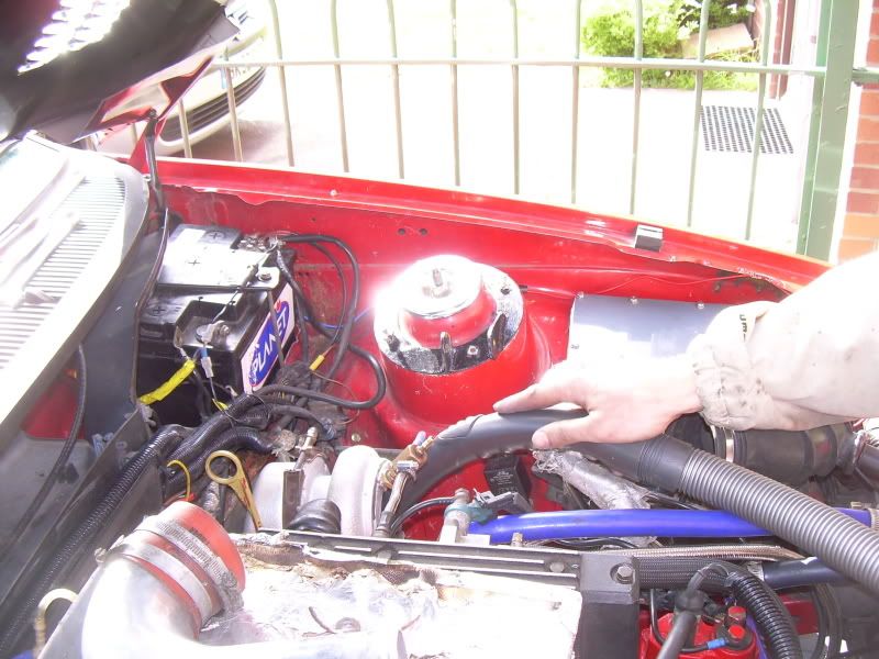

Alan is working all this weekend but the turbo had to come off which due to the lack of space was going to be a nightmare. Alan had managed to get in contact with his brother Wayne to come over and give me a hand.
By the time Wayne had arrived I had got all the pipework off and was starting to unbolt the turbo.

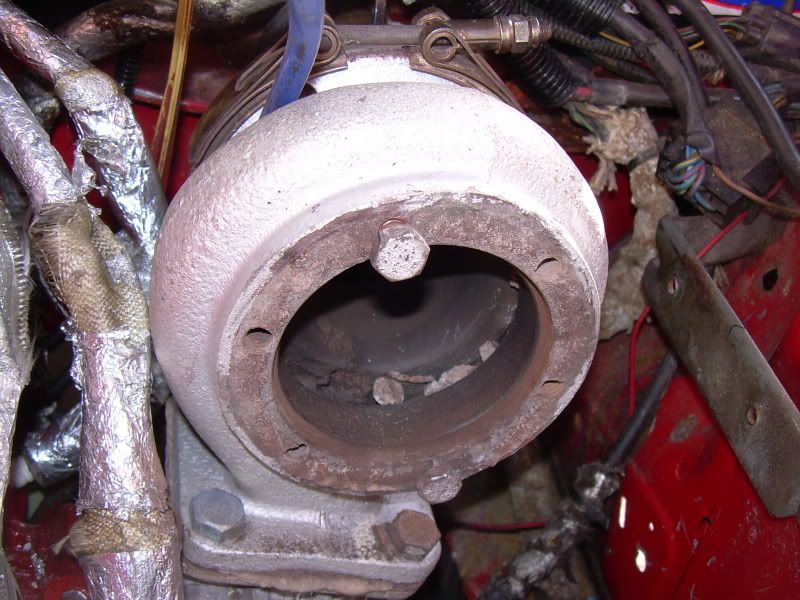

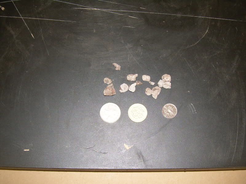

I already had an idea of what was waiting for me as Gordon (Streetracers rolling road tuning) found something yesterday that was a big clue.
What you can see is actually exhaust paste :o

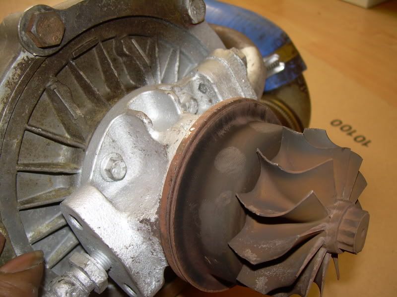

The fan still spins freely with no play and hardly any noticeable damage to the fins. We decided to refit the turbo but first gave it a good clean out.
I will be taking it out tomorrow to see if it now producing boost...fingers crossed.
As you've discovered for yourselves, exhaust paste, before the turbo, is a big NO! Use copper slip if anything.
