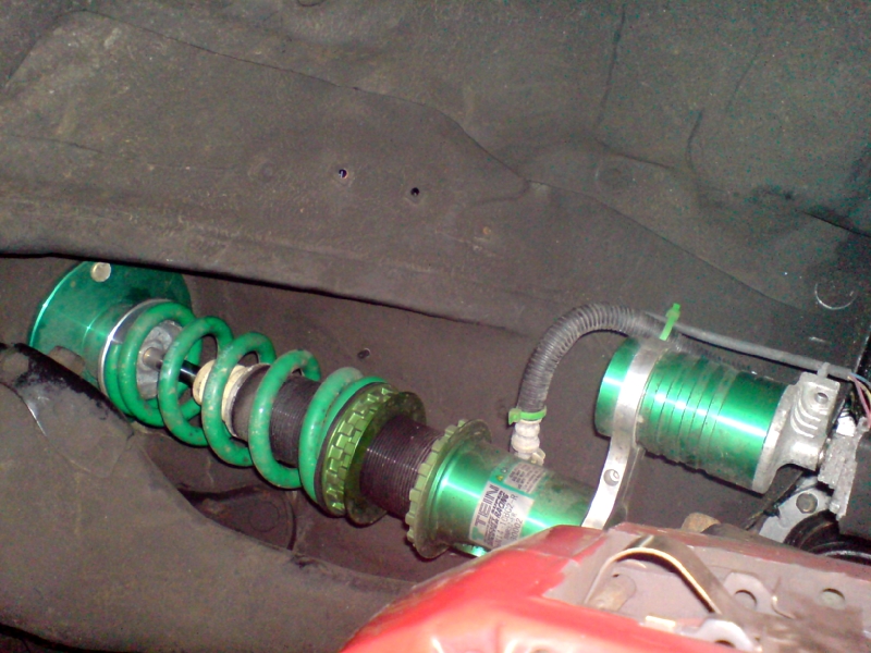

TEIN RS Circuit Master coilover suspension with rebound/compression adjustment and remote reservoirs.

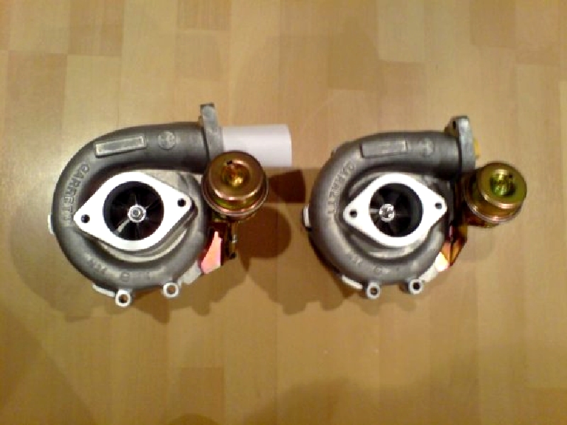

Garret GT2860R twin turbos

do those shocks have remote resevoirs?
