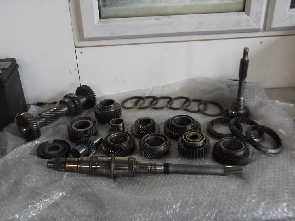

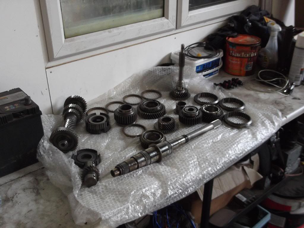

After a very pleasant drive over to Gordons we arrived just after 10 to be met by a massive jigsaw puzzle

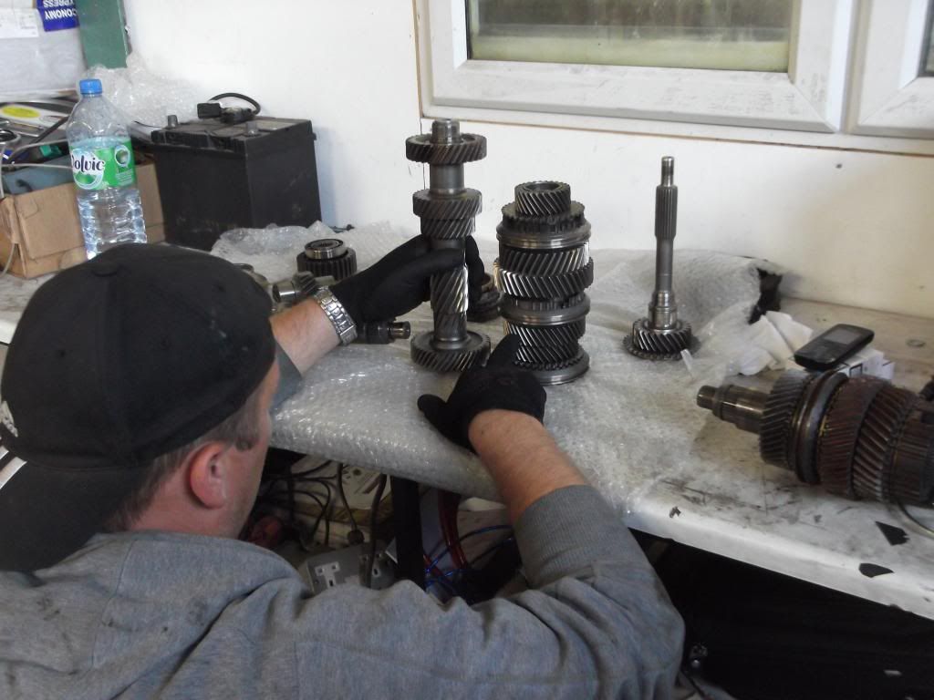

Before we got started Alan put it together using a photo we took before taking it apart, just to see what went where.
After a couple of hours it started to look like a gearbox as we needed Gordons help who was going from job to job.

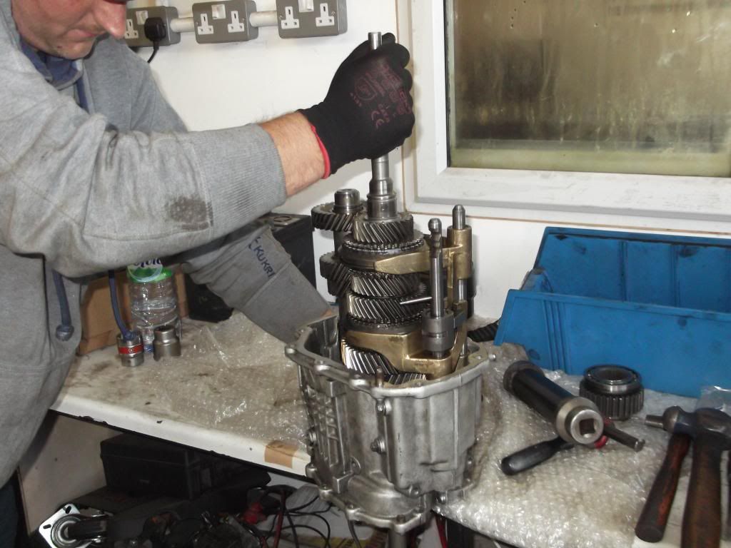

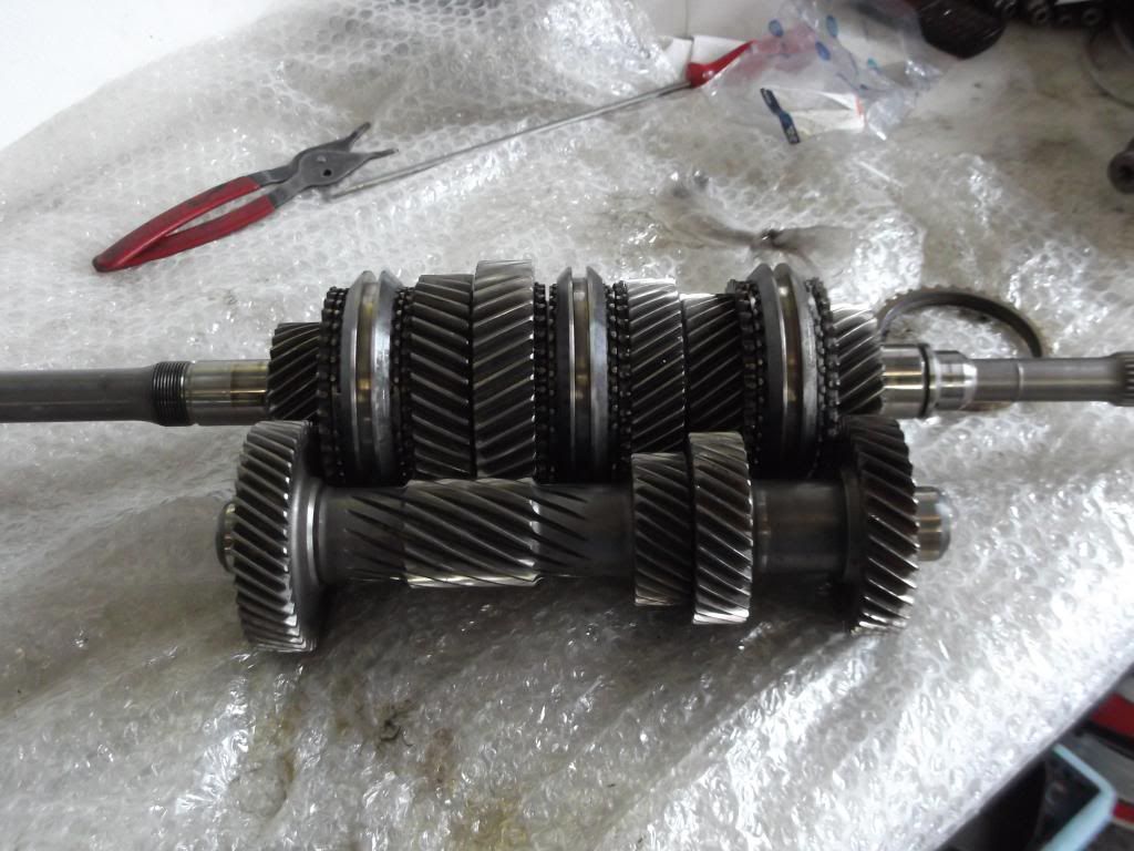

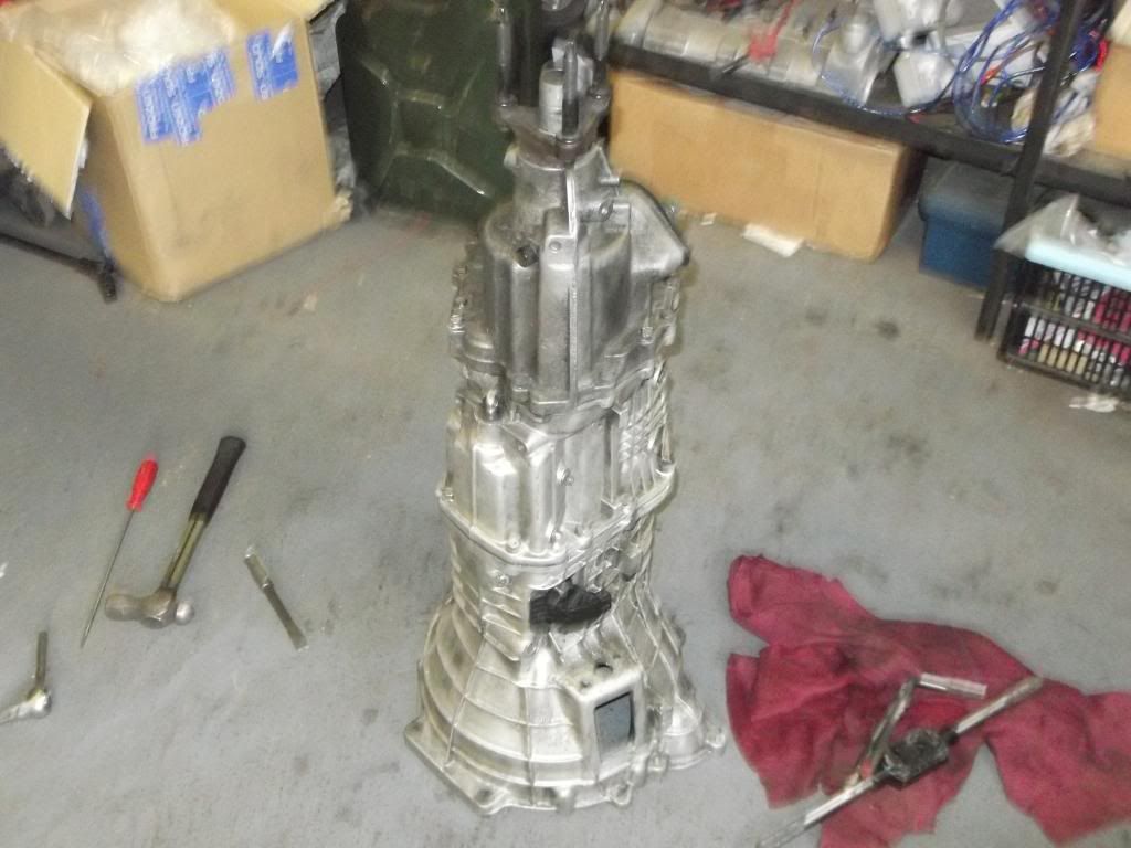

We were now on the home run, just had to fit it back into the casing and build up the 3 sections of the gearbox.

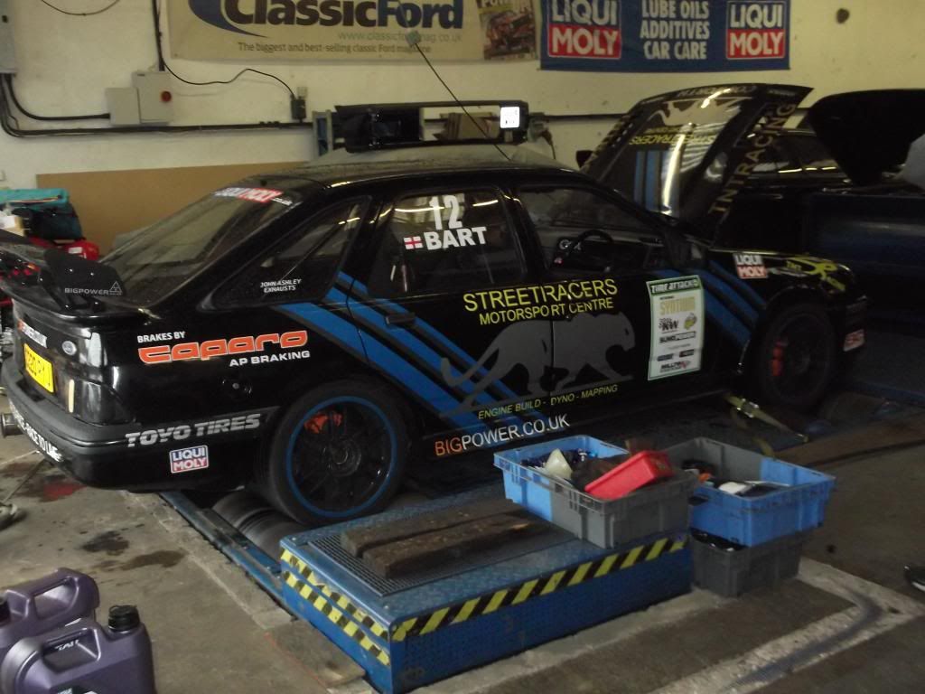

By 5.30pm the gear was all built and that meant we just had to swapp the engine mapps and check everything over on the dyno....half hour tops.
With the car strapped on the dyno and everything warmed up, Gordon swapped the map and ran it up on the dyno.
He called Alan over and all of a sudden there was a flurry of activity around the engine. The car was only making 18psi of boost instead of the 26psi that it was set to.
Not happt was an understatement.....After a lot of checking things Gordon came to the conclusion that a little plastic restrictor in one of the boost pipes was not resticting the boost causing the wastegate to open to early.
Once this was changed the boost came back and I have to say when Gordon did a full throttle run going through the gears I can't believe how quickly it went through the gears especially as Gordon was taking it to the shift light in in 1st, 2nd, 3rd and 4th.
