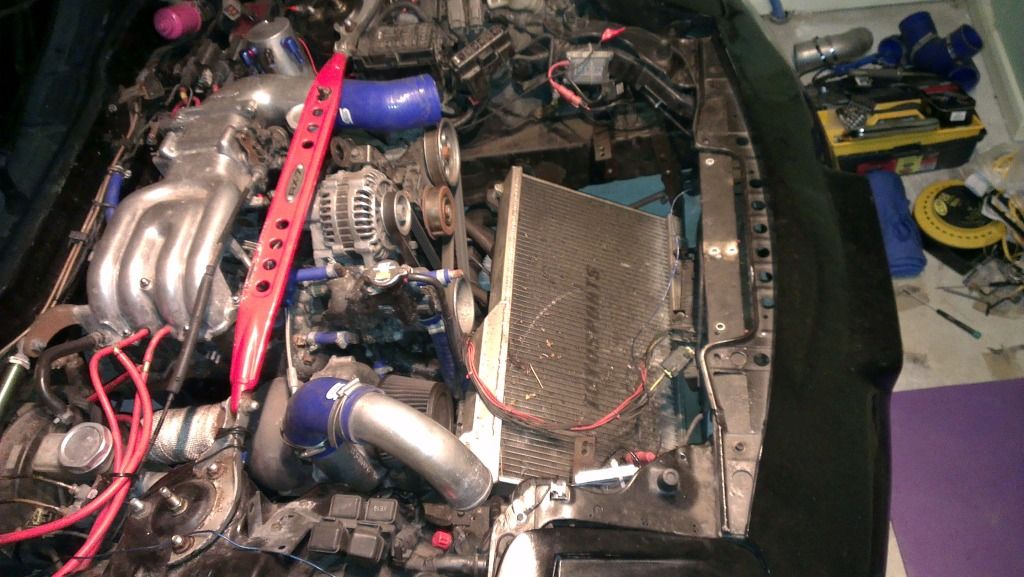

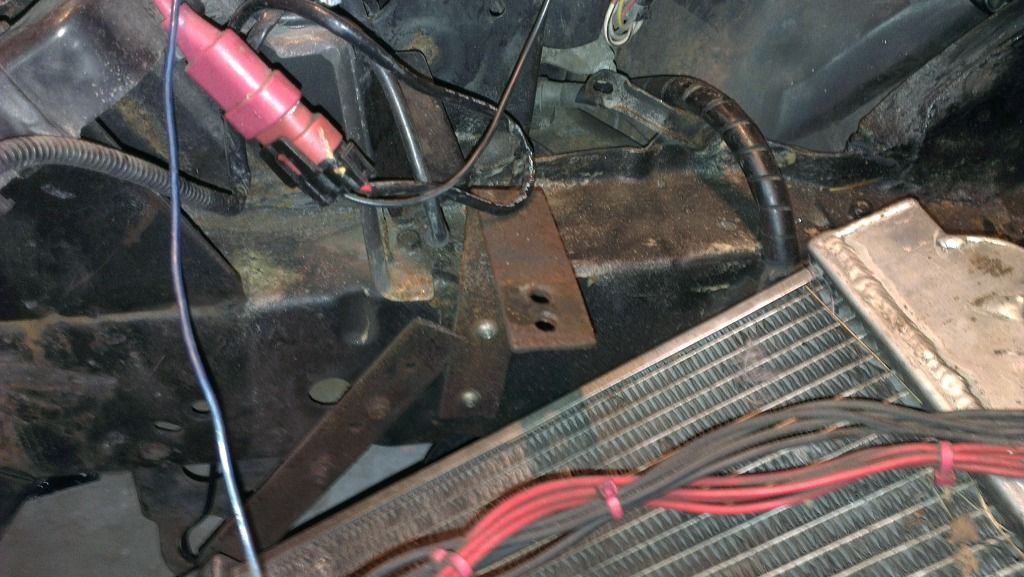

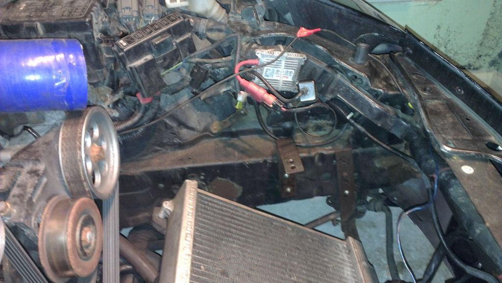

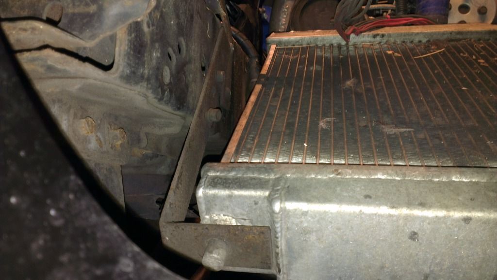

Anyway next on the list is ducting the IC and Rad and cleaning the engine bay as its filthy and it looks like the inside of a stable... However as with all jobs when I took of the IC and had a look around its opened a can of worms. Mainly there is alot of surface rust which is bugging me. I have got some hammerite left over which you can apply directly to rust, I take it its just a case of cleaning the surface (was going to use a general purpose cleaner like 'flash', anyone got any recommendations), dry it then paint over with hammerite?
Here are some pics of the car with the IC removed, I will update this thread as I progress with the cleaning and the ducting. Never done engine bay cleaning or ducting so any words of wisdom anyone has I would love to hear them!

An all purpose cleaner is fine mate but please make sure you spray some water on these and the surrounding areas to neutralise any chemicals. Once this is clean I would use a wire brush on a drill and then wipe all of the loose rust or paint away with whatever you have that won't leave much everywhere and then paint on your Hammerite. If you follow those steps, you can't really go too far wrong.
As far as cleaning your engine bay is concerned you can use the same all purpose cleaner above but diluted down by about 50% on the rubbers and plastics and once again, wipe off any excess spraying it with water. Your best bet is to buy a load of cheap microfibres and get stuck in.

Yeah be interested to know about the undertray as most people with v-mounts dont fit them.
