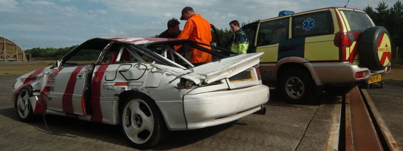

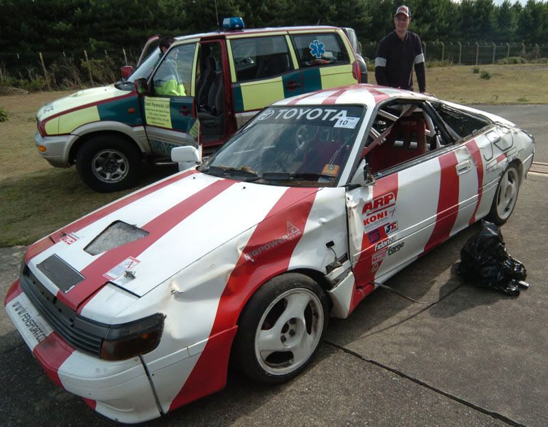

oh how the mighty have fallen! i took the car to the OC's challenge weekend in august and ended up rolling the mighty shed. she was still running but the chassis was a complete right-off. however, i still managed to drive it back to the paddock (and then from storage to the workshop to dismantle) in true rally style
today i've removed most of the ancillaries (FMIC, bumper, exhaust & downpipe, wheels, rear diff etc), tomorrow will be engine/box out and maybe the suspension if i get time.
once ive removed everything, its time to get out the PLASMA CUTTER!!!!!!!!! and chop the car into tiny bits. this will make removing the cage an absolute breeze as i can just cut the chassis up like it is made from butter
plasma cutter - the tool of champions, and those that dont fart about!
here are a few pics of its final outing...
and then in the afternoon...when it was getting REALLY FAST, disaster struck... :twisted:
the car was still running and drove almost perfectly (ok so the driver rear suspension turret wasn't attached to the chassis anymore, only the cage! but thats a minor detail)
when i return in march the plan is to prep the new shell thoroughly and then put all the good bits from this car into it
new paintscheme hasn't been decided yet, but i am tempted by a green rizla painjob.
what do you think?
