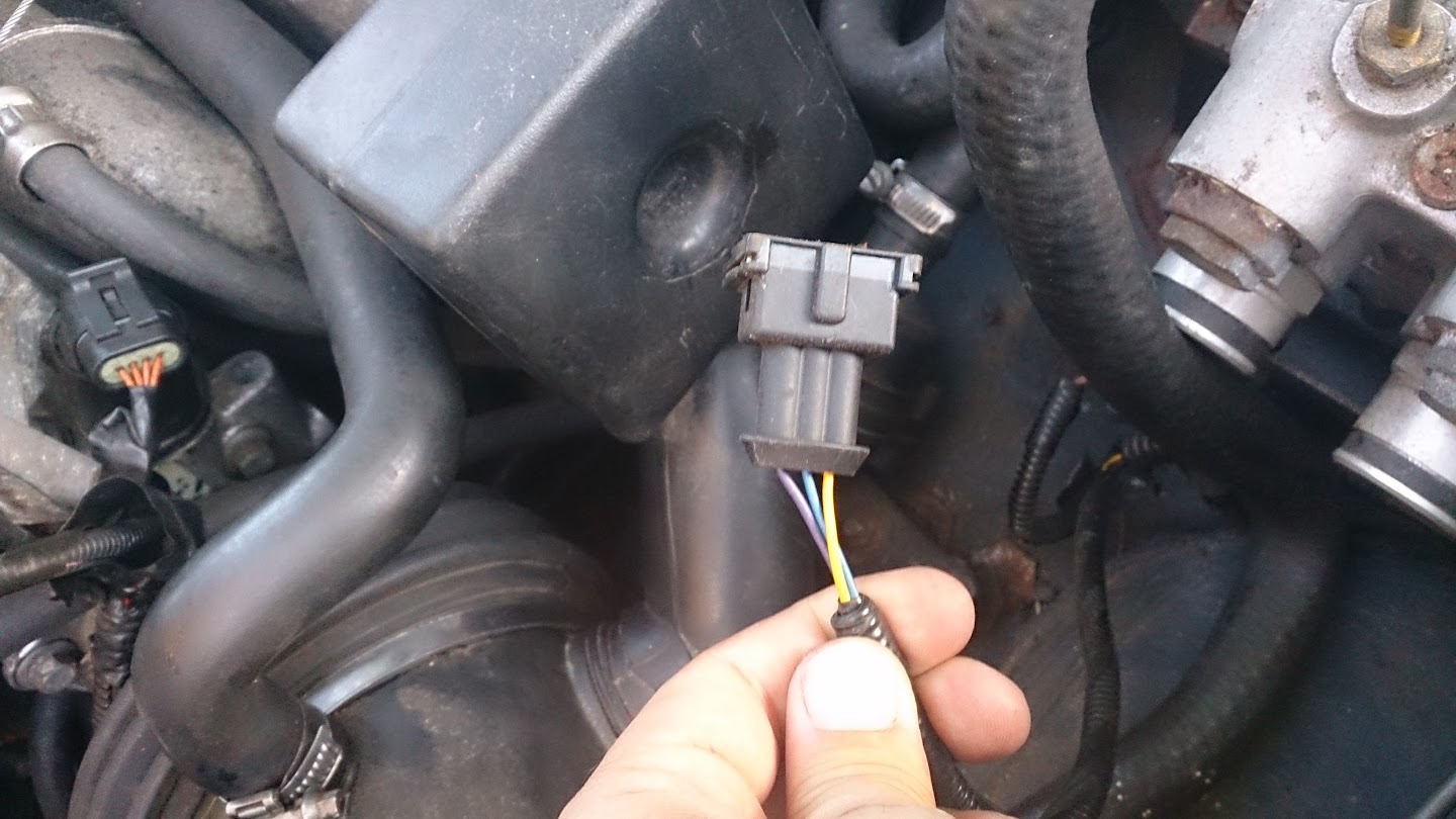

This wire (which looks to have been repaired), is not attached to anything and I cant find a single orange wire on the wiring diagram.
And this plug laying by the abs again has no home and i cant find on the wiring diagram.
