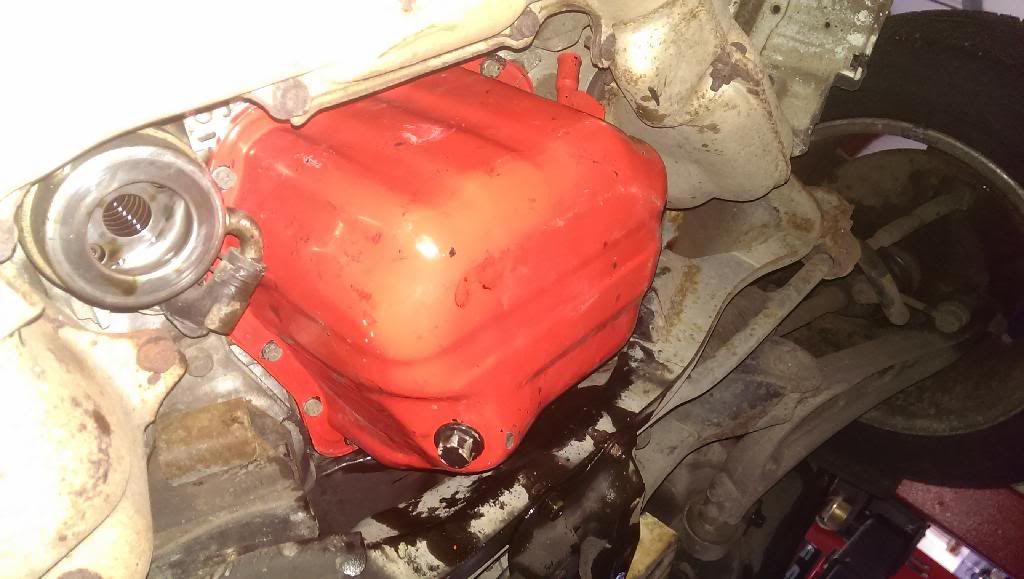

Oh and some pics of the new Sump.

Glad it's on Ben was it a bit of a git to do with the engine in for the APT guys
life rules
I looking forward to getting to grips with the dccd, I think the only weakness will be the disks and pads - can't wait.
Just got to mount up the gopro mounts so that they are solid.
No, Mike, Gary had done one before, the dipstick tube came out clean and went back in perfectly. The boys got the old sump off and new on without removing any parts - only issue was separate which was a shot auxiliary belt and the wrong one got delivered.
