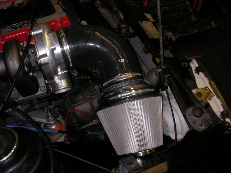

paul put the cone filter together and attached it to the turbo

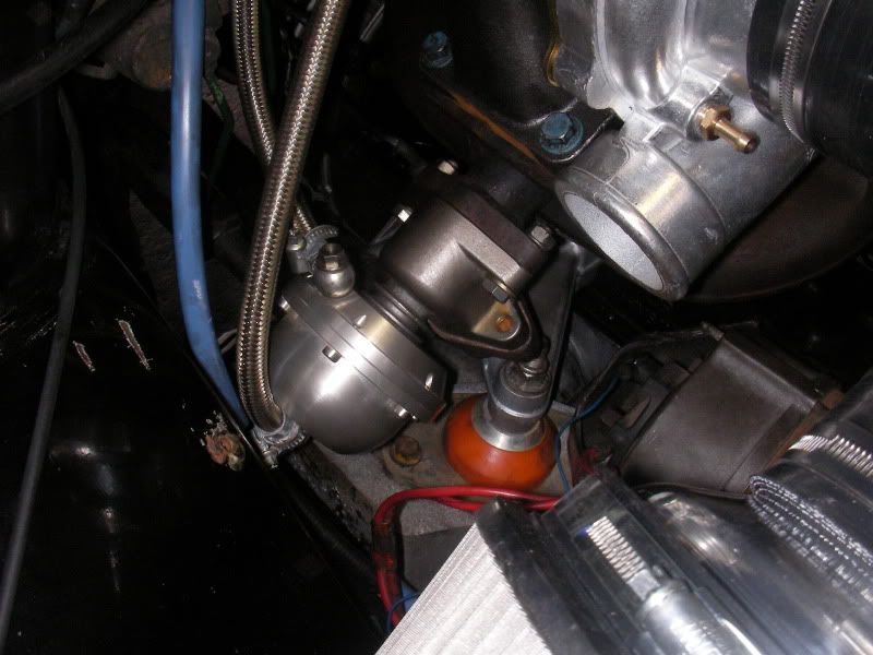

fitted the wastegate and screamer pipe onto the manifold

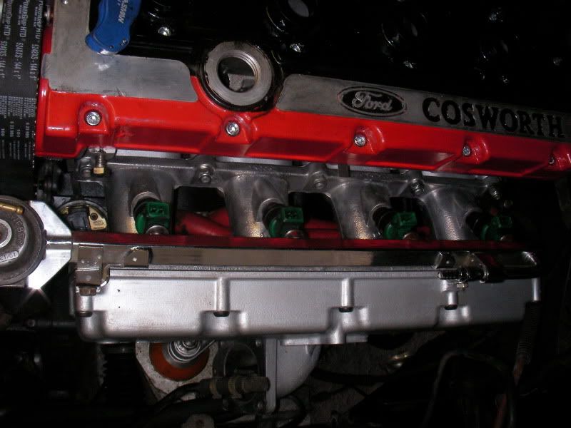

then fitted green injectors and fuel rail onto the inlet manifold
