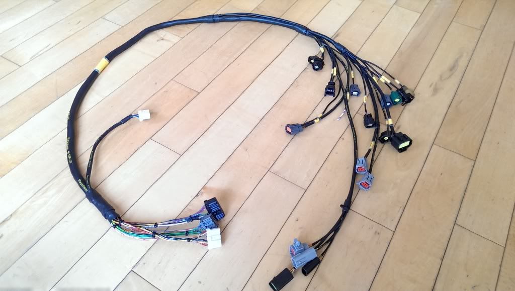

Right, an update......I did like Dom and went for one of Ed (on FDUKs) new looms for a single turbo which removes all the redundant plugs from the twins and looks a heap nicer than my 'cover them with insulating tape' approach !
To remind you guys what they looked like....
