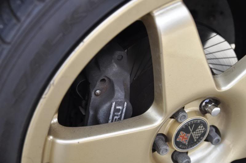

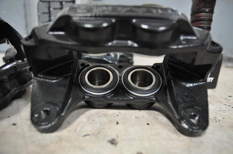

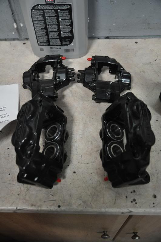

Few steps forward - Refurbished calipers from Godspeed
Before
After
However, even though I selected the disks for my model and year, what actually turned up don't fit - it would transpire that the V5 / V6 Type R share the same rear brakes with a 22b being a 290mm disk with 190mm inner ring for the handbrake - The calipers that were removed were is rather poor condition too.
It would seem that the annoying noise that I've been getting from the rear brakes is probably down to the fact the left rear caliper is jammed and the pads have come away from their mounts - doh.

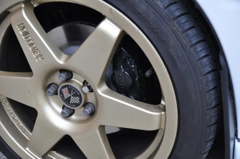

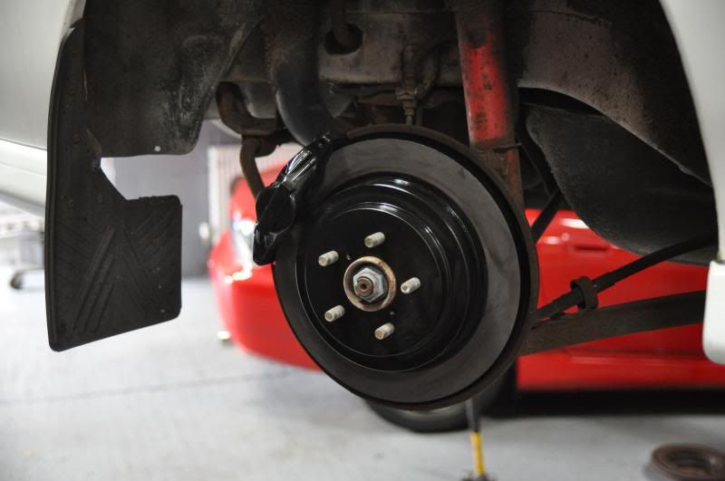

So big ole thank you to Gary & Danny for getting the car braking again, and great big thanks to Alyn for getting the rears sent so quickly!.

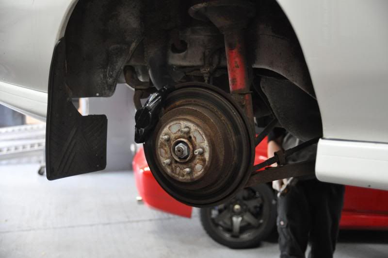

One of the rear calipers was fooked!!, no movement in it whatsover, so now safe to say I have full Type R braking.
Nasty old rusty things ....
And with the rather nicely painted discs from Alyn
