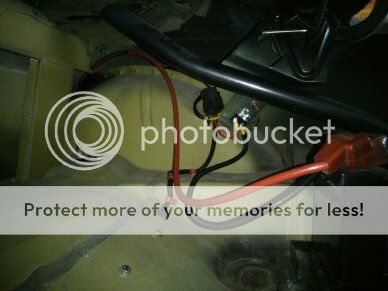

I have paided i bit more attention to the wiring than i normally do as i want to do it properly , i should do a better job of it than i usually do but iam to lazy to and one day its going to cost me . So i bought some cable conduit and have been putting the wires into that and also fixing it all with clamps , i want it to be neat instead of my usual birds nest .

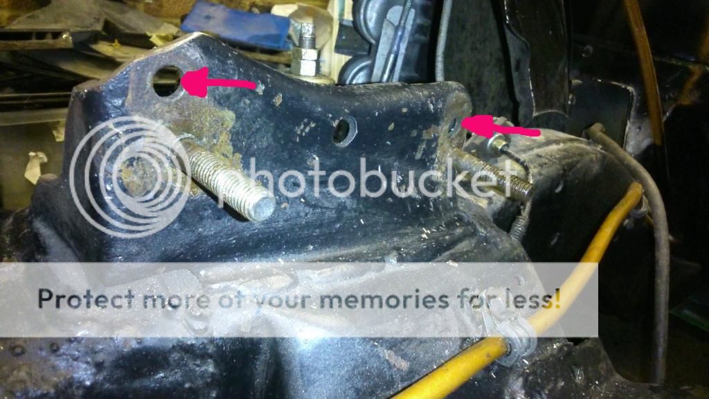

One of the first things i did was to redrill the upper control arm mounts further down and a bit rearwards ,this is a common mod that was used in the 60s. It adds a touch more castor and increases negative camber gain in compression , this pulls the top of the outside wheel in when cornering to reduce understeer .The holes arrowed are the old ones and the new ones which have the bolts in are moved quite a bit.

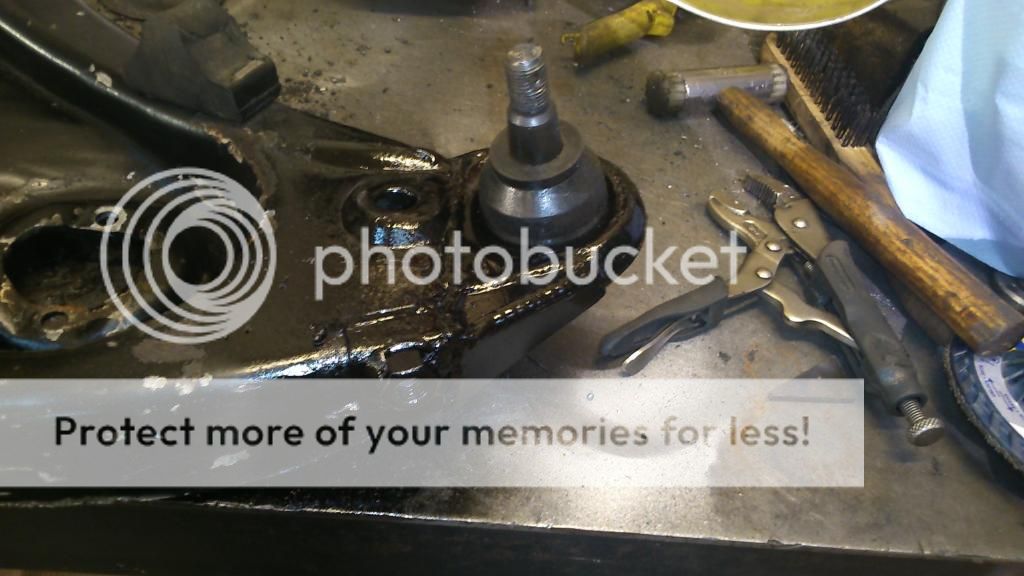

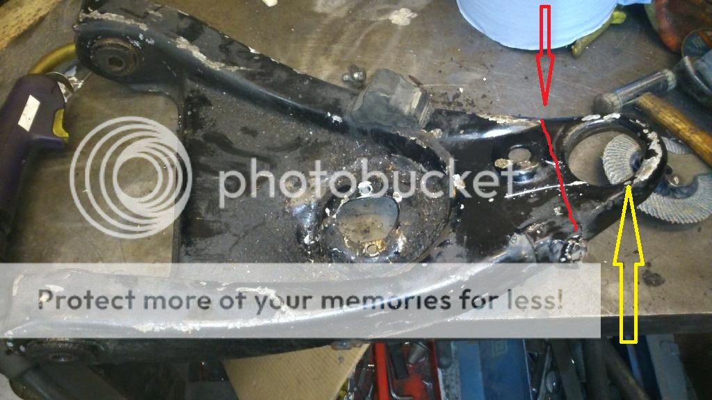

I have adjusted the upper A arm using shims to about as far as they will go , i can get up to 3.5 - camber but only 3to4 deg extra caster . The factory set for castor is actually 0 so i want it to be at 5 and start from there . The other problem with adjusting the A arm to far for the castor is that it pushes the wheel back into the inner arch . So what i have done is the move the lower ball joint further forward by cutting its mount off and rewelding it further forward as indicated by the arrows , there is more space to push the bottom one foward than the top back .
I have moved the mount 20mm fowards which is about 5 deg in extra castor angle .

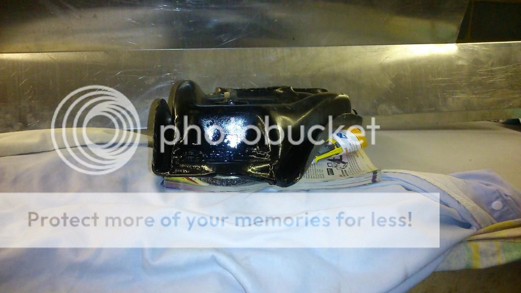

Then welded it fully add gave it then usual blow over with a can of black paint

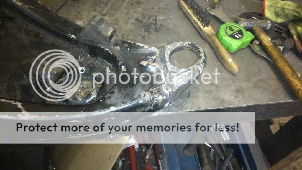

This seemed to work great when i refitted the arms and with some steering lock the wheel gained some negative camber . the only problem was that the upper ball joints started to bind with the extra angle , so they had to be cut and rewelded .
As you can see the upper ball joint mount is angled reawards as it is so more angle on the joint means it binds

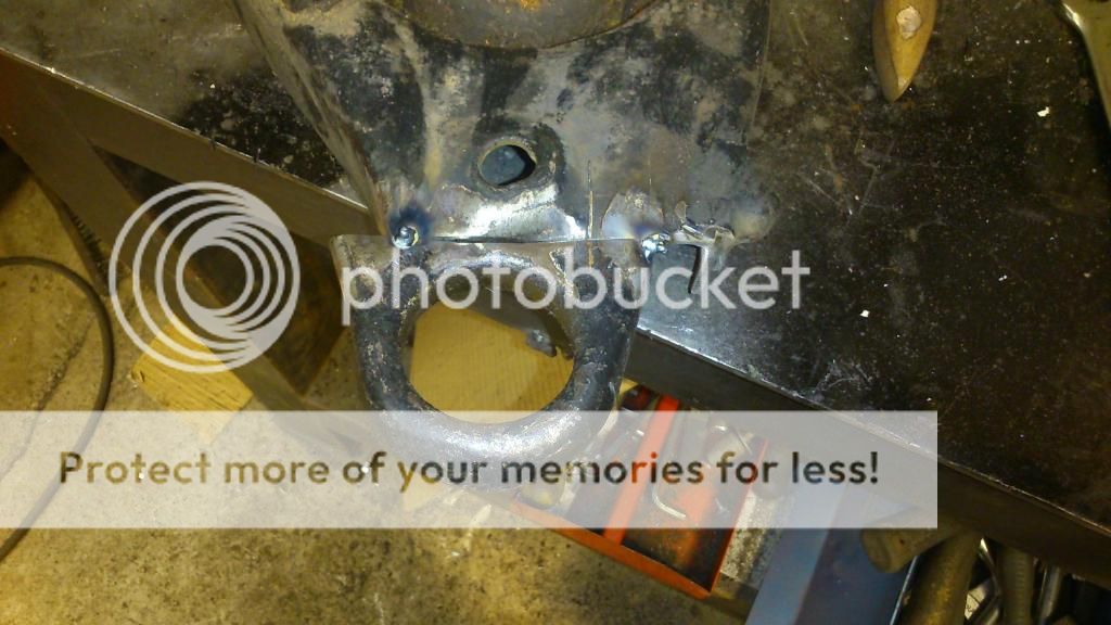

This is after i reworked it and the mounting surface is now level and the ball joint has more travel , not that clear on the picture ,

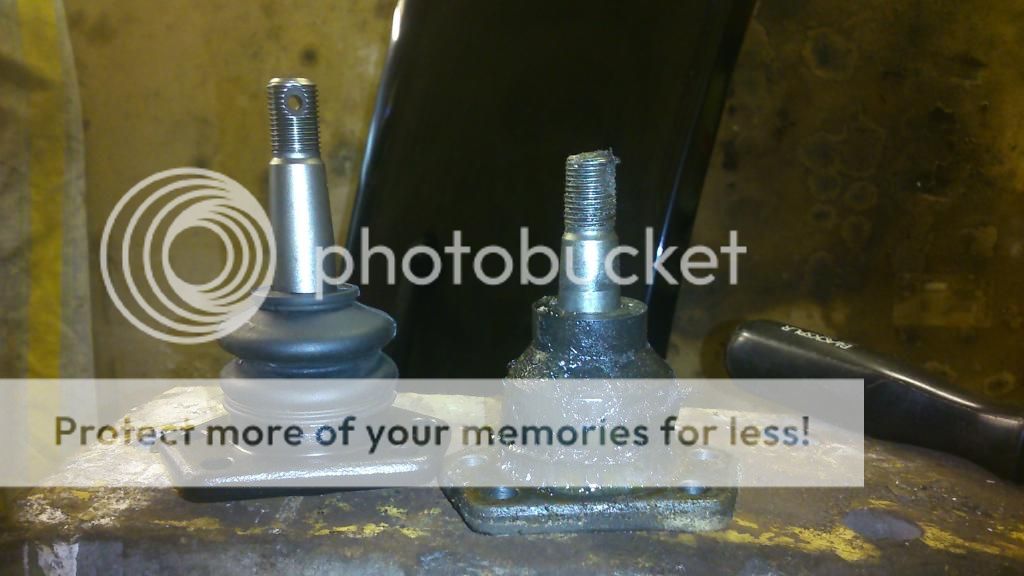

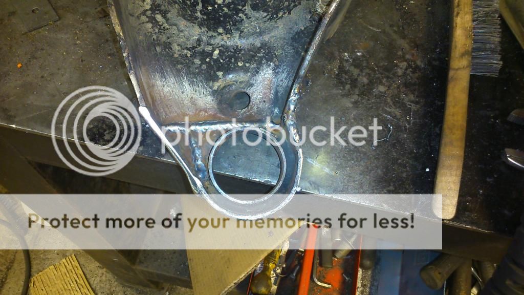

I have also added some taller upper ball joints because this helps the suspension gain negative camber
