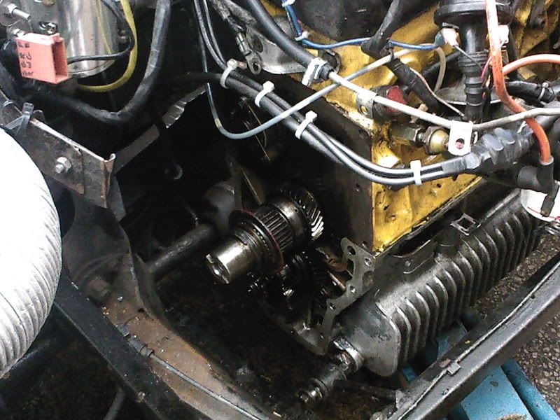

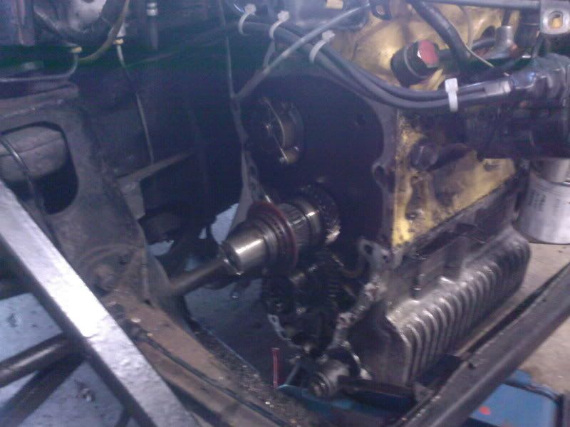

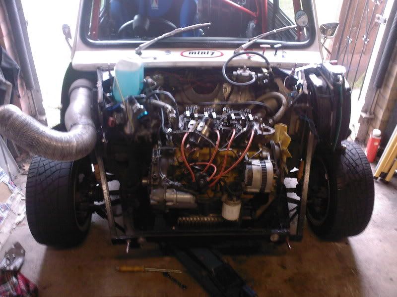

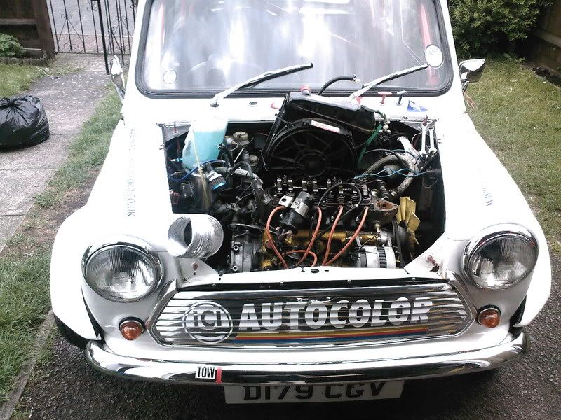

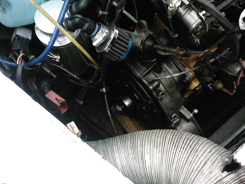

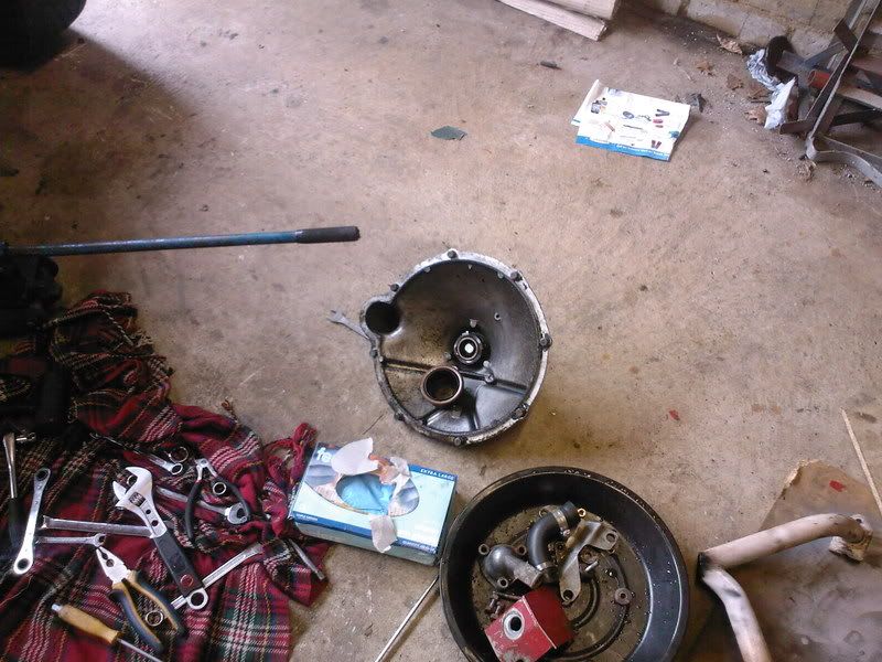

during the week i heard my exhaust blowing like mad and coupled with the fact that i'm going through a litre of oil every 2 days meant that it was time to take the belhousing cover off and replace the gasket.
here's my days progress in photos :) 9:30am - 12:00pm
oh dear.
nice eh!

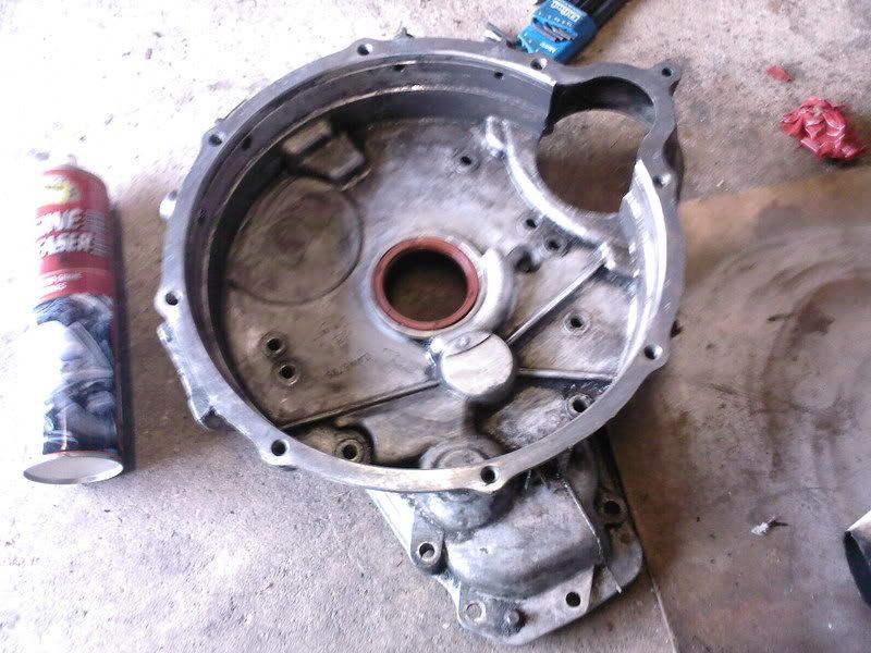

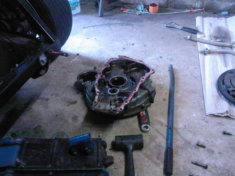

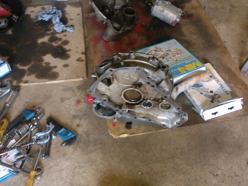

started off by scraping the old gasket off and sanding the mating faces smooth with 400 grit paper;

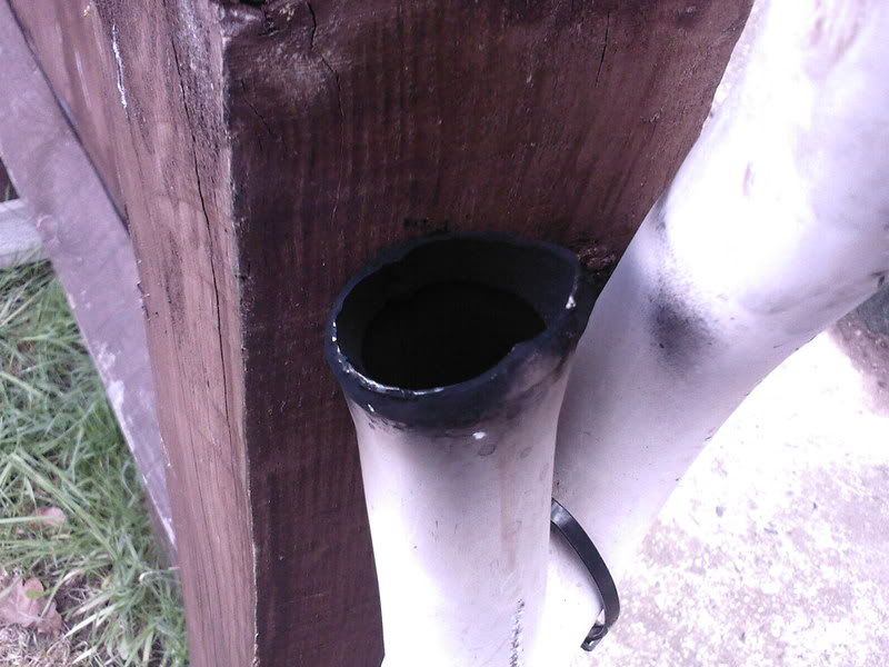

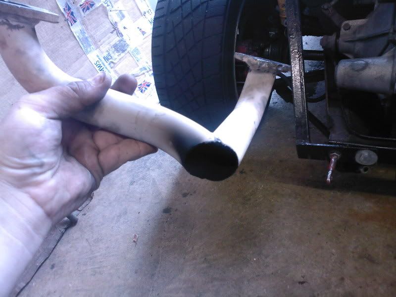

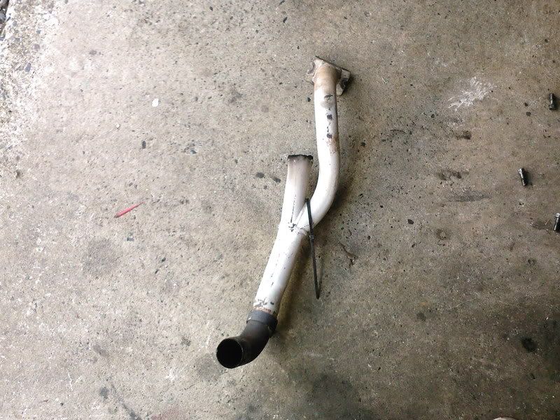

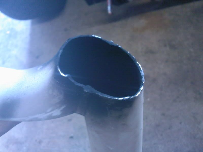

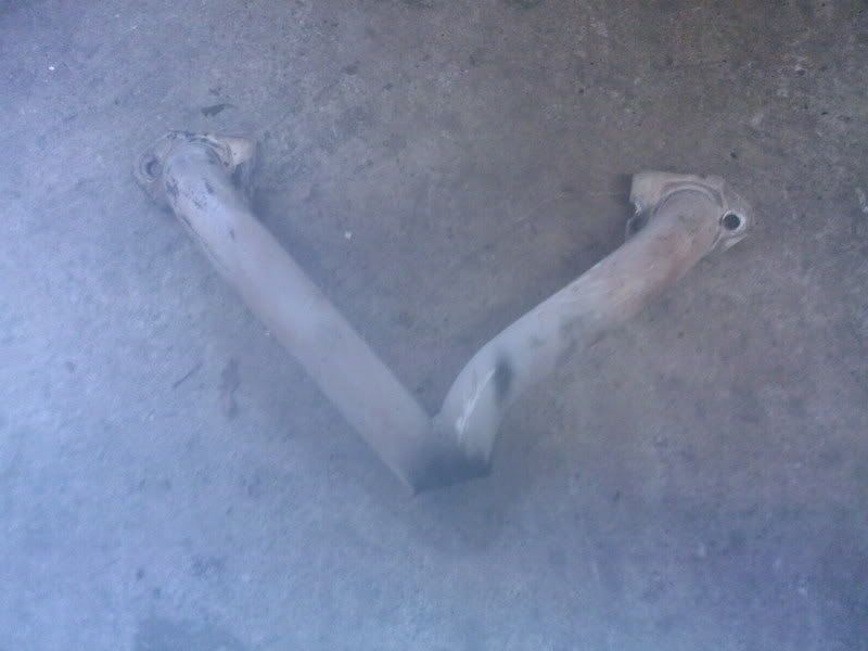

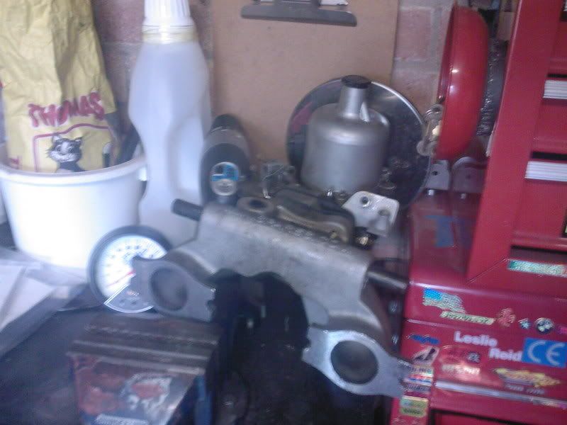

ther half of my three branch;
not going to bother welding that up, just going to buy another one.
the local three legged cat;

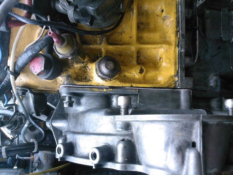

mating face nice and smooth;
bellhousing on with new gasket;

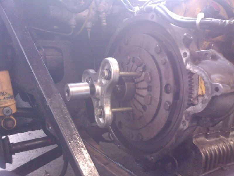

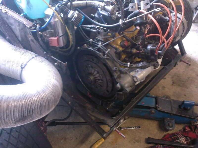

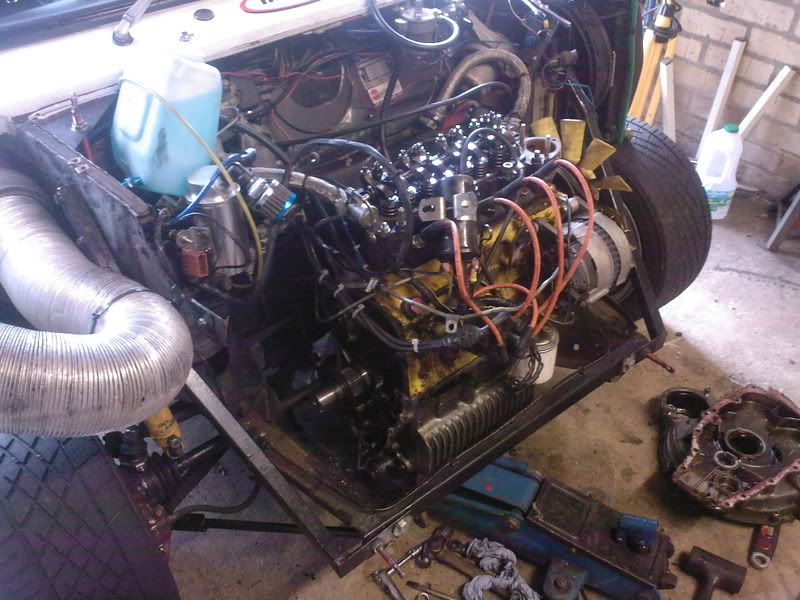

Clutch/Flywheel assembly on, but there's a problem with the tabbed bolt :roll: ;
and it was time to pack up because we had to do some other jobs;

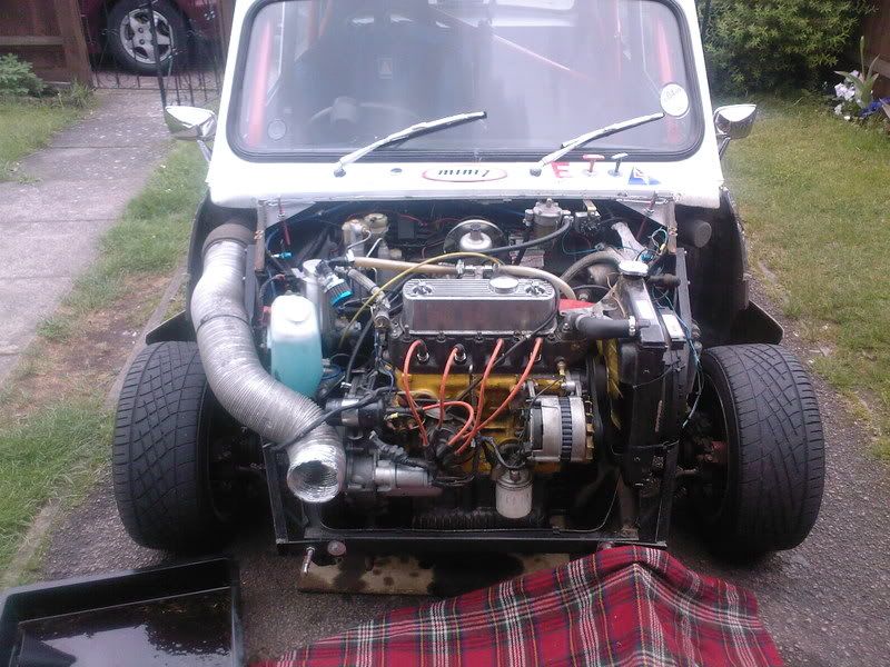

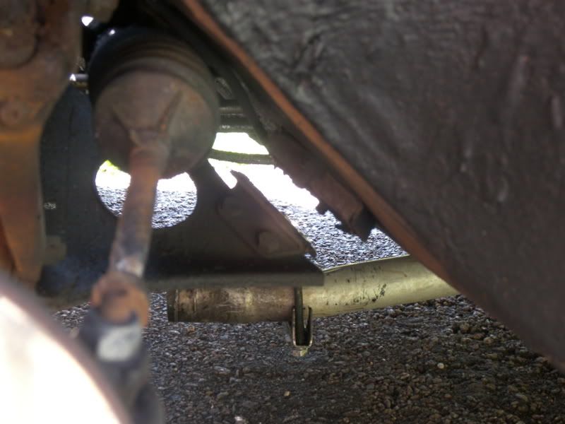

well, since being back from holiday i've got a big f##k all done :x and today just made things worse, i noticed before taking the engine apart that the front of the car was pitching and diving a fair bit, so i decided to have a look underneath to see what the problem was...
and here it is;
both floor pan subframe mounts have snapped :evil:
so not only have i got to re tap the crankshaft, but i've got to get these mounts done too.
