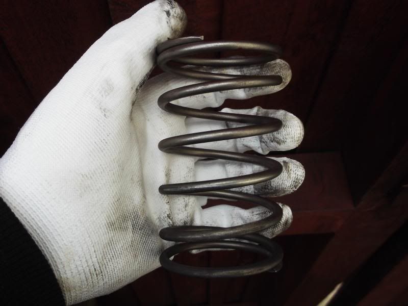

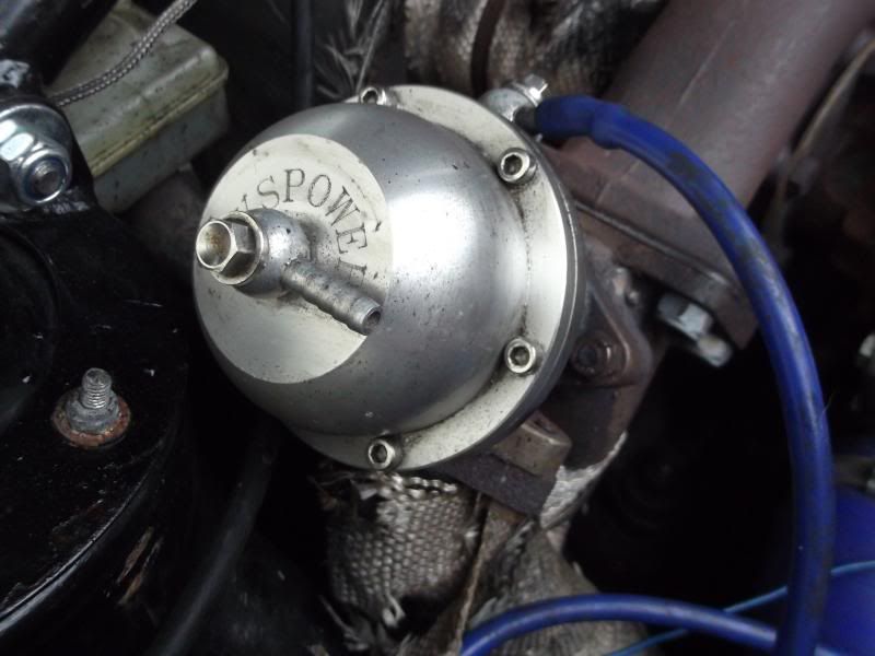

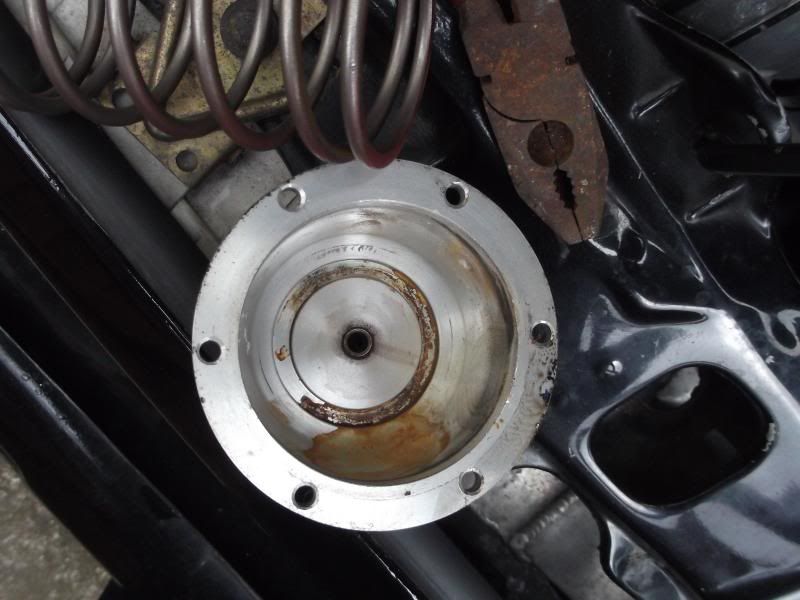

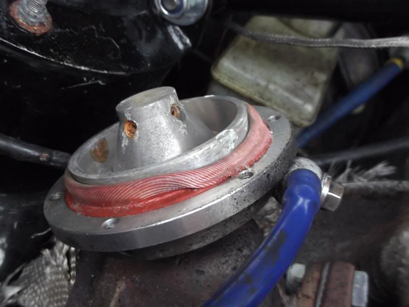

No mate, the wastegate size is determined by the diameter of the valve itself, I believe. The Tial/Precision gates we use supply a number of springs of differing diameters which are combined to achieve the desired opening pressure.Bart wrote:just a thought and I may sound stupid here but this is a 60mm diameter spring
does this mean its a 60mm wastegate?

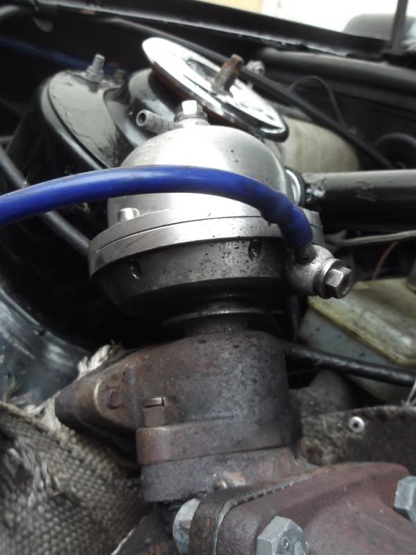

Turbo is a GT3076. The only thing we DON'T know is what pressure of spring is in the wastegate.
