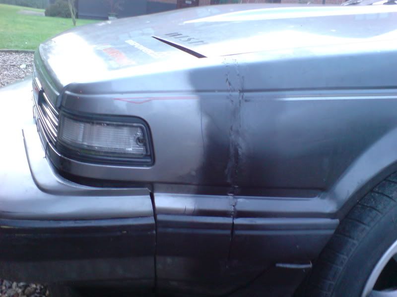

Went to scrapyard to pull some bits off another S12 as heard they had one down there, went to get a wing as ours is very rusty and looks tatty, the one at the scarpyard was solid but had a front end impact! :x
So i just cut them in half and made a good solid wing out of two!
Picture of it back on the car!

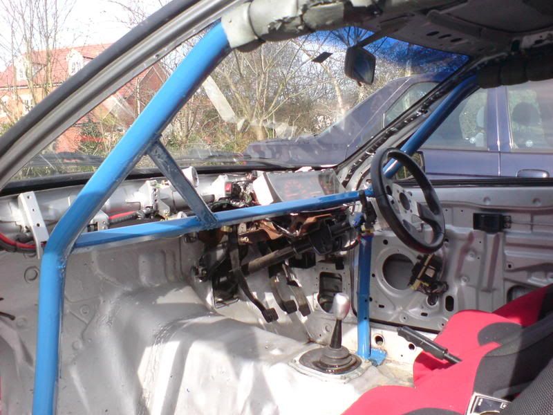

Ian seem even better than we thought from what i can make out its a six point cage.
:wink:

Does it look like it bolts in then?
IWANT1
Posts: 2832
Location: cambridgeish
Post by IWANT1 »
Looks like it bolts on to the inner wheel arch.
The rear part slips into camps on the hoop that
would be best welded once fitted i guess.
Hoop has plates fitted ready to bolt in.
The front section is made up from the extra tubing
that just needs some floor plates making up and
welding to the hoop. You might need one length of
tube for across the screen and jobs a gooden.
Like rocking horse #### i guess nik........

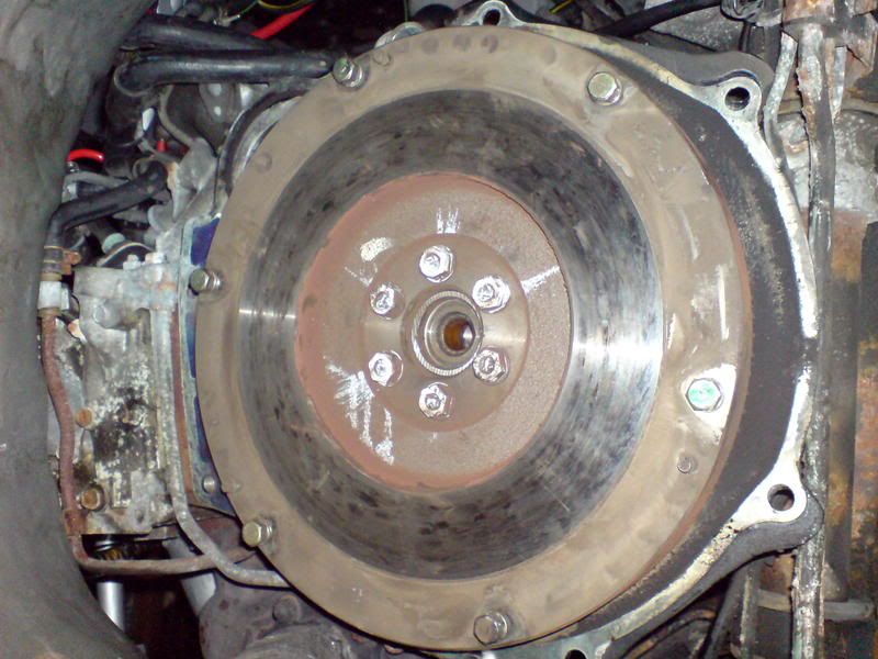

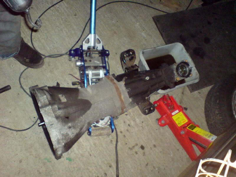

First job was replaceing the tired clutch which was in the car so we went for a Exedy organic unit.
I vowed i would never do another clutch on a garage floor but somehow found myself doing it again!!
No action pics here as couldnt hold camera and gear box at same time!
That large oil leak on the box was solved with a new gaitor from Nissan.

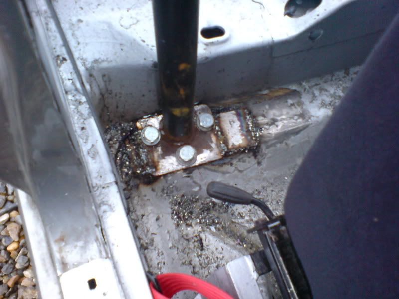

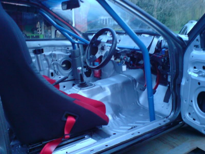

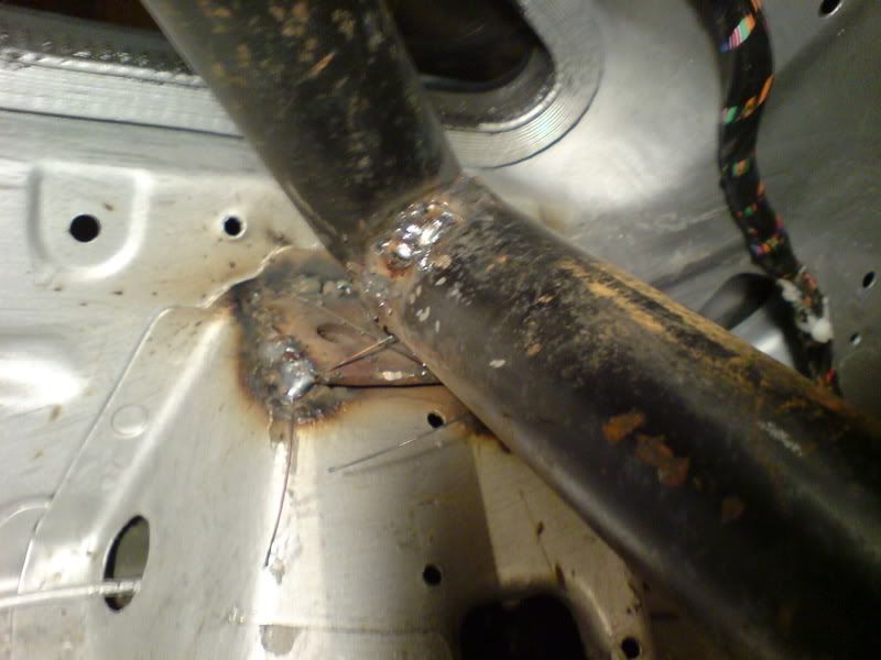

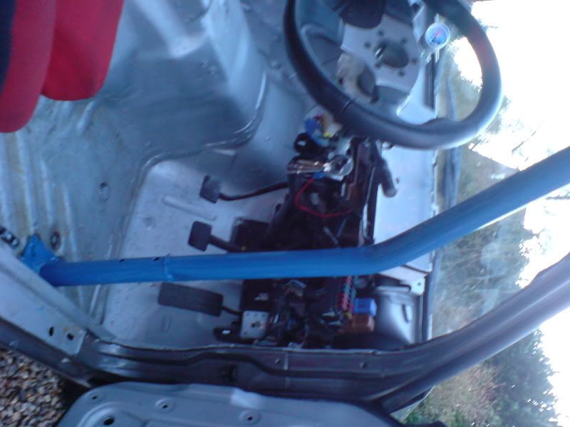

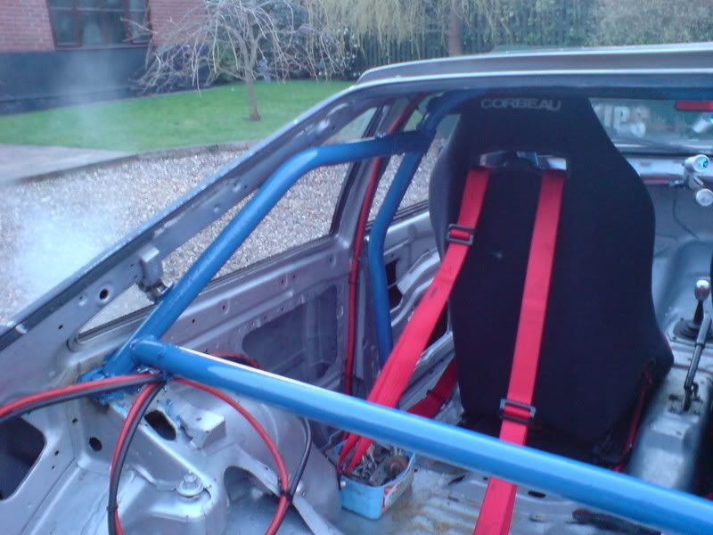

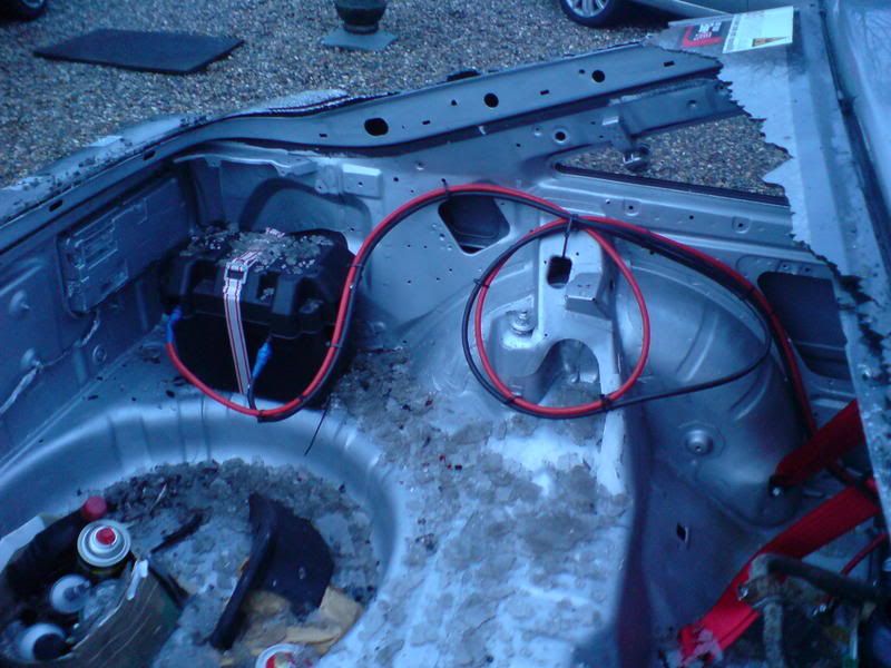

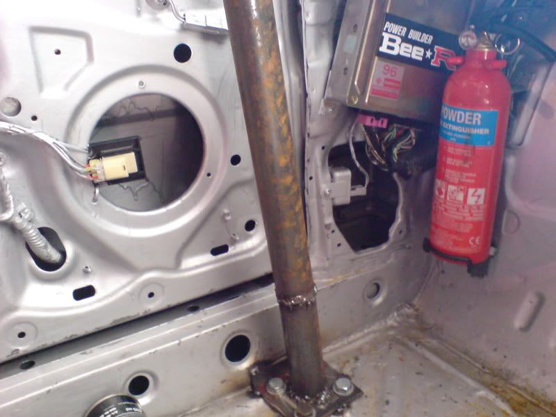

Next we moved onto the cage that Lee found for us (cheers again mate);
This turned out to be a huge operation for myself and i fully respect the guys like Gary etc who have built a proper cage set up and not a budget one like mine. Trouble with the cage was that it was not trully built for the S12 so needed quite a bit of modding to make it fit. Anyway here are some pics;
Add a lick of paint and some padding;
