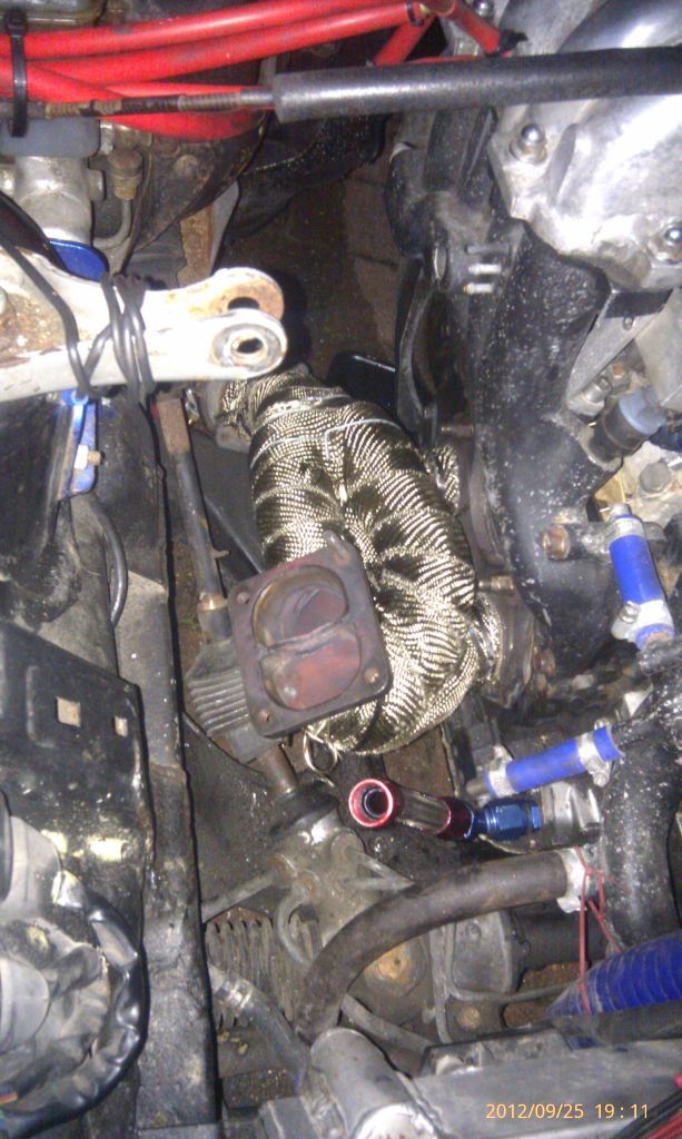

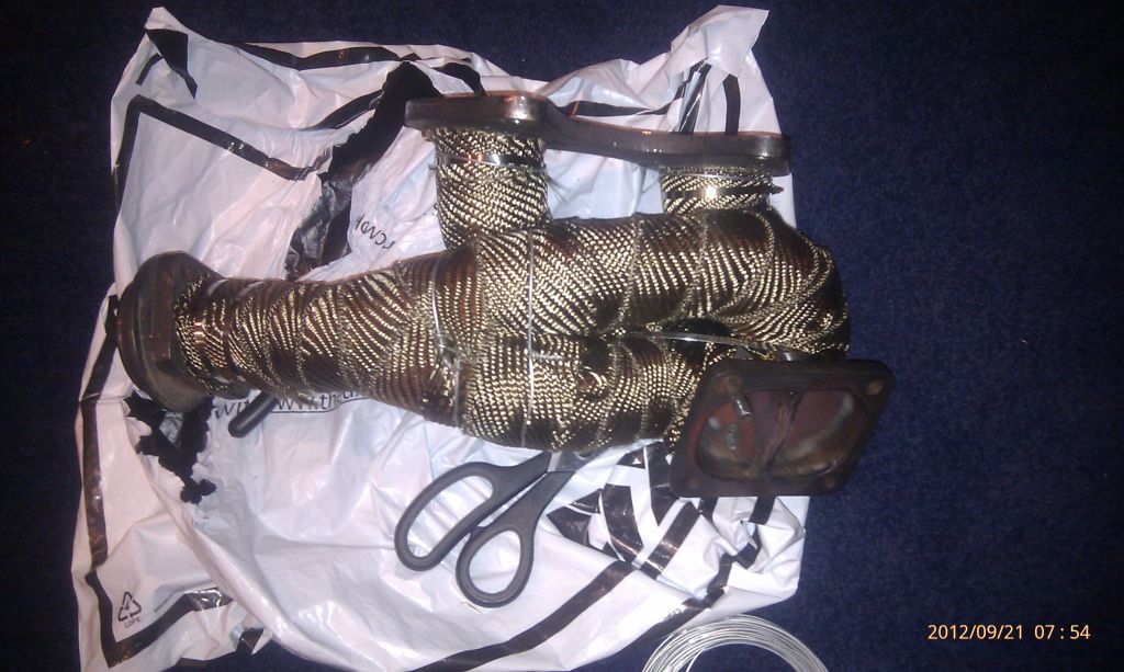

Right got the mani skimmed and re wrapped. Now back on the car..
Next step, get the turbo back on! I need to clean up the V band for this, also I am thinking while I have got the turbo off replacing the oil return line. I had to replace the oil feed line when I got the car due to the rubber within it cracking and causing it to leak. I was recommended http://www.pirtek.co.uk/ by Gary @ APT for getting these lines made up, the feed line pirtek made up for the feed is far superior to what was on there so a big thumbs up for pirtek from me as well.

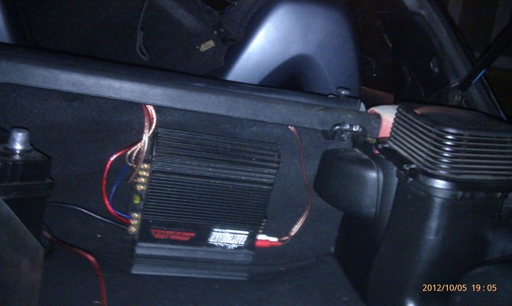

When I bought the car it came with the bose system in the boot but it wasent rigged up, I dug out an old amp and wired it up the other day as well so I will have a system that doesnt sound like someones mobile playing music!

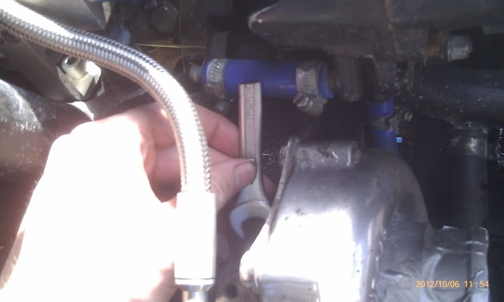

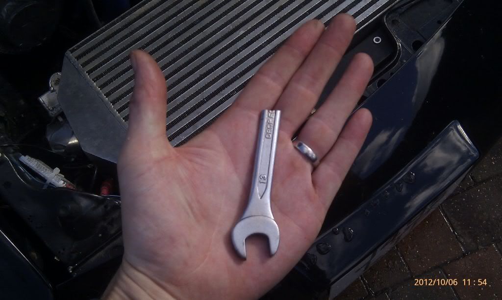

Got the turbo and manifold all tightened up... Things were abit tight to say the least I had to start modding some of my old tools...

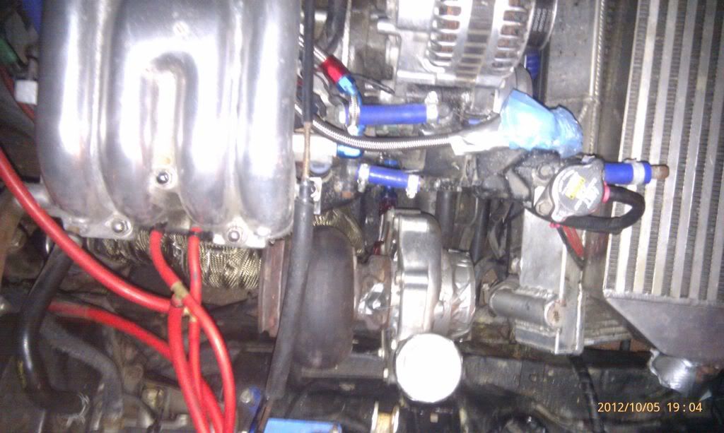

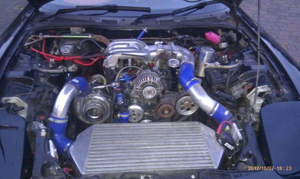

Got the v band and downpipe all fitted and filled the car up with coolant and put all the IC hoses back on, which left me with...
Got all excited and ready to start the car and the battery is flat, doh! So thats on charge and tomorrow night I will be starting the car for the first time since doing all this work, once shes running bleed the coolant system. Slightly scared and just racking my brain to think if there is anything I have forgotten!

Nice modded tool skills.

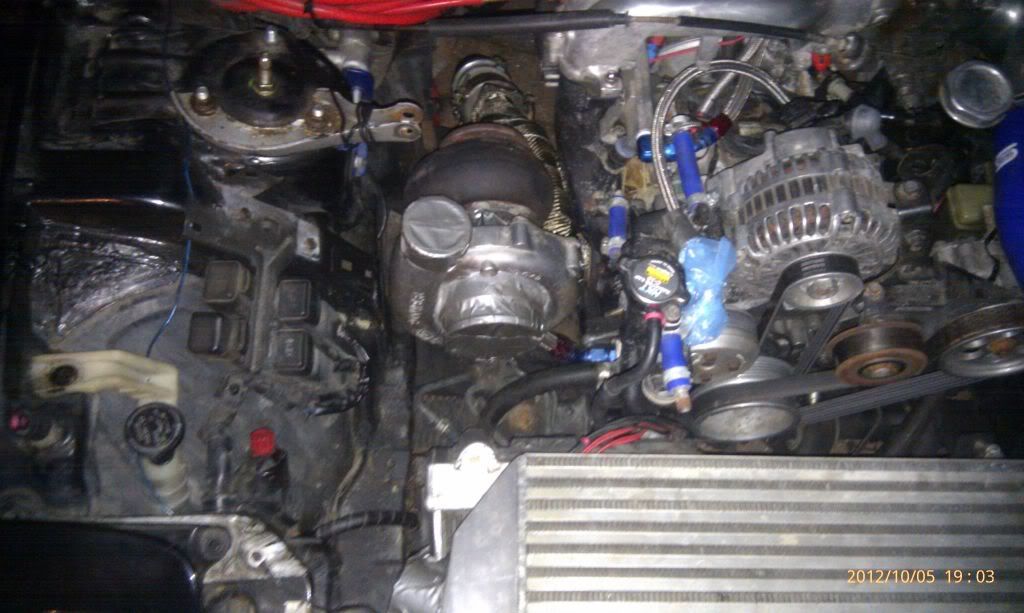

What drain is that by the turbo ?
Hehe hand bags at dawn gents!
Which picture you referring to Gareth?
In the second pic the two blue hoses are coolant stub hoses which just close off coolant passages which are not in use anymore, the black one is coolant related but I am not sure where it goes.
