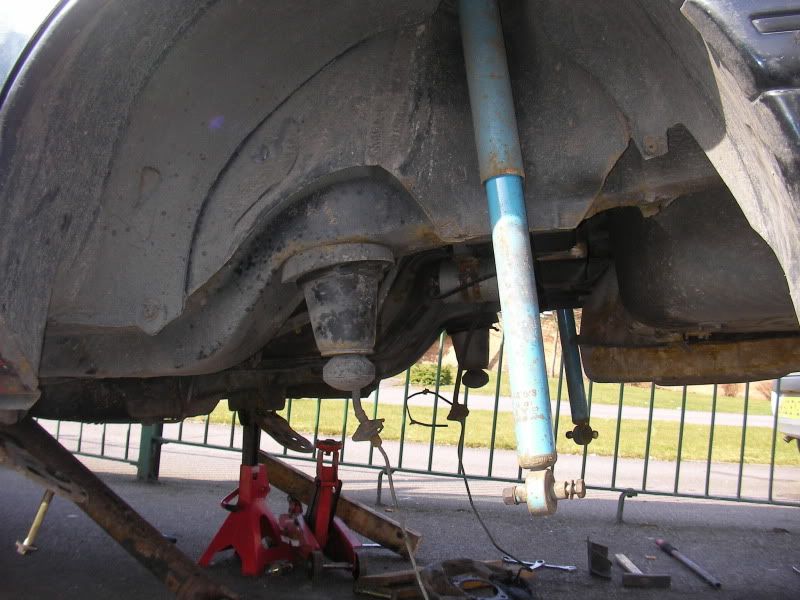

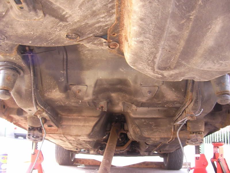

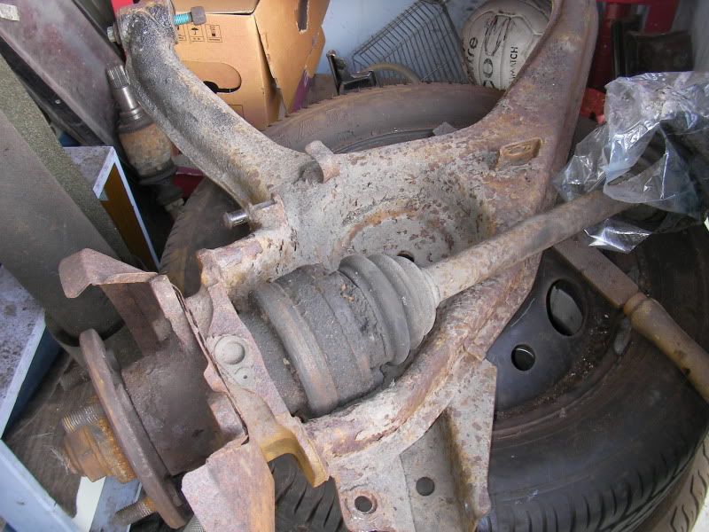

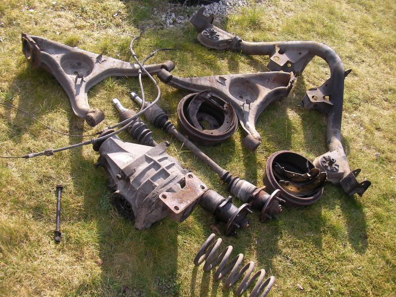

after 2 hours work this is were i had got upto

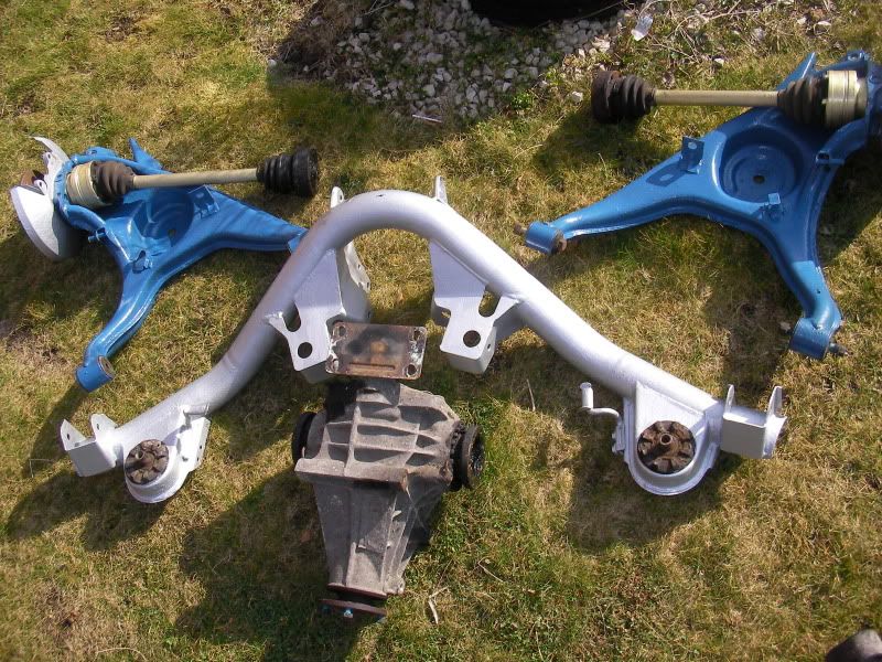

all the beam off and the slip diff that i believe is the route of my problems

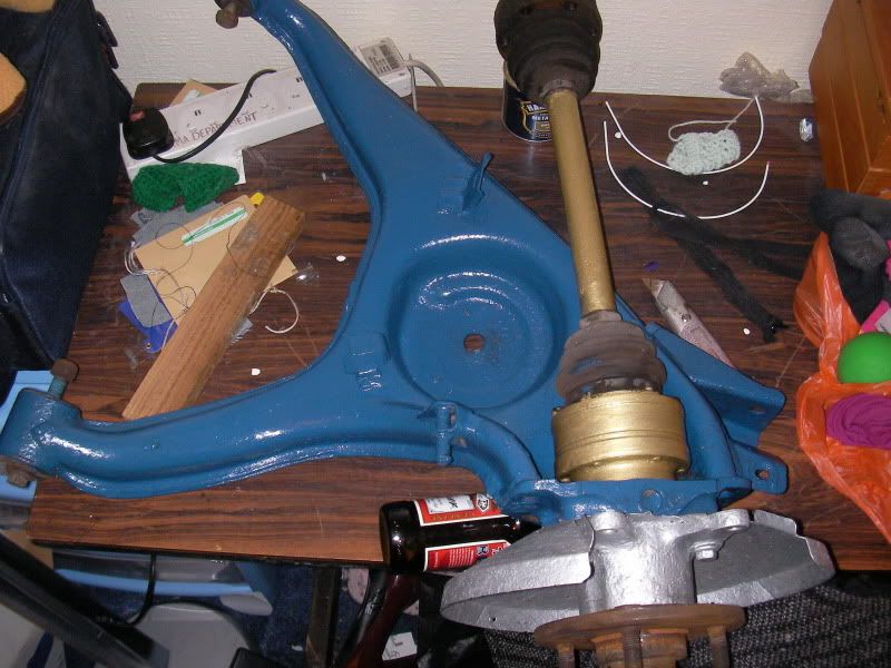

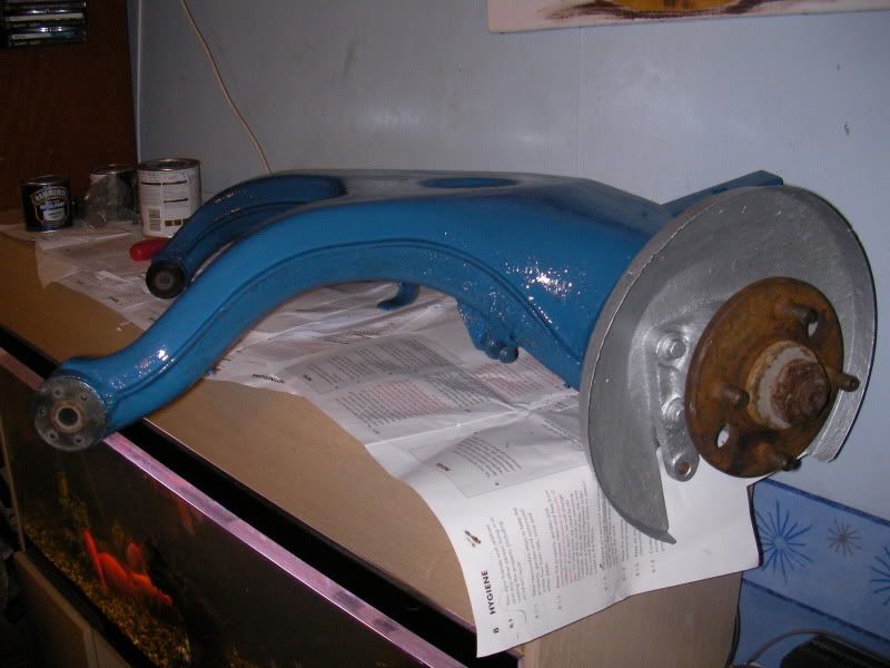

new beam to go on with a limited slip diff

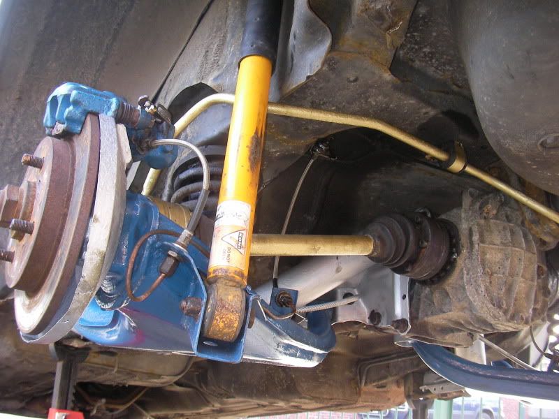

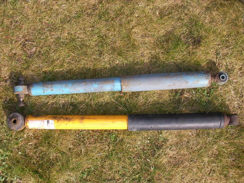

Also changed standard shocks for koni top mount ajustables

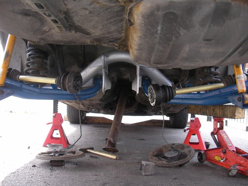

beam and shocks fitted
discs, calapers, brake pipes and diff all fitted

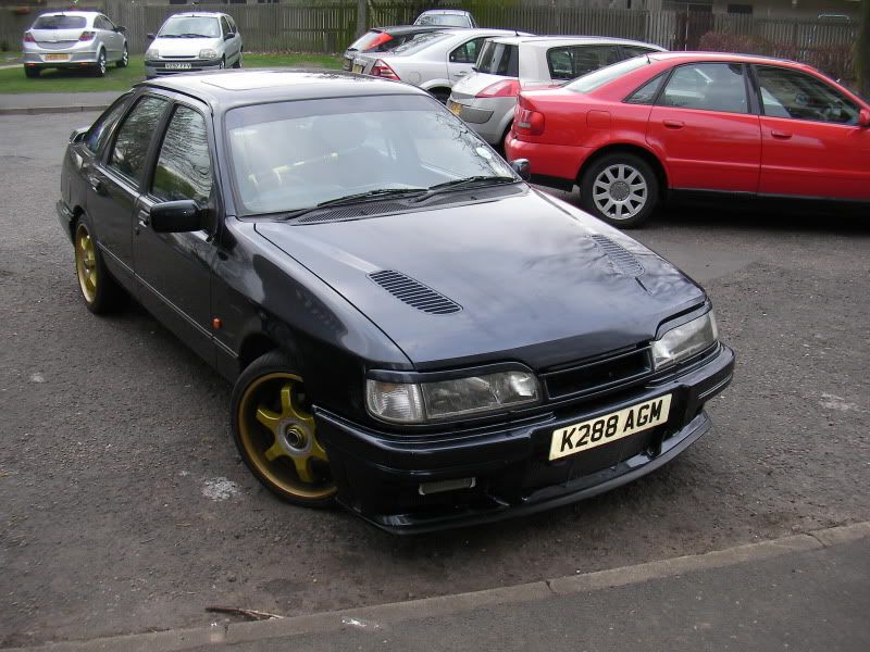

after dropping the car to the floor the high of the car was way to high for my liking so replaced the standard springs with escort cosworth lowering springs and it has dropped the hight.
