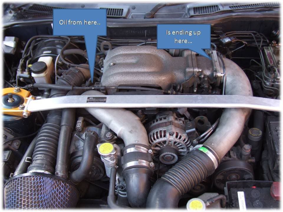

Hey Guys,
As some people will have seen, I found an oil leak in the engine bay at the end of my second session at Snetterton on Wednesday. the leak was near the oil filter which on an FD is below the throttle body.
Turns out the oil is coming from the oil seals on the turbos :( and making it's way all through the intercooler etc until it leaks out of the join between the inlet elbow and the throttle body.
As soon as I took off the elbow (to look for leaks on the sandwich plate for the oil temp gauge :roll: ) and saw the amount of oil in the pipe I knew to fear the worst...
So after a discussion with Andrew at Jimmy's yesterday and him having had a look today I'm faced with the following main choices (loads of permutations obviously):
1. New/2nd hand turbo pack plus labour to remove engine, replace turbos, refit engine - approx

3 is appealing from a cost point of view but the turbo pack is a total nightmare to get to if it's still on the car and some of the bolts will be practically welded in!
Currently I'm leaning towards option 1 as although the engine will have to be out again probably next year it seems the best combination of time/cost/hassle if I can get hold of a turbo pack cheap and hand it over to Jimmy's for fitting. Once the wedding's out of the way next year I'll be more receptive to a
