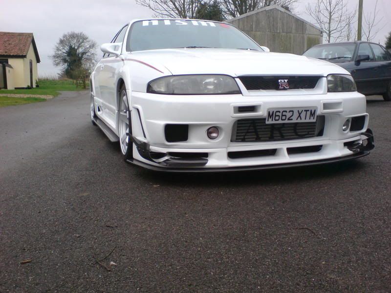

OK finally got around to fitting the splitter on the car aswell now, i hope i have won around all the people that were not to sure when i first put the canards on and i hope this brings the whole package together.

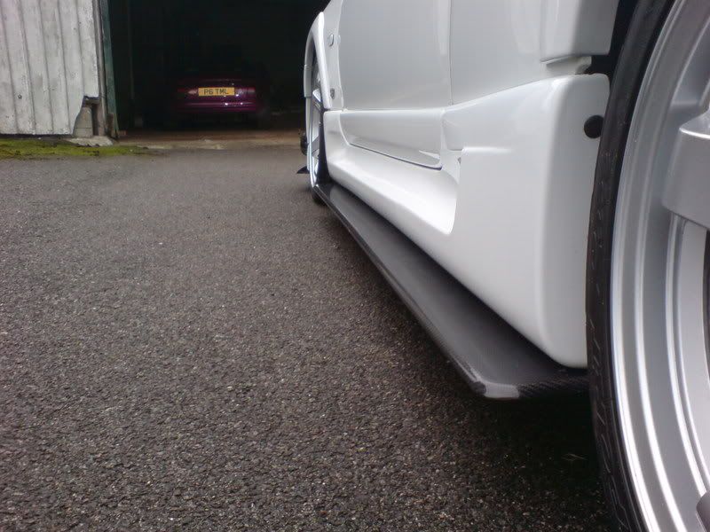

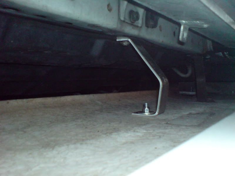

First job putting the splitter on was to reinforce my original Nismo bumper so it does not get damaged by either the extra downforce or more than likely getting caught on the road by the lower splitter so i made a set of brackets up for it, i also did this when i put the skirts on.

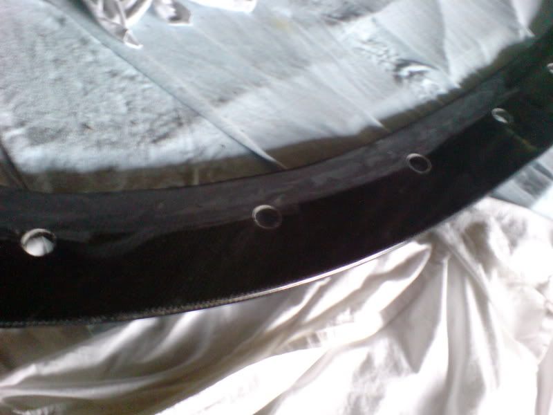

I then measured all where the original splitter bolts on and cut through the new carbon splitter so it will allow me to take apart the bumper without unbolting too many things! I am glad i did this now as to get to some of the bolts to put the carbon splitter on i had to have 3 spanners taped together with a nut taped in one end!

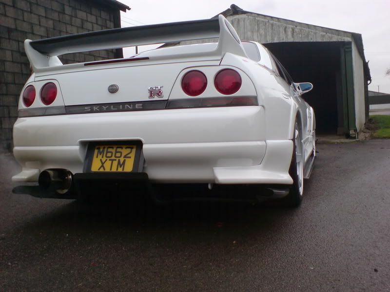

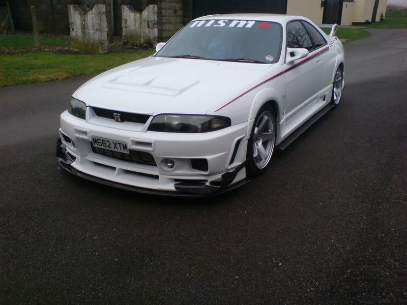

Here is a few pictures of it all on the car, i would like to hear some feedback again as to what you all think?

Nice job Ian,
It all matches nicely now. Just mind those ankles on the edges
