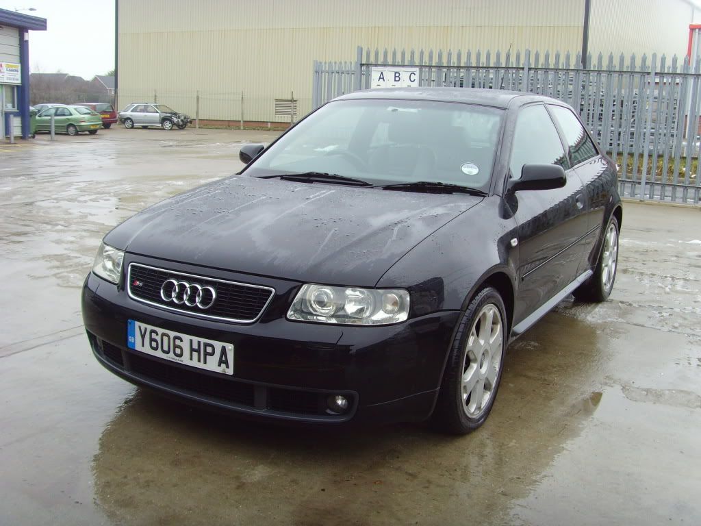

as some of you may know i got rid of the rattle can that was my CRX SiR and replace it with a subtle little audi S3
now I promised myself i wouldnt tinker with it to much, the car is an everyday car that i want to keep civilised
all i wanted to do was possibly 'stage 1' it:thumbs:
this is now all but complete as from today

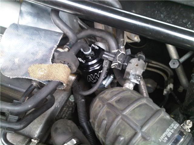

- KN Panel Filter

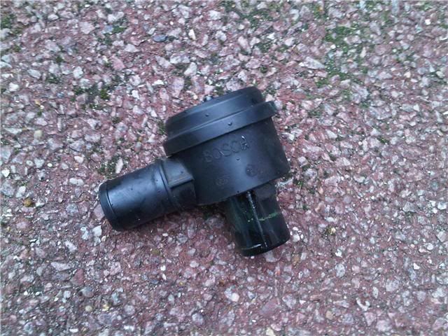

- Forge re-circ DV(stronger then the limp bosch plastic one)
- Jabba Motorsport Remap

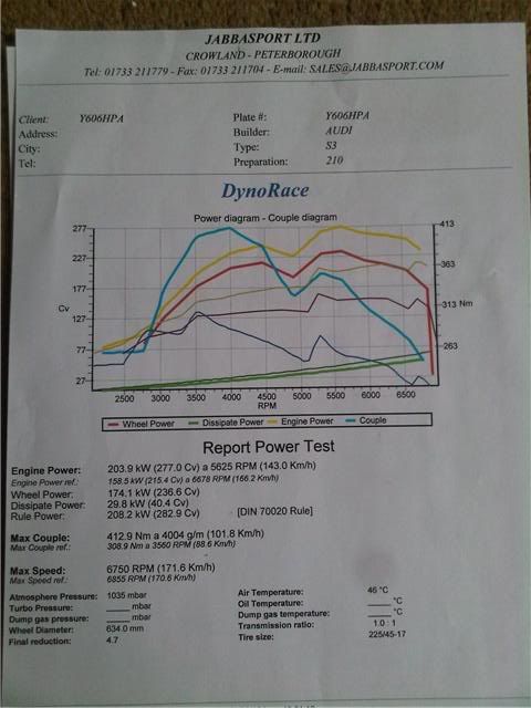

The car came in with 210bhp and left with just under 270bhp!!!:sifone: and on supermarket super unleaded too, was informed it would perform even better on Shell V power
obviously figures arent the be all and end all...its how it drives on the road..and what a difference, to say im chuffed and impressed is an understatement! its like driving a different car, it pulls hard all the way through the rev range be it half throttle or full throttle
below are a couple of pics, including the dyno print out, will scan it when i get a chance
the graph shows a small amount of wheel spin(due to my pants tyres) this is shown on the graph when the power dips(haldex is pushing the power to the rear) the technition assured me that with better rubber this will not happen and the graph would have been smoother, and on the road the power delivery will be even and constant...he wasn't wrong:thumbs:

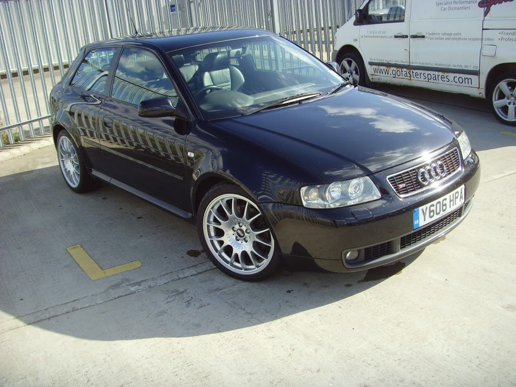

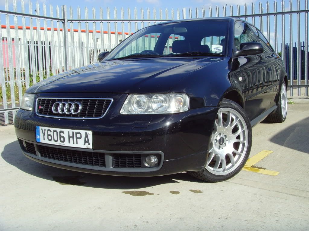

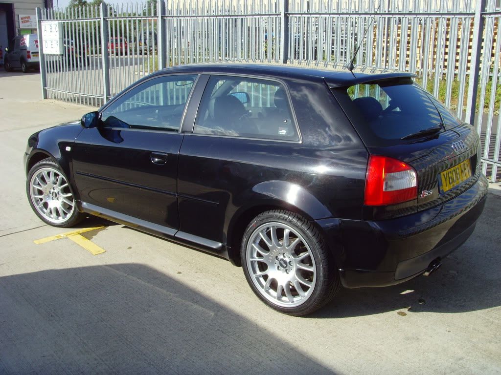

only other possible mods are

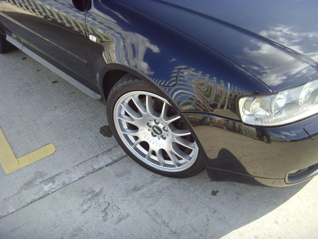

- New alloys and tyres(probably RS4's or BBS CH's with decent tyres)
- miltek exhaust
IN WITH THE NEW
DYNO PRINT OUT
203kw - 270bhp
412nm - 300ft/lb
