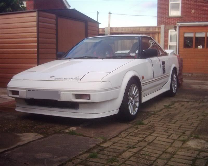

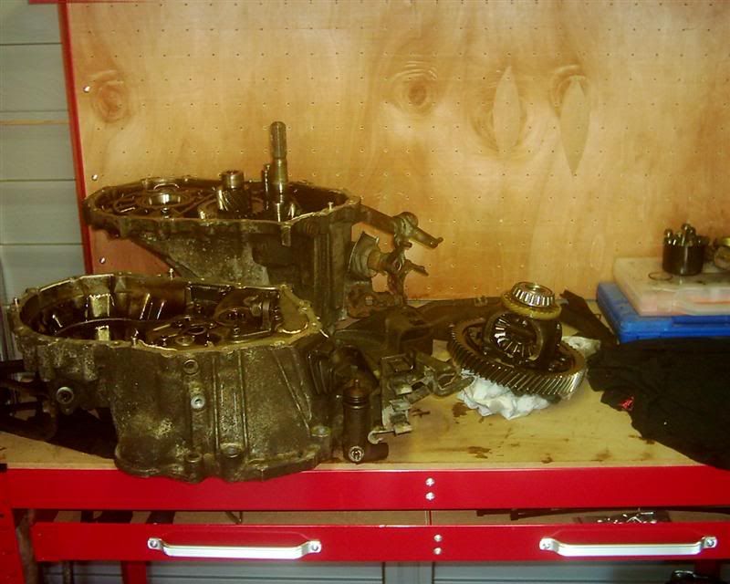

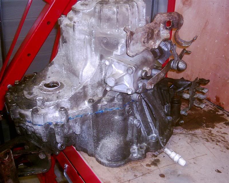

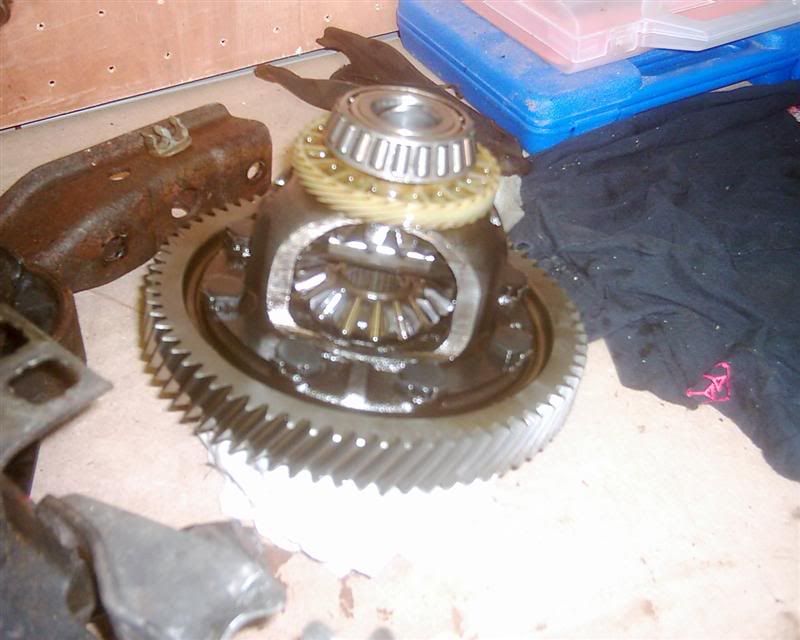

Bought used transaxle from scrappy as before i even saw the car i was eventually going to buy i knew it needed the diff either welding or a good 2-way fitted, budget said weld diff.
Welded the diff and reassembled gearbox

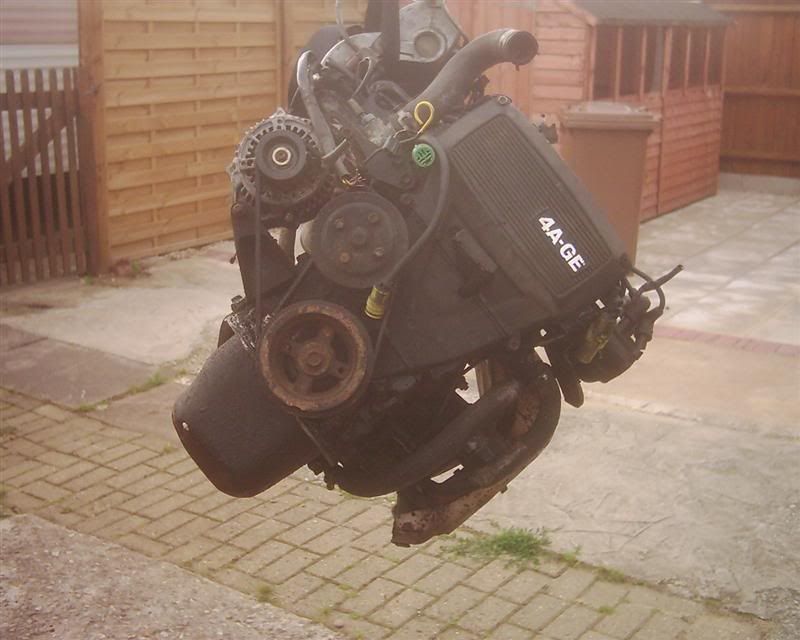

Then did a deal with Jungle-jim via another forum and bought another engine that i knew of to replace the dead one in his car.

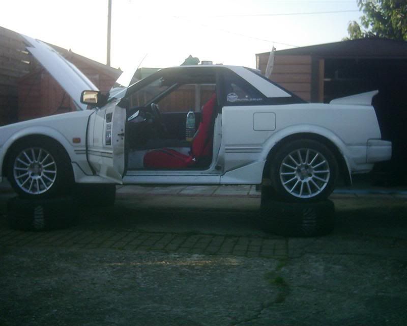

Then Jim delivered the car for me (huge thanks matey)

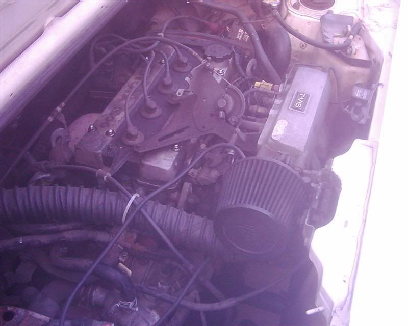

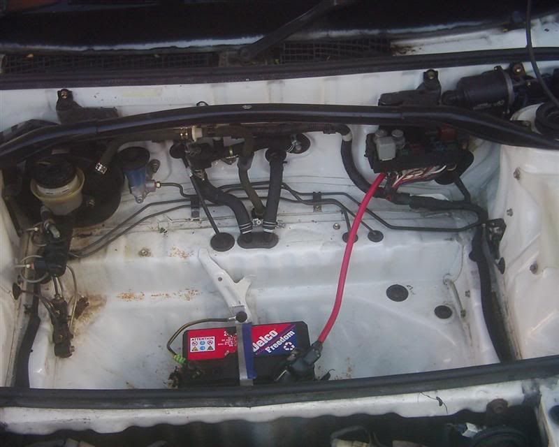

So next job was to get the car up in the air and remove the dead engine and gearbox.
So the engine is now out, just got to swap a few things over to the new engine and box, refit and fingers crossed it'll be back up and running for the drift day next week.
