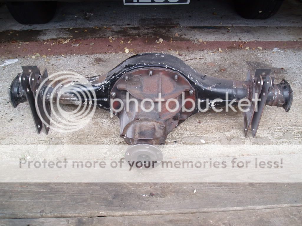

Had a week off work to do some diy
and managed to do a bit to the Prefect as well . I thought it was about time i fitted the rear axle but in the end i didn't have enough time although i did clean it and put some paint on . The axle is a ford 9 inch American jobby and bullet proof but it ain't half heavy, 8 and a half stone heavy and thats narrowed , without halfshaft's or brakes fitted . When not narrowed and fully kitted with brakes they weight over 100 kilo's
, i took a picture of it on the scales minus the brakes and halfshafts
and here's after painting
I also brought some rear calipers for the Camaro off ebay and they will be fitted along with the bigger front brakes over winter . The car will have 325mm front discs and 305mm rear discs instead of 280 mm front discs and rear drums , this should make a big difference in trying to stop the Chevy
i love ebay bargains. Pete:Chevy_anim:
