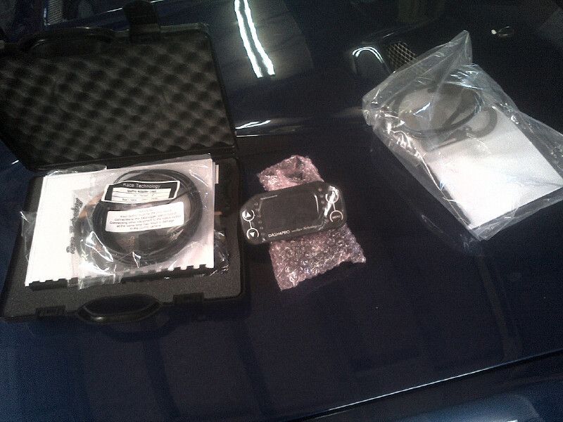

Shiny Race Technology bits turned up

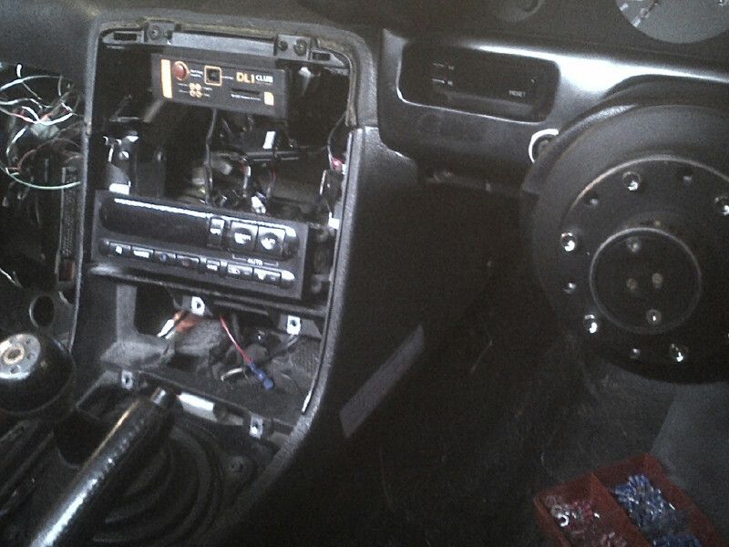

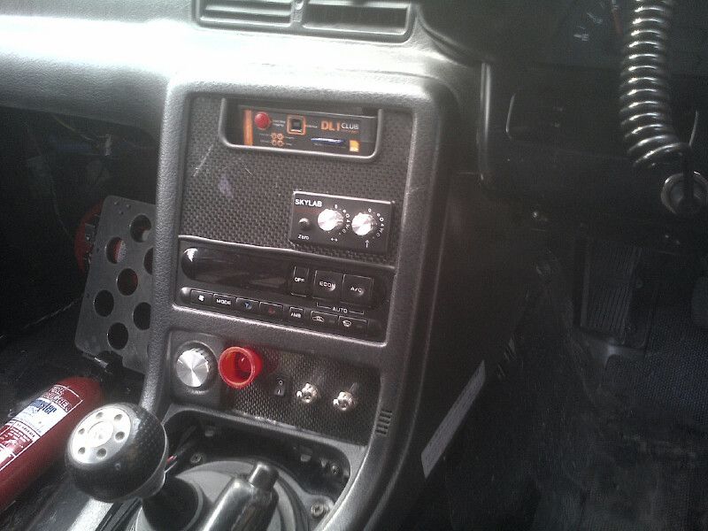

First up was removing the old dash panel and all the gauges and making up a new simpler one with a piece of carbon. The Data logger needs to be mounted level, and straight - for obvious reasons (i.e it needs to know which way it's "looking" so the DL1 Club had to be mounted first.
It therefore couldn't be fitted flush to the angled panel but I'm quite pleased with how it looks. The Skylab Fusion controls were also mounted on the new panel and the logger/dash on/off switch mounted on the lower panel by the fuel pumps etc.

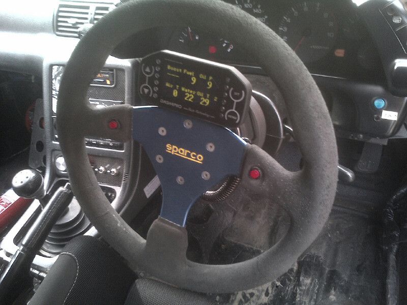

The Dash4 Pro comes with a bracket to mount it to the steering wheel, with a curly wire that plugs into the dash, allowing of course for steering and also the removal of the wheel. I went for the OLED display and very pleased with it, very clear and looks cool too

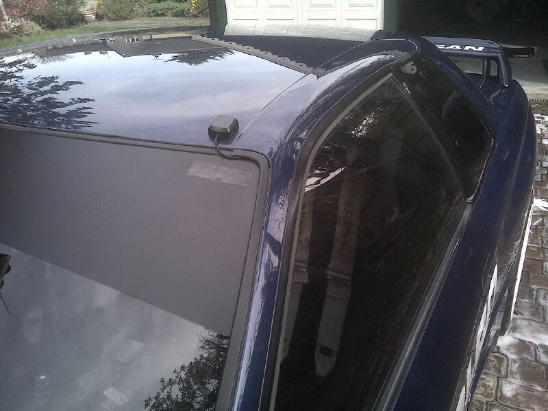

On to the outside. As per earlier posts I wasn't quite sure where to mount the GPS so decided to go with the Race Tech advice and put it on the roof so at least while I got used to the data logging I wouldn't be confused by any dropping of signal.
I chose the option running the cable up the A pillar and mounting the antenna close to that so there was minimal cable showing. I'm pleased with this as it really is quite difficult to notice, which is good.
Here's a shot from a distance
And here's a close up
