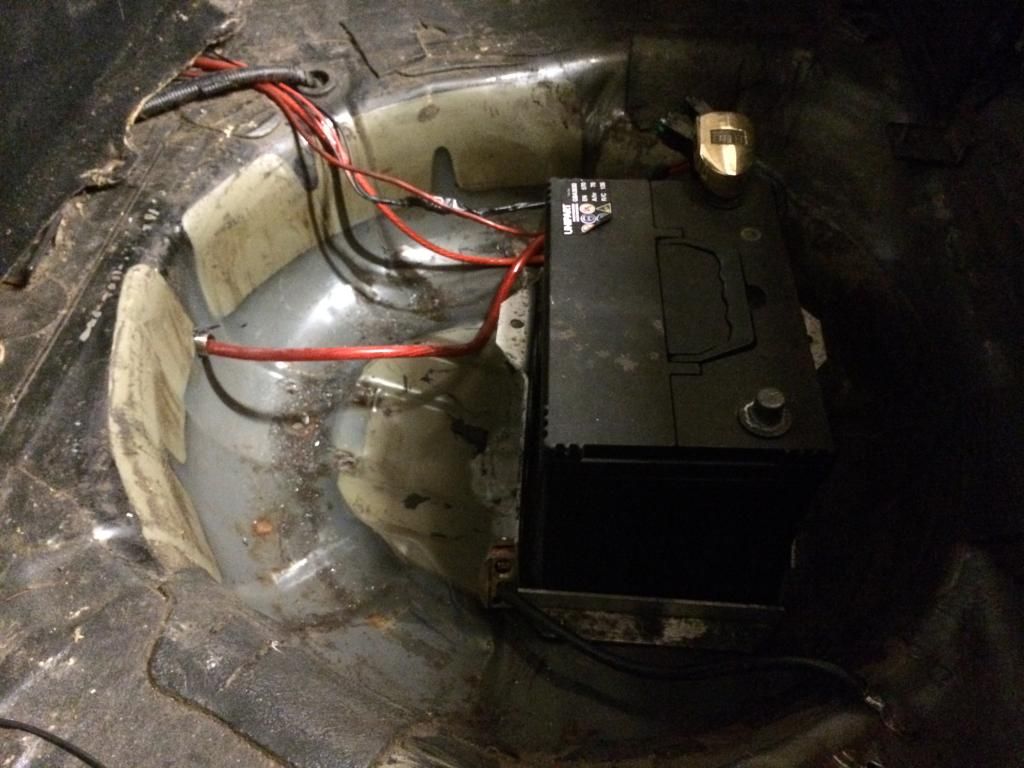

I have relocated the battery to the boot for more room in the engine bay and here is the rough work so far.
Battery mounted in a tray in the spare wheel hole as there is no reason to carry a spare.

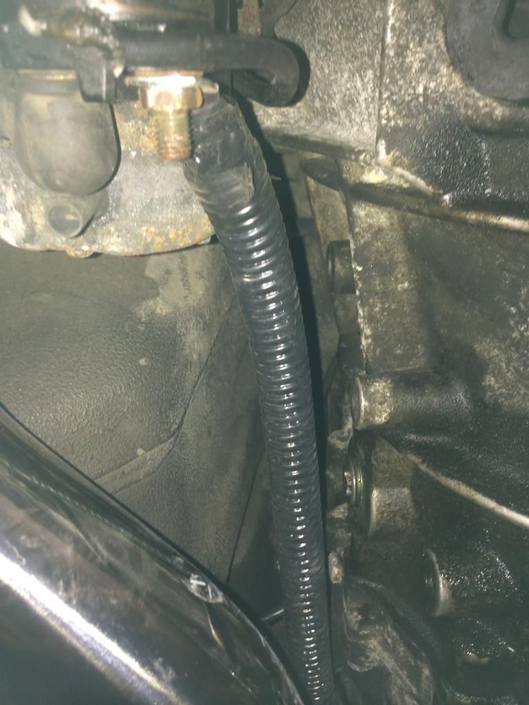

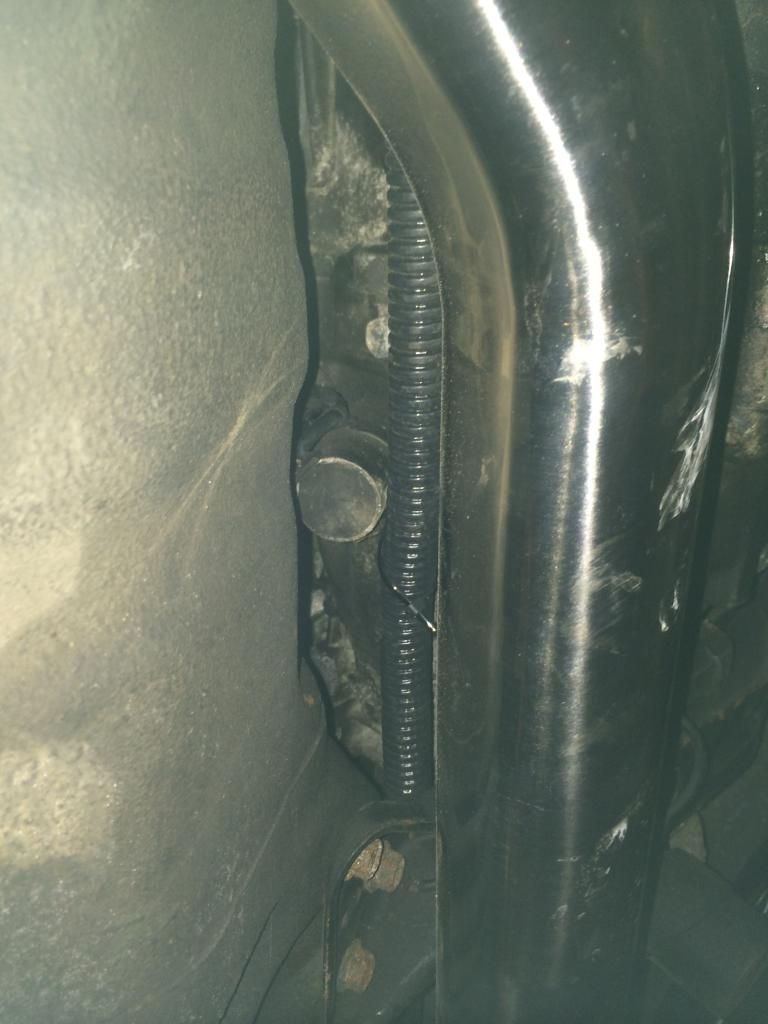

The battery starter cable is a new cable I made up with 300A rating pos cable the is protected by an armoured sheaf and ran under the car and into a hole to the boot.
The cockpit services pos that joined onto the battery cable pos has been joined to a new cable and run through the vehicle again to the boot.

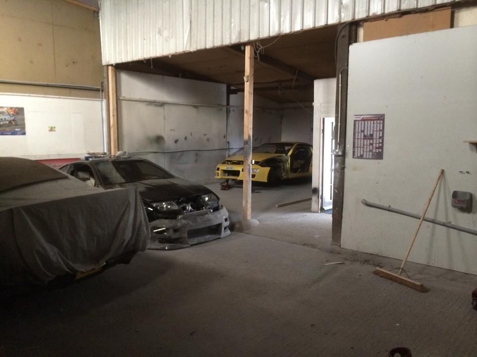

So having moved into a new and bigger workshop with somebody else I will have some time next week to get some work cracked on the zed. The new Odyssey battery has arrived ready to give some real starting power and hopefully the Nismo 740cc injectors will be on route so I can get them fitted. May get the cam covers powder coated while I've got the plenum off to fit the injectors as well as the plenum powder coated.
A lot more room to work in now though so it will install some more motivation in me to get things cracked.

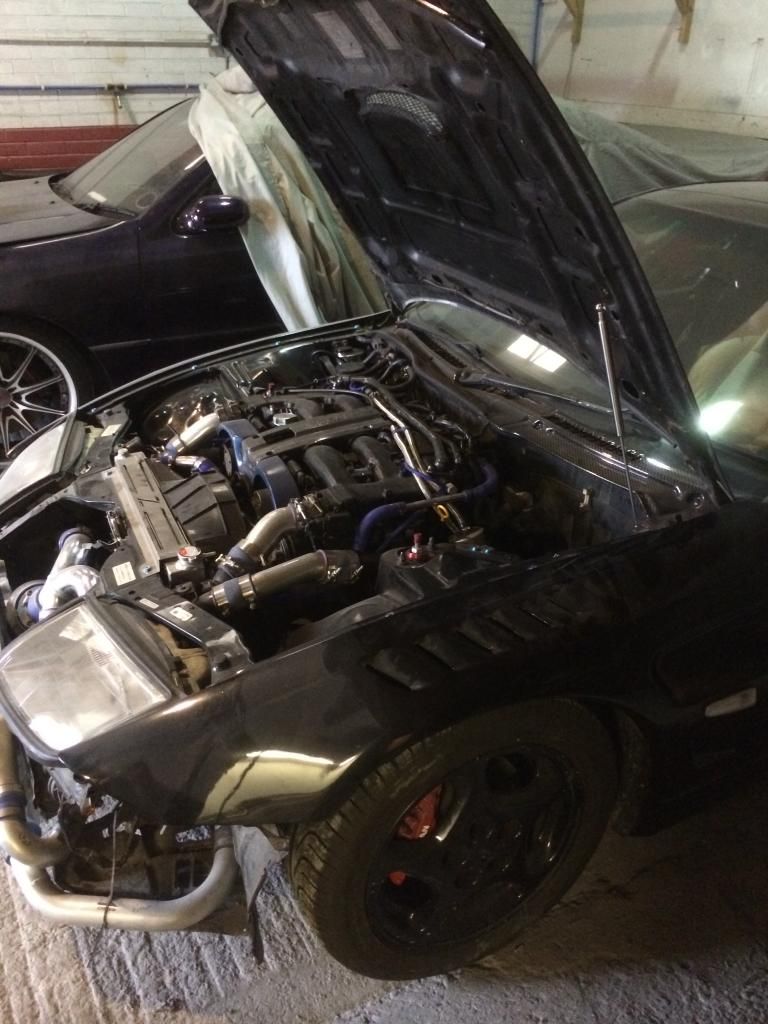

Firstly custom fitted bonnet gas strut

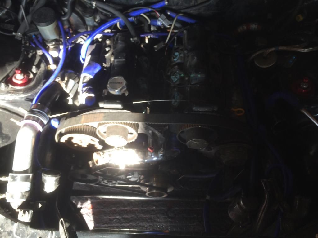

Then today having spent most of yesterday putting 2 inch of suspension lift on the truck, got onto the zed engine and stripped her down ready for the injectors arriving.
Also the new Odyssey battery is in the boot and I've got the ecu harness ready to remove as I'm going to replace due to it being 23 years old and in crap condition. Probably the main reason the engine was running rough.
