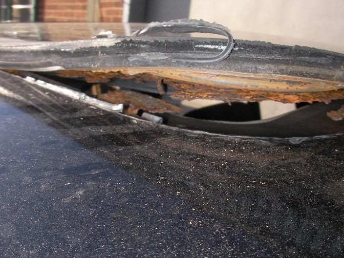

on saturday gordon turned up in the car and the sunroof brackets had broke
do to the amount of rust in the frame.

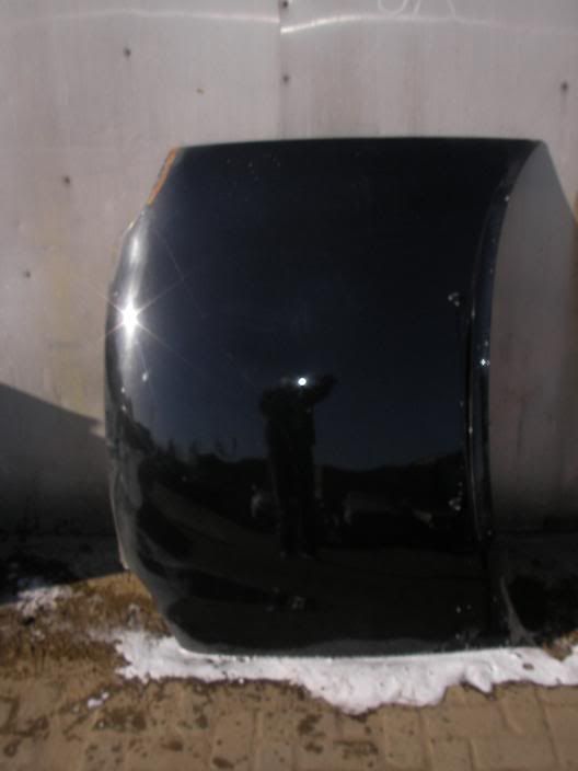

so went to see the guys next door, beavis and butt-head and asked if they
had an old bonnet and thankfully they did in black wahoo.
this is off a MK6escort

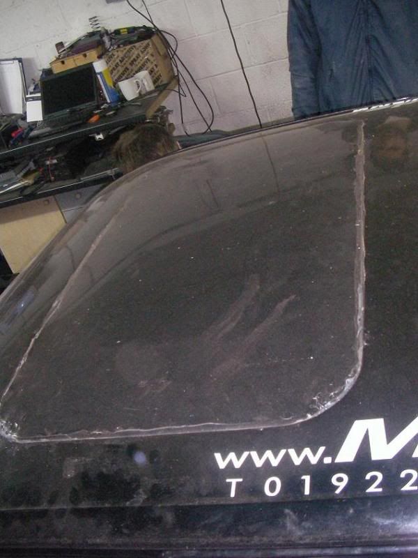

after cutting up bonnet tapped it on the roof and marked underneath
so knew were to fold the metal
spent a few hours bending the metal so it would fit in the gap, there was plenty of
cursing, hammering, bending going on but hafter all the it fit quite well
so drilled holes and pot rivited it to the roof and then put some
sealent around the top to make it waterproof
sorry no pic of it in but ill take some next saturday.

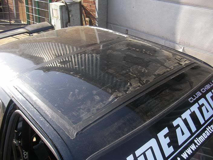

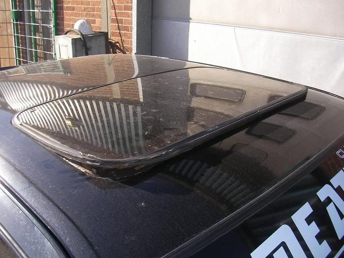

here is a pic of the new pannel in the roof

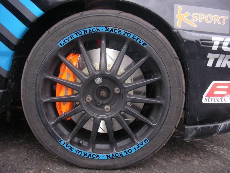

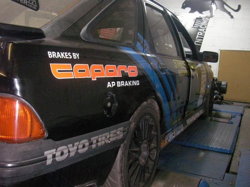

got the graphics made up last week for the caparo brakes and put it on the rear quarter.

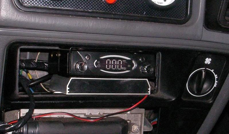

gordon had a boost controller so yesterday i bolted it to the dashboard
and wired it all up. after going thru the booklet the light is the same colour
as the dials so all match's.
