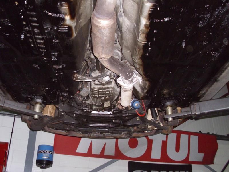

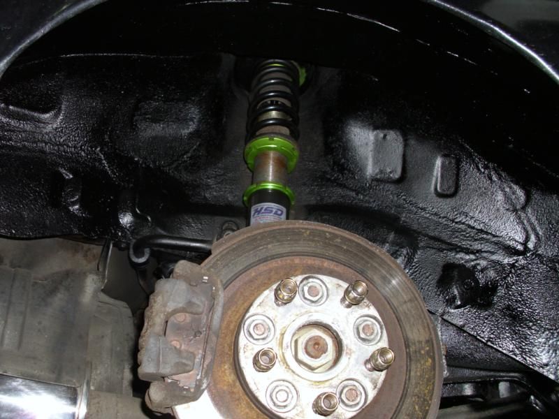

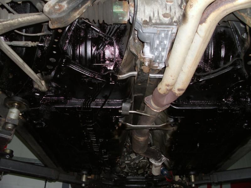

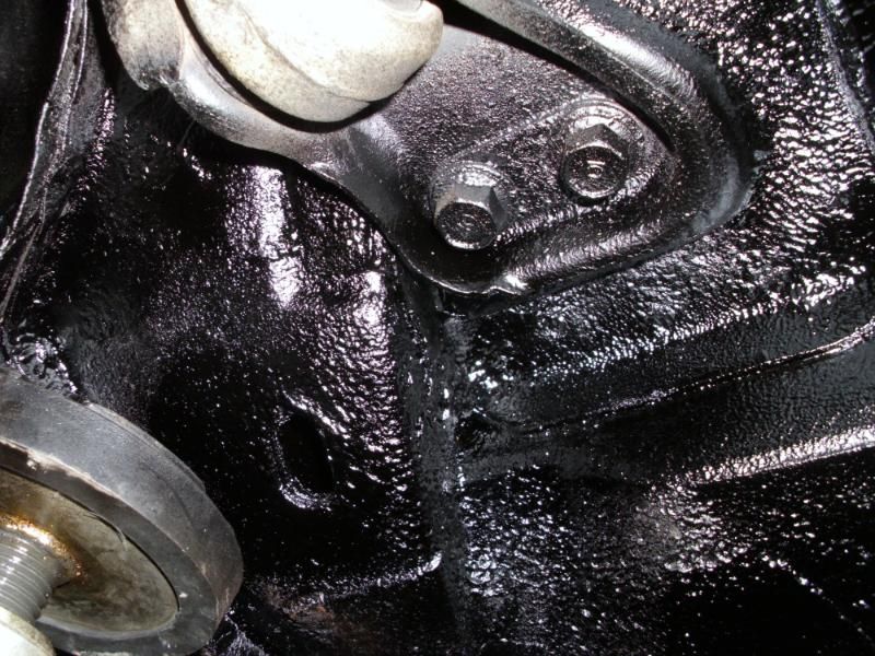

Small update, I got the car undersealed by Stu at the end of last week.
I can throughly recommend his services, he was more than happy to following all the startup and shutdown the procedures which I asked him to follow on the Rex. Kept me in the loop throughout the whole process and took alot of pictures along the way.
Anyway... here are some pictures
