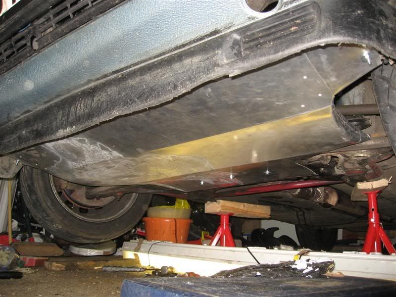

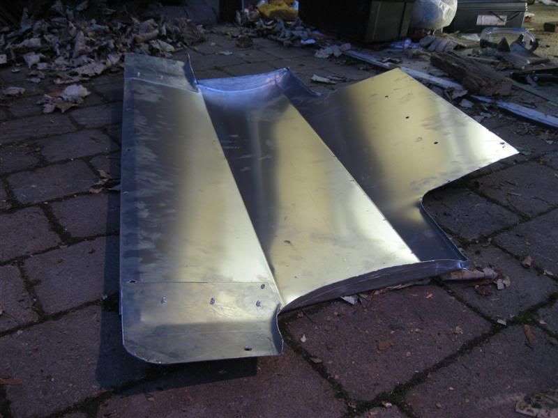

Just for info, I made an undertray out of sheet aluminium. Didnt add a splitter, the Golf is so un-aerodynamic anyway, it probably wouldnt make any difference !
I actually made it to catch any oil drips rather than let them drip onto the track. I had a bad time at Beford last year where someone was dumping oil on the track and they blamed me. Turned out is wasnt me, but I DID have a very small drip, now that is collected on the undertray so I put nothing on the track
You've made a very nice job of that undertray . Just out of interest did you notice any differences in the car when you put it on. Did the engine temperatures change at all?
I didnt notice any engine temp changes, I specifically compared before / after, but it seemed the same.
I left a `gap` at the back, above the front subframe where the steering rack mounts, so air can escape, basically, where the exhaust leaves the engine bay, thats open.
Saying that, I seriously did consider covering the entire underside of the car in flat aluminium sheet and fitting a rear diffuser
That is a thing of beauty and I like your nod towards other track users too. Very considerate. (I concur that an entire alloy floor pan would indeed be very smutty)
stuart wrote: and I like your nod towards other track users too. Very considerate.
As the car spends most of its life n the ring, where Bikes are also driving, I felt the additional work was worth it, I`d hate to put something on track that caused someone else to have an incident.
