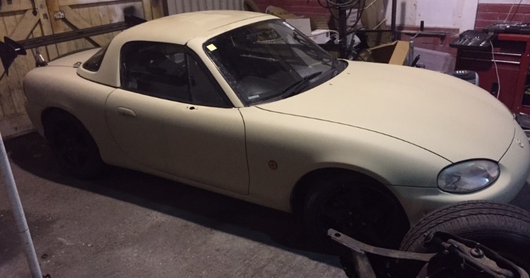

I went for the NATO desert tan on my other track car :) went on easy with a roller for that textured look ;)

Gonzo12c wrote:I went for the NATO desert tan on my other track car :) went on easy with a roller for that textured look ;)
That's exactly how Mitch (who used to own DriftGarage) did it. A roller and a tray of NATO green out of the tin.
I've opted for several NSN'd 400ml spray cans.
It's a bit of a bastard as I have to pay for shit like that now, gone are the days of popping down the QM's with a packet of chocolate hob nobs.
