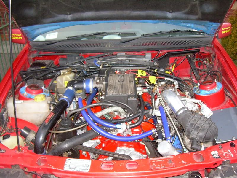

The engine is finally all back together :-D

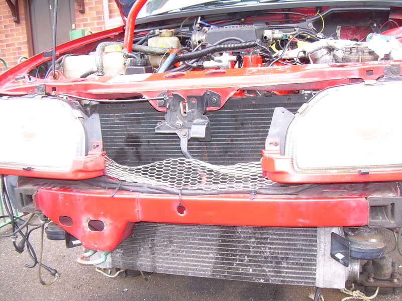

The reason for moving the oil cooler can clearly been seen now and should improve engine cooling drastically. Previously the oil cooler sat on top of the intercooler infront of the rad.
We had hoped to get the plenium powder coated but with so much to do forgot all about it :roll:

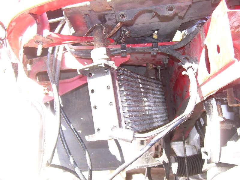

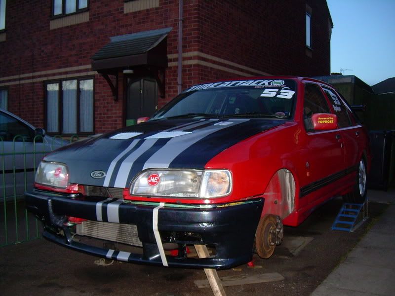

The oil cooler has now been inverted from the position we had placed it as per the comments made to an earlier post
. Alan had a bit of trouble getting it to fit in this rotation and as such it has now had to fitted at an angle. We have test fitted the new bumper to check the air flow to it. This will now need some slight modification to ensure maximum air flow to the cooler.

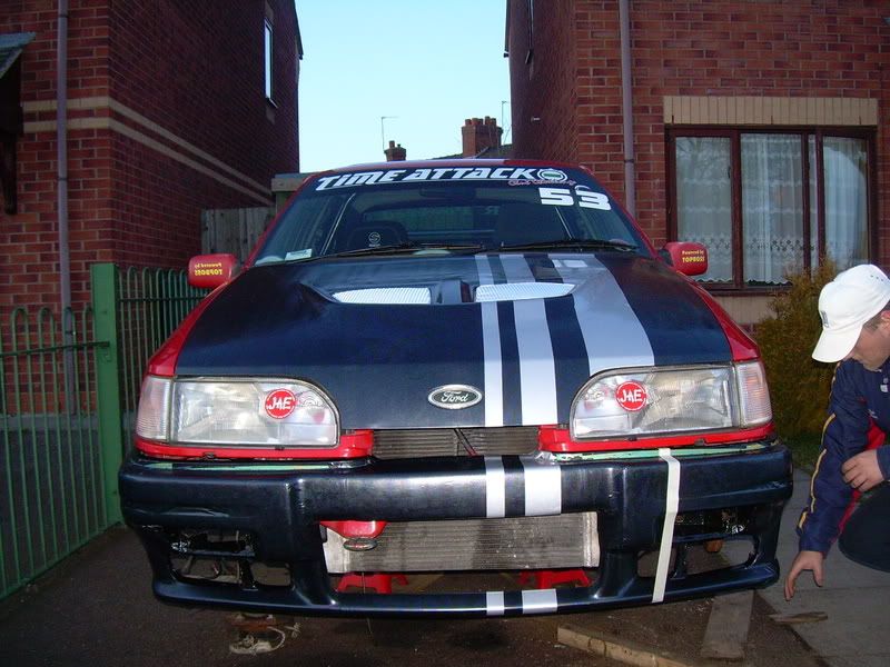

The new light weight bonnet is all finished and Alan decided to wisely test fit it to his car to see how much it flapped at road speed and apparently at 70mph it flaps quite a bit :? . This will be sorted when fitted to the car

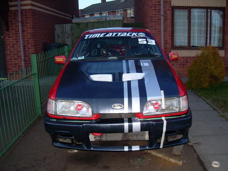

New Bonnet & Bumper

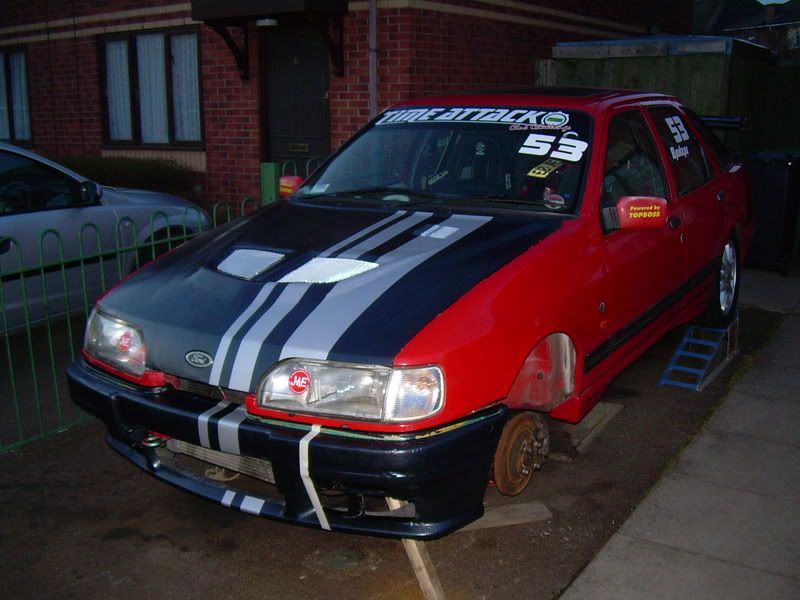

A few pics of the new look car
It took 7 hrs to finish the bonnet and 5 hrs on the bumper
That front bumper looks cool
