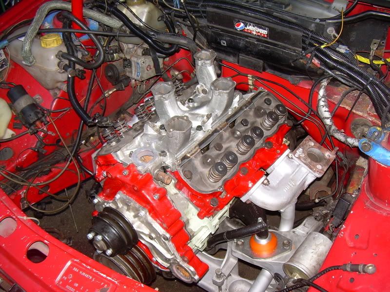

today has been a good day, spent most of the morning to and from ashley exhaust sorting out
the cross over pipe making sure it fit on the car properly and drinking coffee and eating bacon sandwich's :-D
other work that has been undertaken today are as follows

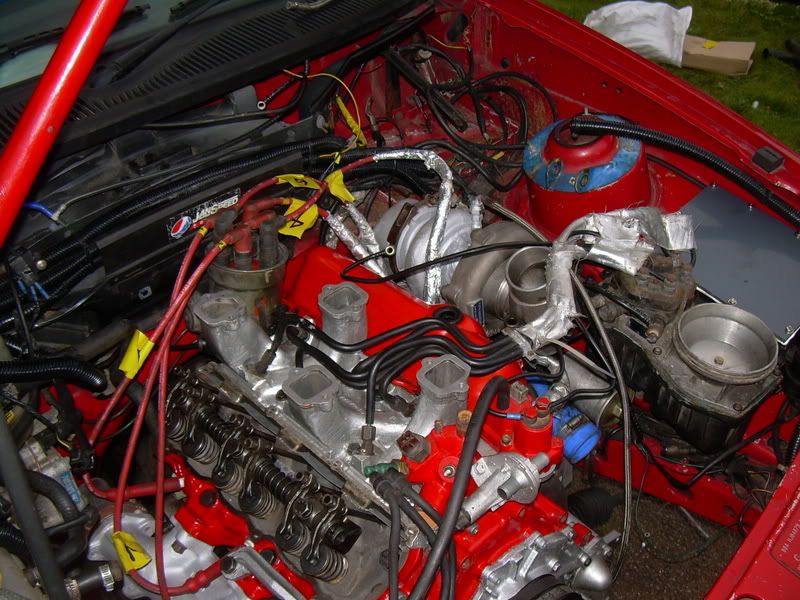

1- cross over pipe fitted
2- turbo fitted
3- exhaust down pipe
4- waste gate fitted again and now sits right
5- front propshaft
6- air box with new piping to cone filter
7- air/fuel metering unit
8- anti roll bar

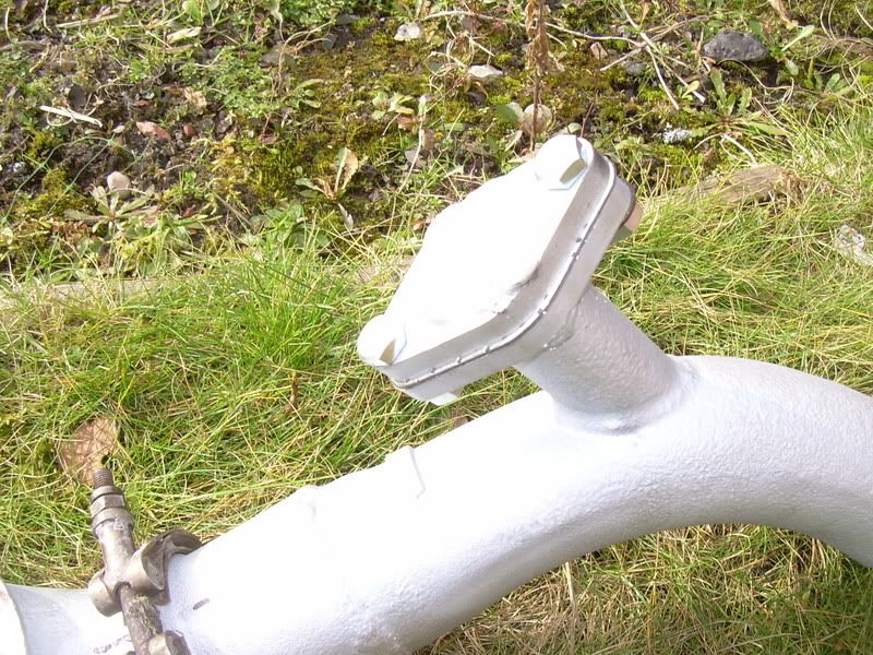

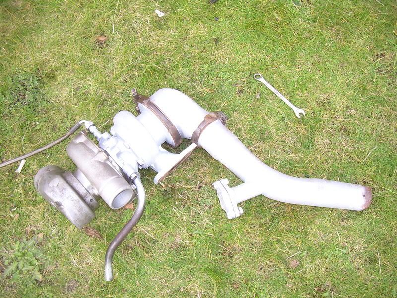

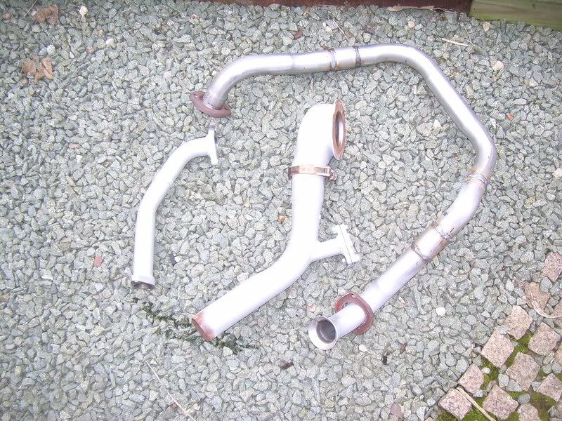

waste gate pipe. cross over pipe and exhaust down pipe
this is were the old wast gate used to go into but now its bloked off but can take it off if we ever need to use it

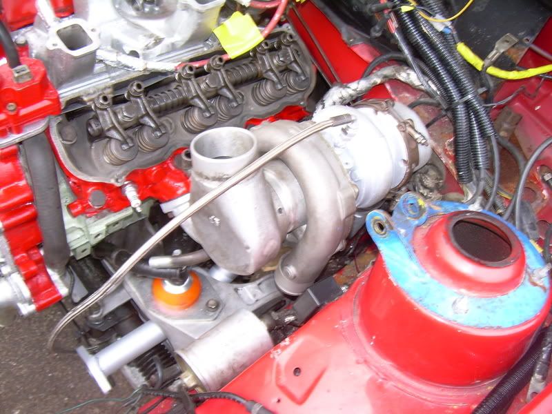

turbo and down pipe together
fitted :-D

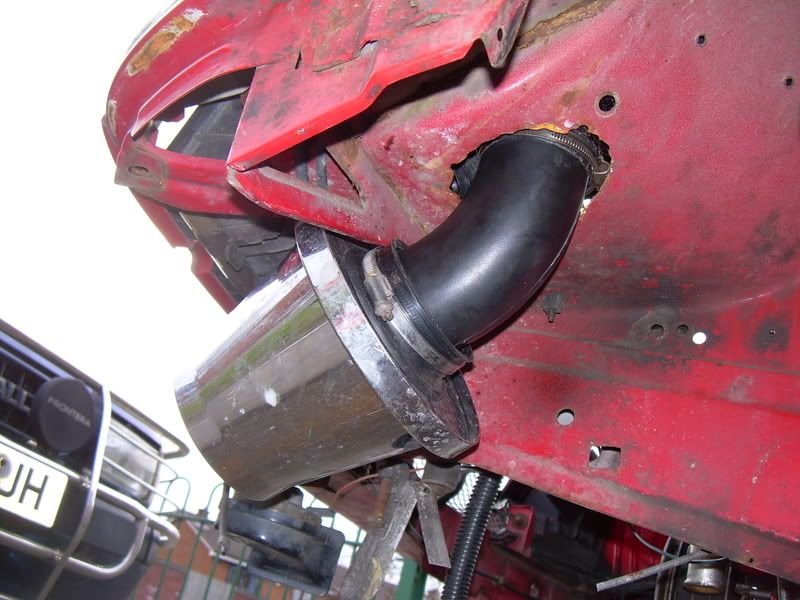

this is were new filter will be sitting, this is off my GT to see how it fairs

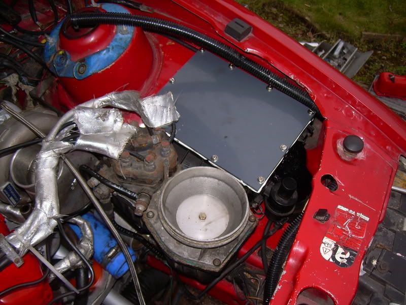

air box and air/fuel metering unit back in with my custom made lid :lol:

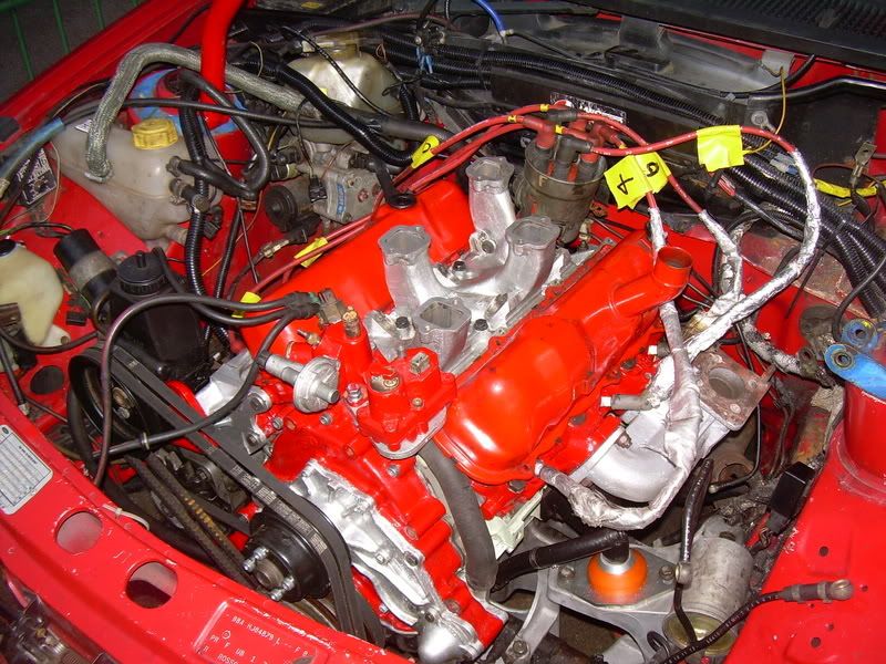

all fuel lines and injectors fitted.
