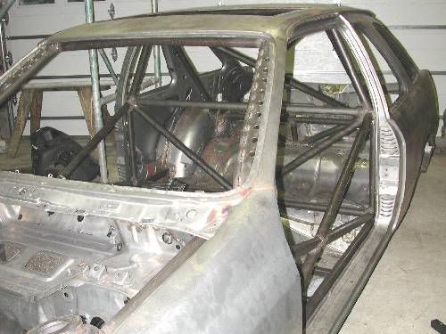

The Sierra will be on the receiving end of some minor refresh work for the forthcoming trackday season. A full service will be followed by some structural work to the cage to make the whole thing a lot more rigid.
I need to get the existing Safety Devices cage welded up to the A and B frame pillars using roll cage braces to stiffen up the cage and chassis. A bit like this

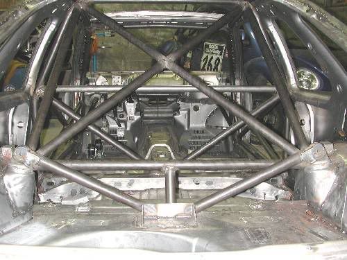

I then want door bars running from A pillar to B pillars as shown above. Lastly I want a rear cross bar for the area from the top of the rear cage at roof level down to the rear pick up points on the suspension turrets. This next picture probably goes a bit further than I can afford or need, but it gives you an idea.
