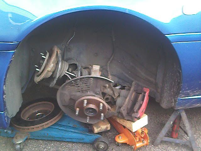

oops, mr. rollbar shouldnt be like that!
had to take the lot off

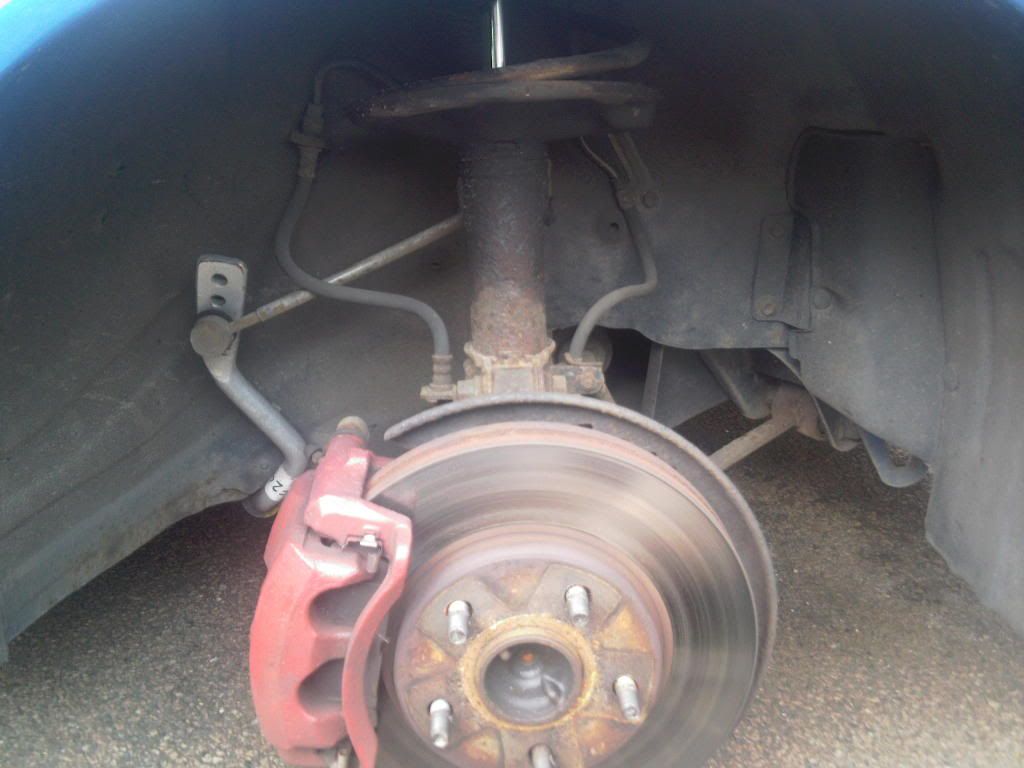

met up with Stu on saturday and had the car up in the air for its long over due fluid change and to inspect the front underside of the car to find this phantom knocking. all went well, found a few loose bits here and there but i finally found the noises i was looking for, both front droplinks basically had it. one had a bow in it, and the other had a nasty 30 degree bend in it and they had come loose too. so the answer, new ones from camskill :) should come sometime this week, then the car will be up in the air again to grind off the old, and fit in the new :smash:
