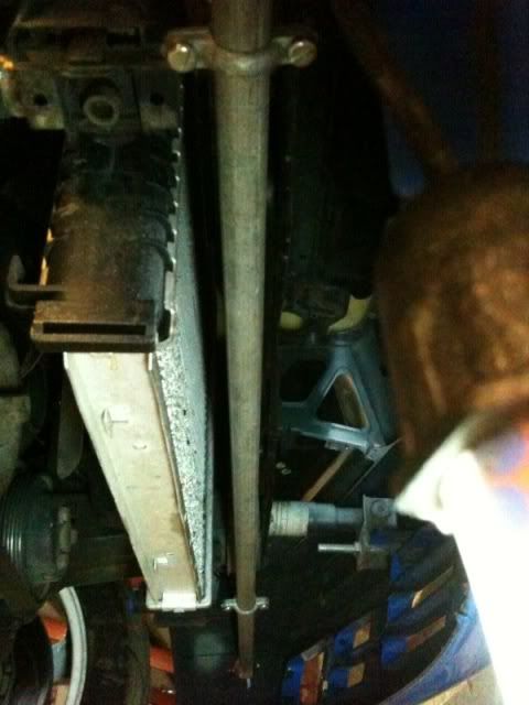

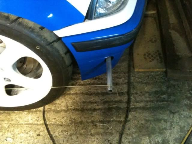

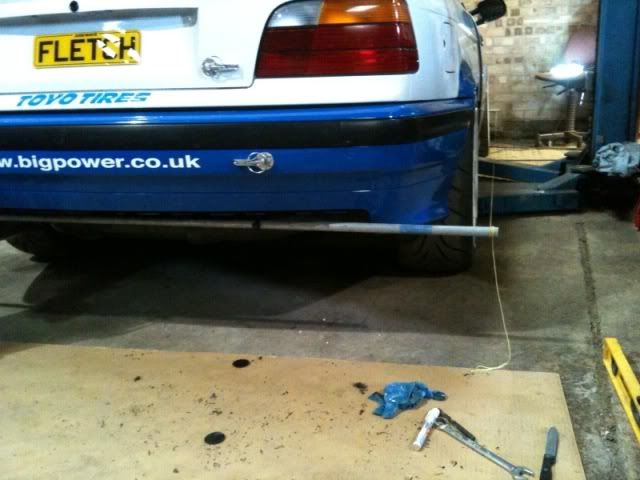

After my first effort at doing the alignment on the car using axle stands,timber and some string it became apparent that although this works it has some flaws ;
a; it is time consuming to set up
b; you cannot really move the car to settle it once you have made any adjustments.
i gave this some thought and decided to have the cross bars which hold the string fitted to the car
enabling me to move the car after an adjustment and also allowing quicker set up time as i wanted to be able to utilise the flat floors of the pit garages on trackdays.
A rummage in the workshop came up with some air pipe and wall clamps ,the clamps where fixed to the car and then i just slide a piece of pipe in from one side and tie the string on quick measure and hey presto job done
(i think) this coupled with some floor tiles to allow for the wheels to slip should work out ok
