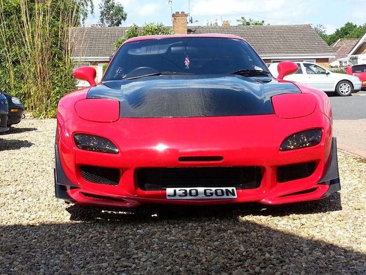

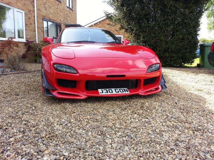

Doing the headlights is a ballache if you are particularly fussy, just remember when you have loosened them to shut the bonnet properly otherwise you'll never get them level. Also be careful when opening the bonnet again in case they catch on it. Oh and finally be very careful as the brackets on the covers are rubbish from new, let alone having a bit of heat from the enginebay on them
Have fun !!
