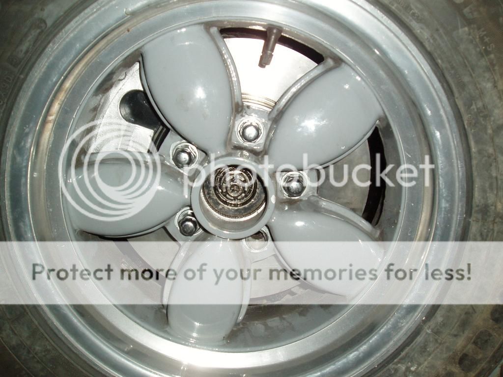

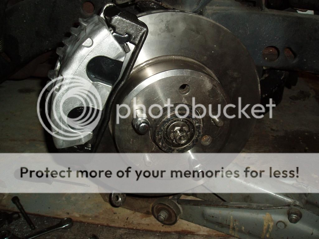

In the meantime i have been trying to stuff as much brake as i can behind the old 15 inch AR's and have found a good combo for the front . Having had success with the 5 series BMW brakes on the back end i thought i would raid there parts list and get some disc's for the front . Iam using the LS1 Camaro calipers but the LS1 disc wouldn't fit so i found a 320mm off a 1990's 5 series that would work , its got more offset so i can get the caliper to fit the rims . 320mm is still too big but there is plenty of metal on the BMW disc for me to turn a bit off in a lathe , i worked out that 315mm would just fit but i played safe and turned it down to 310mm . As luck would have it the old lathe at work snapped its drive belt so i spent an afternoon trying to fix it ,its real old tech and i would guess that it was built in the 1940's but its not bad when it works . It took 2 hours just to turn the disc down because the new drive belt kept stretching and i had to stop and re tighten it but it all worked fine in the end .
here is the new disc with the old one , i think 310mm will work a lot better than the thinner 280mm chevy disc.
I used the old chevy caliper mount and cut it about and welded some tabs on so that i could bolt the LS1 caliper frame on , it took a couple of attempts to get the frame in the right place .
The LS1 caliper is quite long and there isn't a massive amount of room between the upper control arm and the steering arm which on this is mounted on the rear of the hub like the caliper . Its all a nice snug fit and enough space not to rub on anything , although i will have to use allen headed bolts instead of hex headed ones so they clear the steering arm .
It all mock's up nicely and importantly i can fit it all under the 15 inch rim without any rubbing . Pete
Nice fab skills mate
Looks a nice fit behind that alloy too.

Stuart wrote:Nice fab skills mateLooks a nice fit behind that alloy too.
Thanks Stu , i was a bit lucky with the braket really as one of the 2 mounting holes was spot on , so all i did was tighten that one up and move the frame to the right place and then mark where the 2nd hole needed to go . I was surprised how much difference being just 1mm out made to where the frame aligned with the disc , this stuff needed to be spot on . I will put a picture up of the before and after of the bracket when i have cleaned and painted it . Pete
