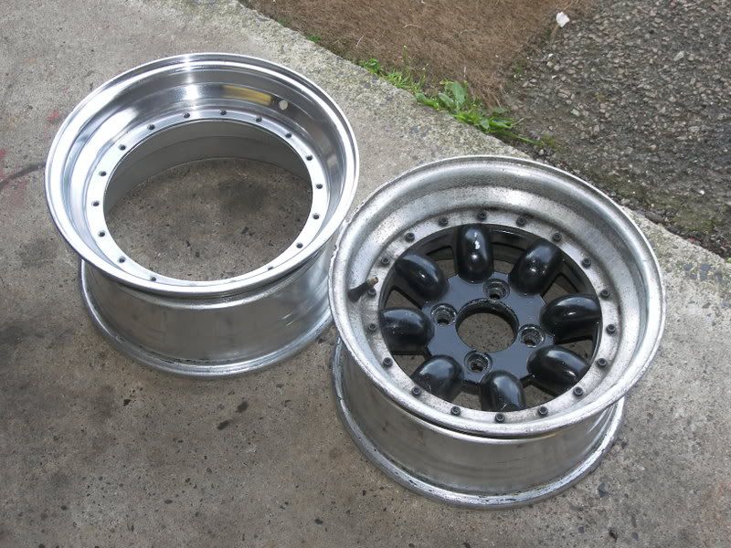

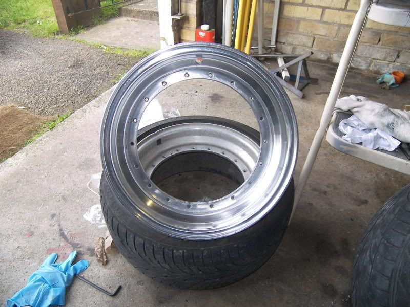

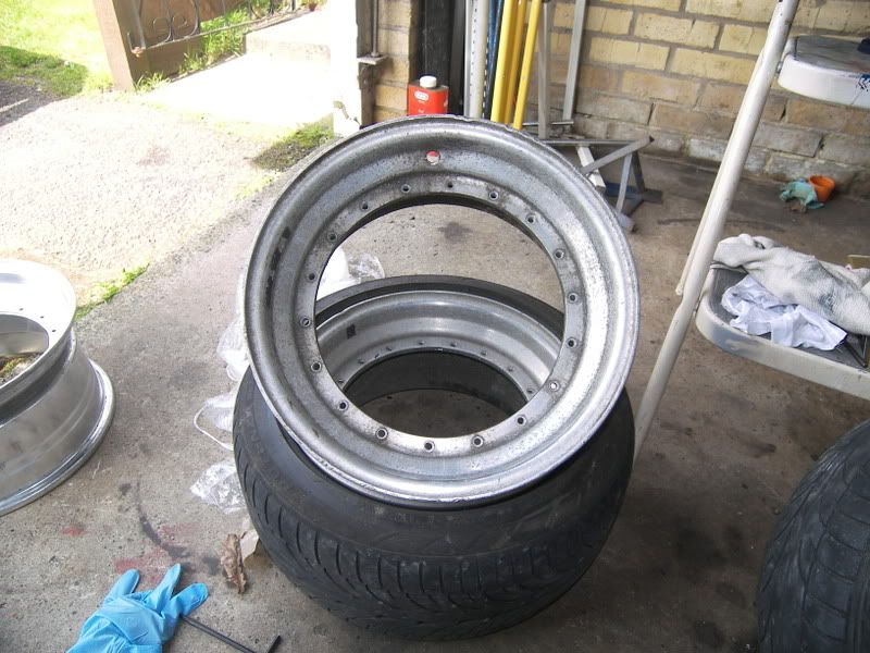

well this is what i did;
1. degreased the wheel thoroughly,
2. then used a scotch brite pad and WD40 to cut more crap off,
3. then bought T-Cut alloy polisher and applied it with the drill + buffer wheel,
4. then i rinsed the wheel and brushed the grooves to get more crap out,
5. and finally i applied sovol autosol with muzzlin by hand for the final finish
worked out well hasn't it, can't wait to blast the centers and give them some paint and get my tyres too 8)

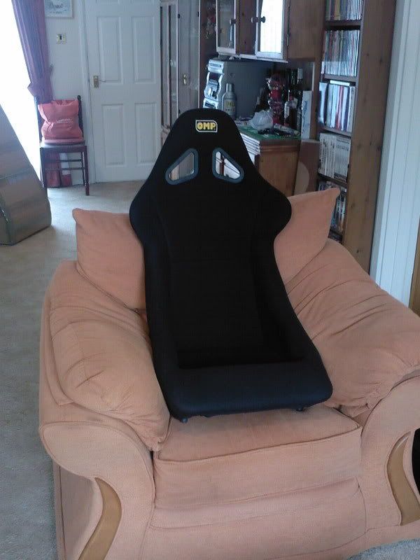

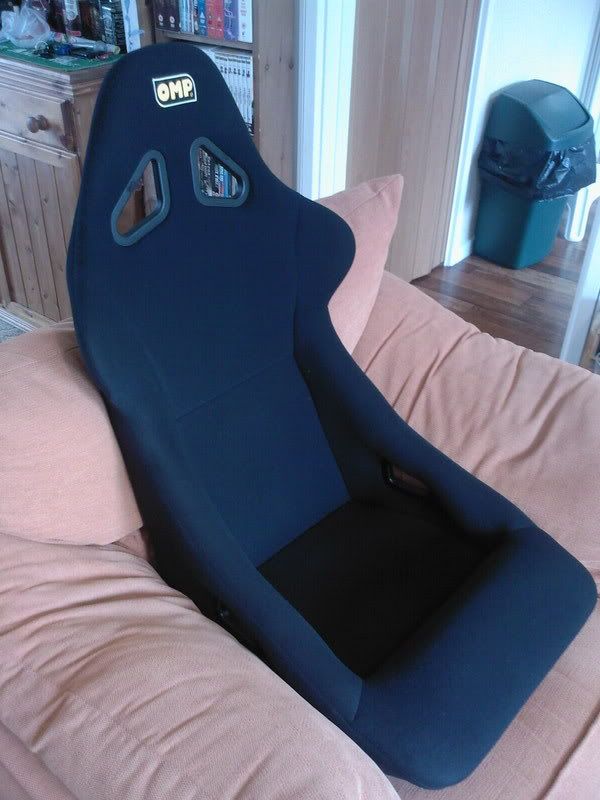

edit; another update, the seat's going back. it doesn't fit :roll:
