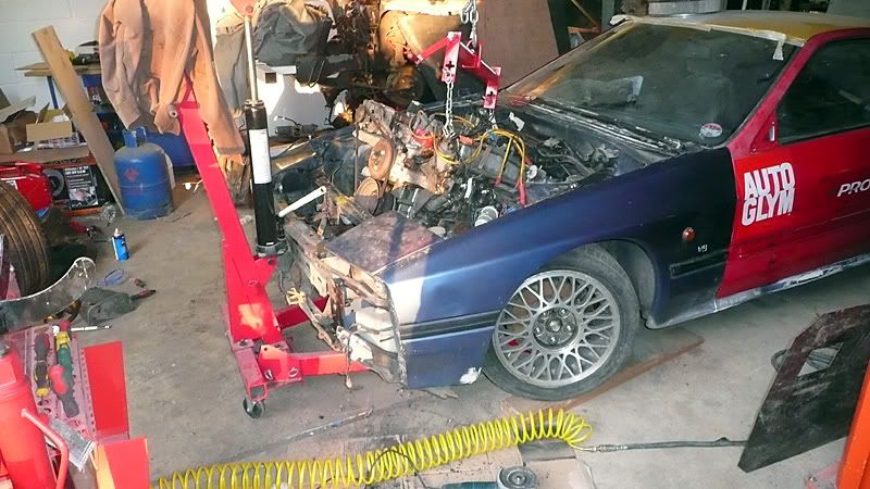

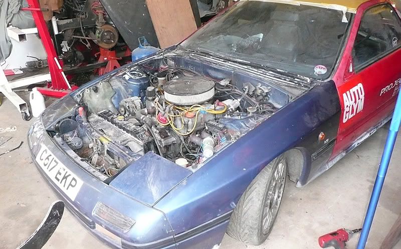

The V8 in the car, as I got it:

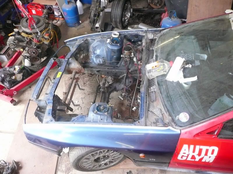

And its place now after tonights work:
(engine out was easy, getting the bumper off was 2 hours of swearing at Mazda. New, quick releaase mounts will be made for it before it goes back on)
The list of what has been done is posted above. Only the engine out to add, and of course I designed new engine mounts tonight for a much better install and easier servicing, fitting and removal later. I will start making them this weekend. For the build photos here are a collection of ones I remebered to take as working on the car...

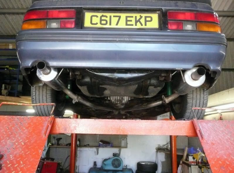

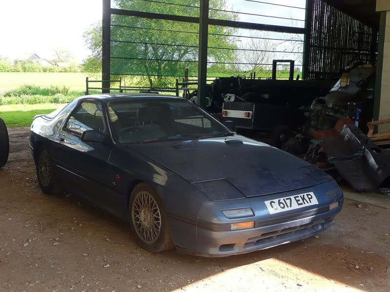

Arriving with the car

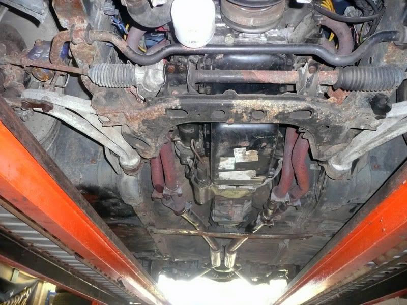

what it used to look like underneath
and at the back

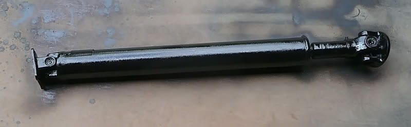

custom prop with slip joint

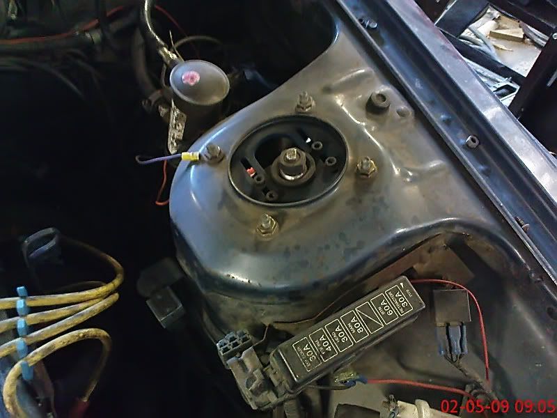

spot the stupid mistake by the original builder
Yep, adjustable caster rather than camber on the top mounts

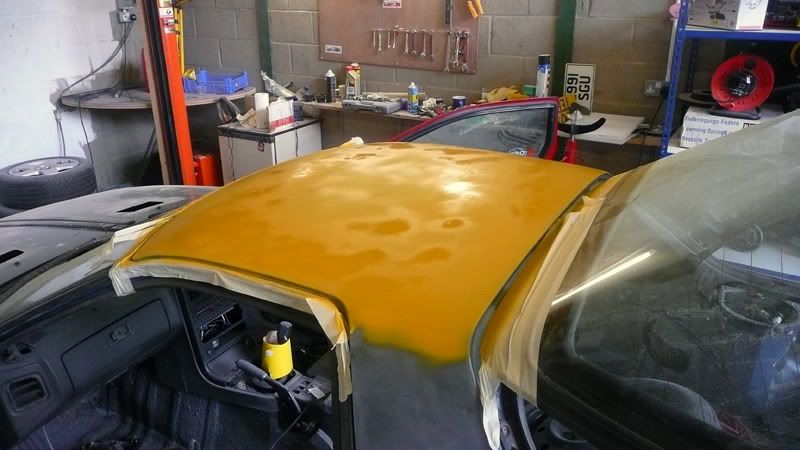

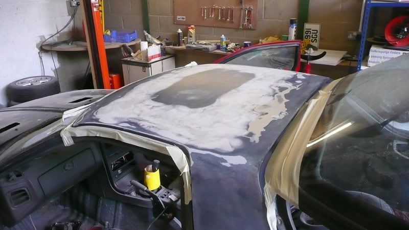

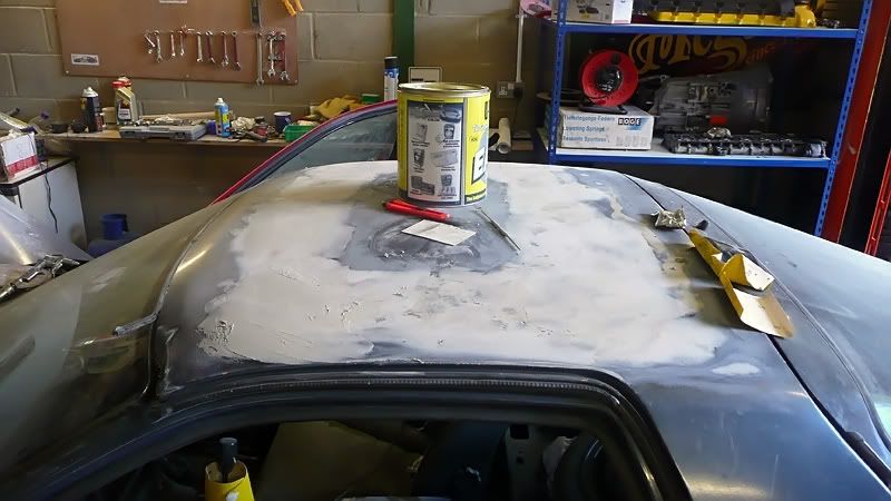

Sunroof panel welded up and filled
and smoothed
and primed

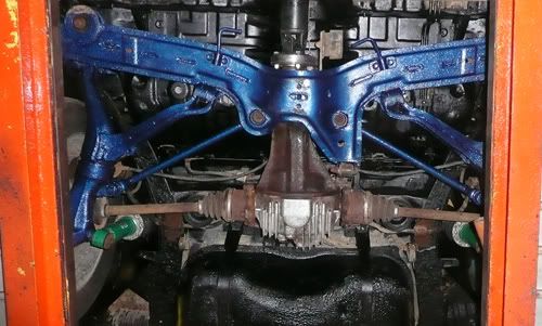

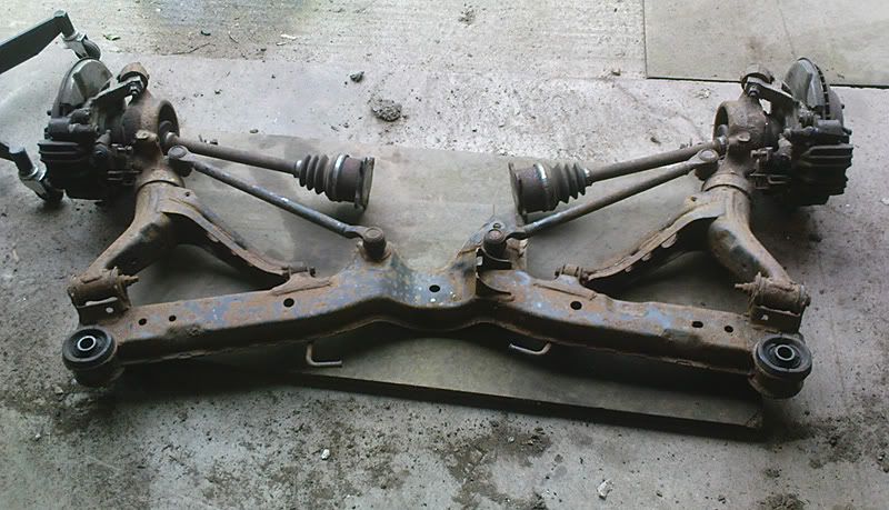

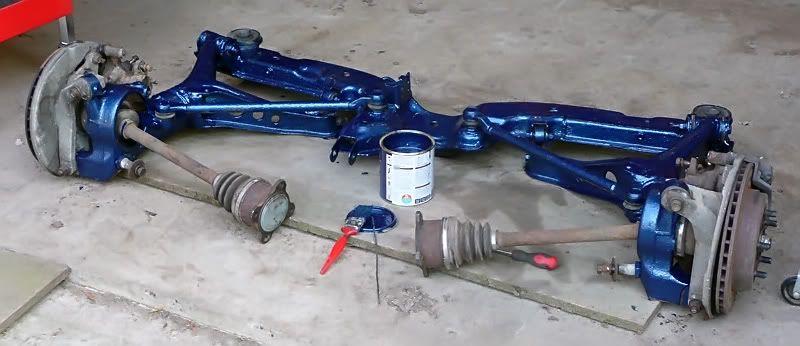

Rear subframe coming out
other toys patiently waiting outside
subframe out

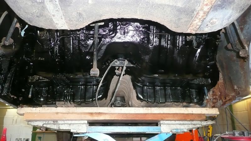

floor washed and waxoyled whilst the subframe is out
Subframe sorted and painted
and back in teh car with an RX7 turbo diff and driveshafts too

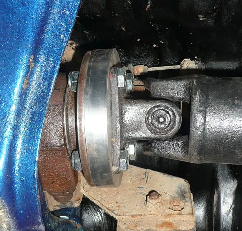

Prop adaptor for turbo diff made and fitted ( thank god for the lathe)

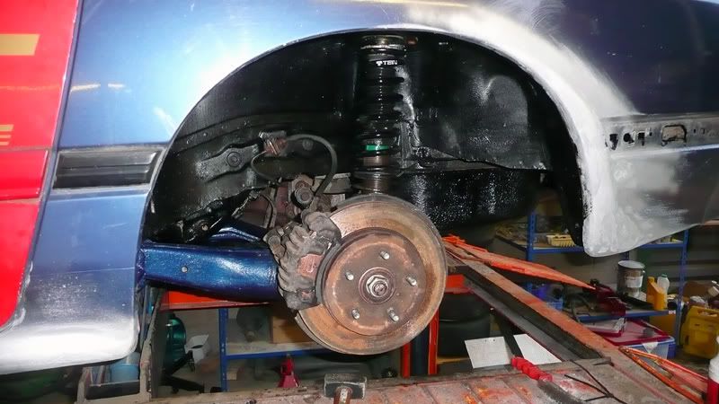

rear supension and brakes sorted (front also done)

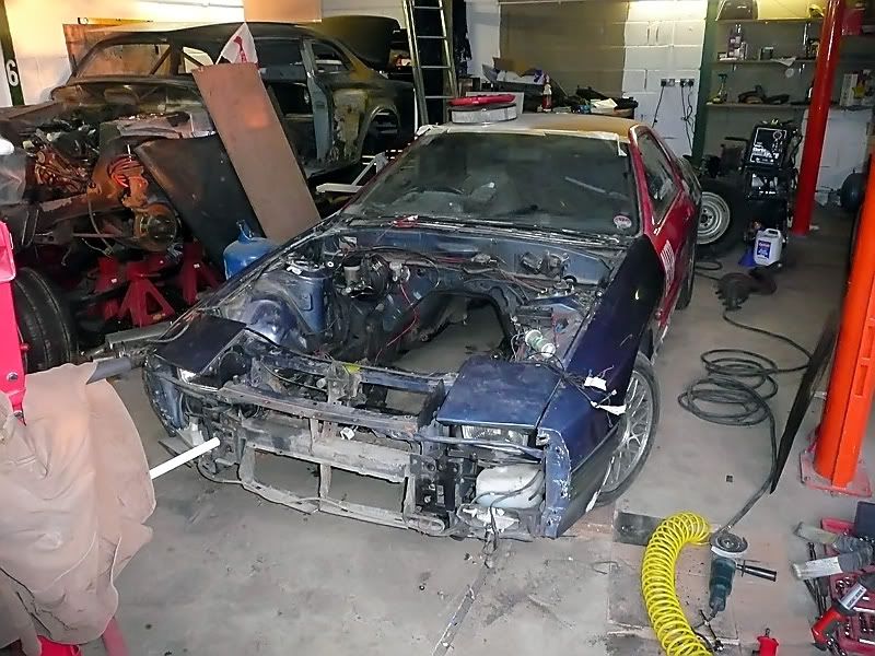

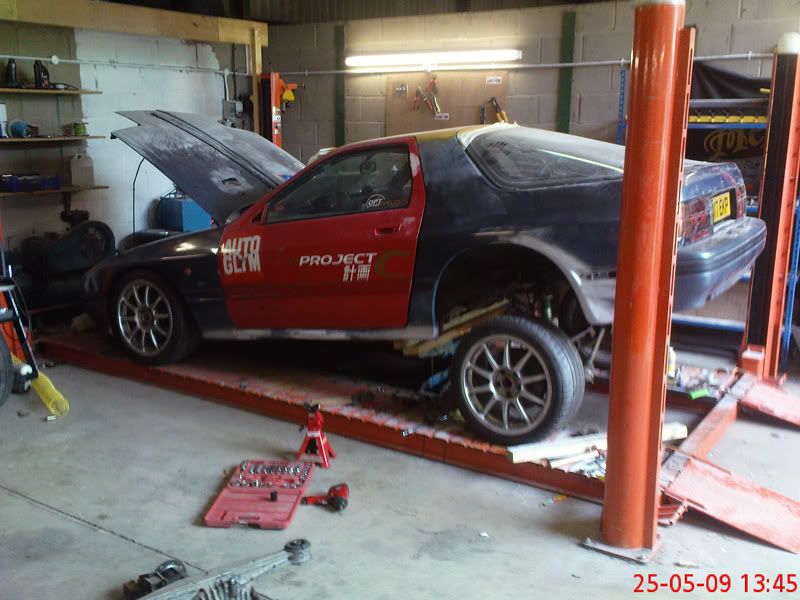

Bonnet off (very light alluminium, no need for a carbon bonnet here) and geting the engine ready to come out

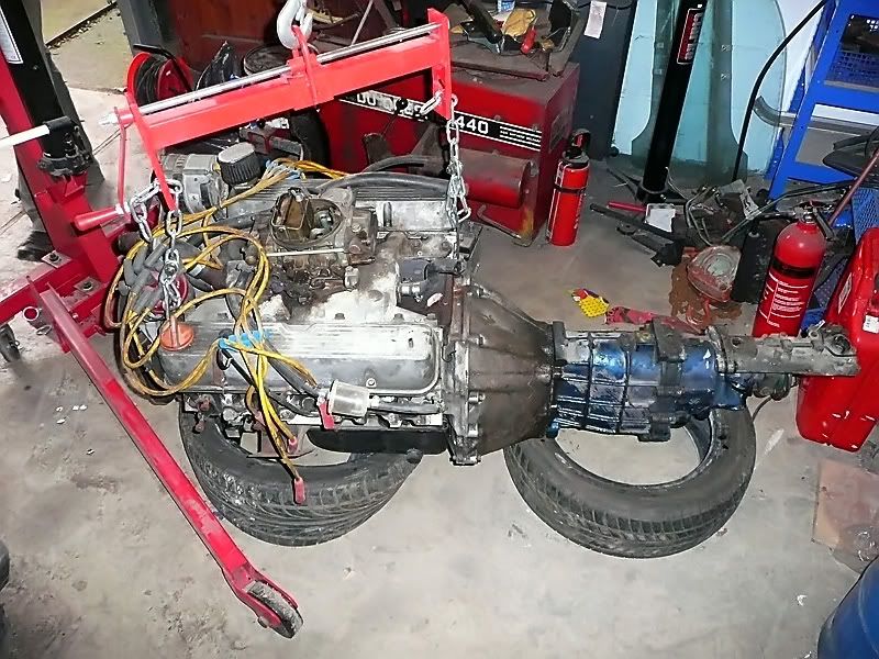

Here it goes
And the empty engine bay

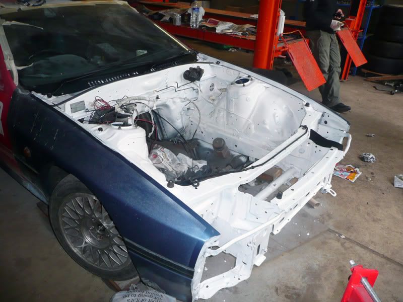

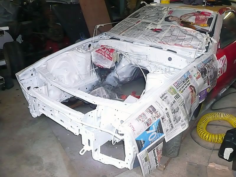

This weekend I got the engine bay stripped out of almost everything and the whole front end off the car too. Cleaned it all, sanded and finally paiinted the engine bay white. I also took the gearbox off the block to work out what is going on with the clutch. Still none the wiser, but will probably replace what is there whislt it is out since I dont know its history.
Some parts have been re-painted, built or whatever needed and have started going back into the engine bay, but I need to sort out the steering and designing / making new engine mounts before I get too far into that.

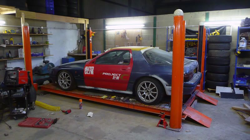

Found the camera whilst doing a little more work tonight.

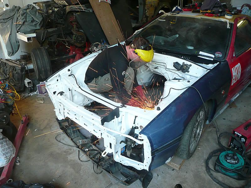

So, Engine bay getting cleared out:

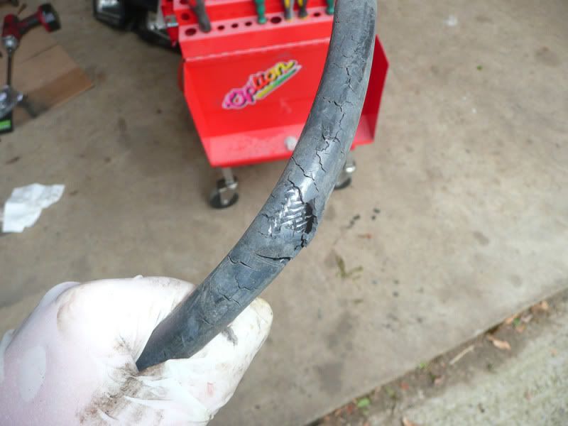

including a very unsafe fuel pipe!
started to paint it ( hamerrite, thinners and a compressor)
Then start putting the parts back in:
And tonight we cut out the old engine mounts and started to make new ones, once I had worked out how and we got the teering column enough room to work preoperly.
