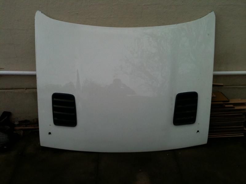

well i popped up to Liverpool this morning before work, nice easy 180mile round trip to start
the day off to collect a fibreglass bonnet.
im going to be interested to see what the weight difference is between a steel and fibreglass bonnet.

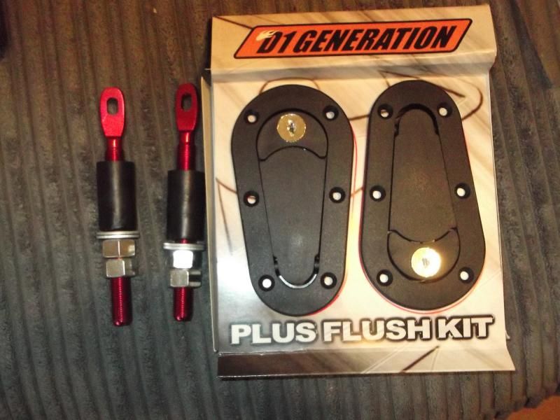

plus we'll be loosing the bonnet catch, cabling and pull mechanisum

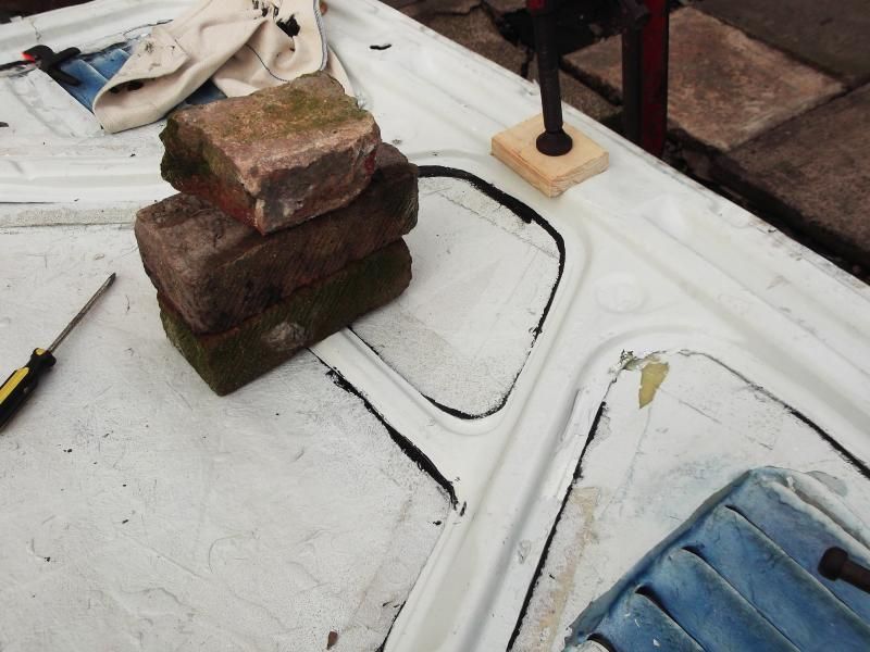

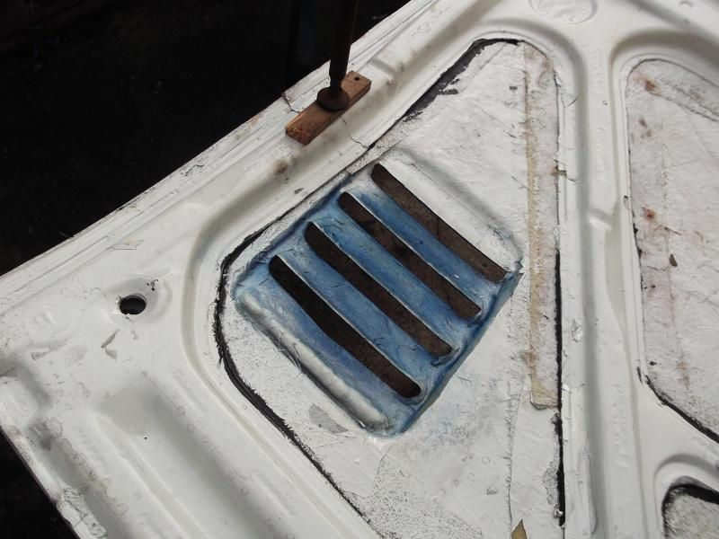

so to chill out today after buying the parts started work on the bonnet.
there are a couple of areas were the frame has come away from the top surface.
so have used some tiger seal and clamp the areas to give it a tight seal but once its
dried over night ill be adding some fibreglass sheeting to strengthen it up.
