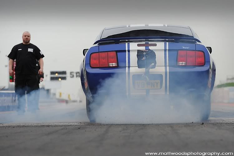

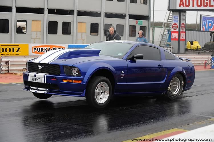

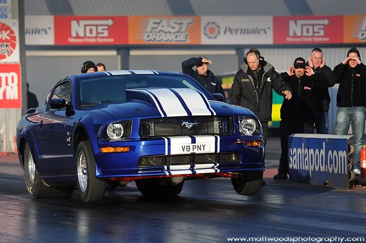

Managed a 10.1 @ 134mph with no gas which is a new PB for me running N/A
About 3 o'clock we flicked the gas on with 150bhp jets as we have rewired the nos to activate from the transbrake on launch and wanted to give it a go.
The run was no better and after further investigation we found that the throttle had only been working at 75% all day and wasn't activating the microswitch for the NOS.

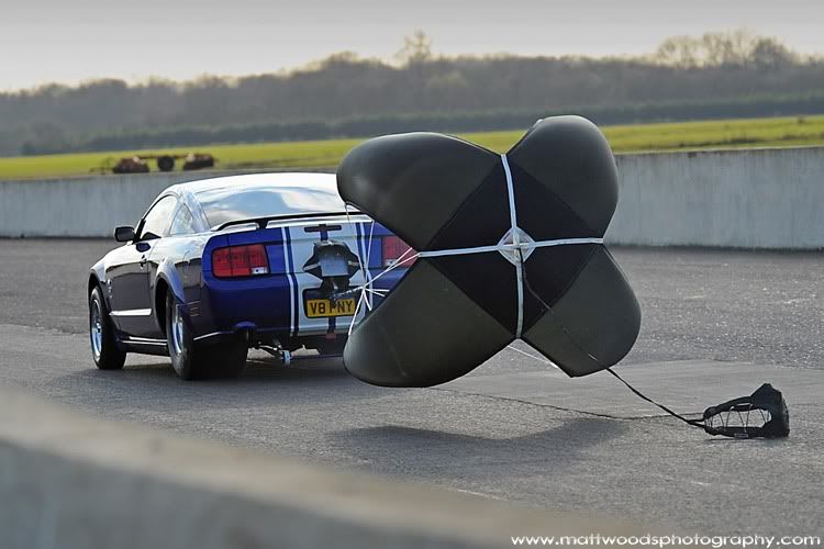

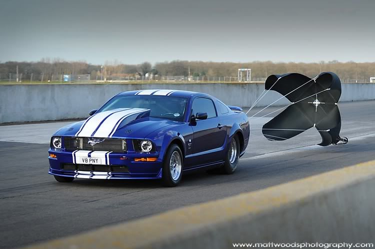

The car ran well and I even managed a couple of passenger runs and used the chute for the first time.
Matt had kindly offered to come up and take some snaps
