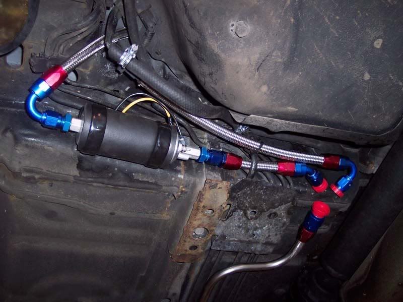

Of course, all this engine malarky is useless without serious upgrade in terms of fuel supply. For this, AMS have again engineered a 1000bhp capable fuel system. It consists of an uprated Walbro in-tank pump, coupled with a second Walbro pump outside the tank. Both pump supply a rigid -8 line to the front of the car.......

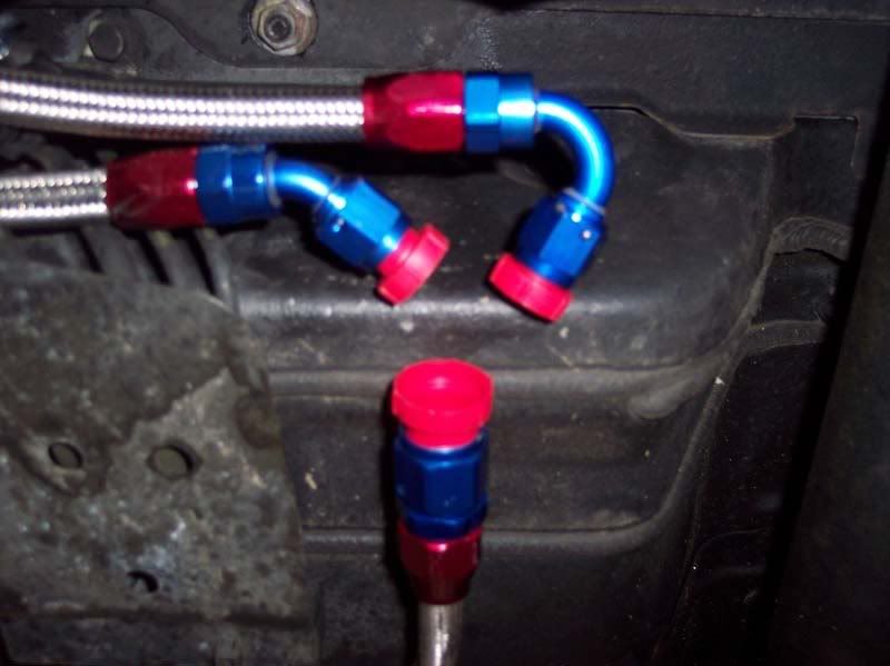

Awaiting fitment of the Billet Y-Piece.......

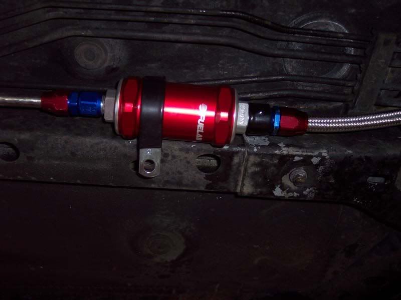

.....via a Billet 'Fuelab' Fuel Filter
This is controlled by a Fuelab Fuel Pressure Regulator (pics to follow)......
