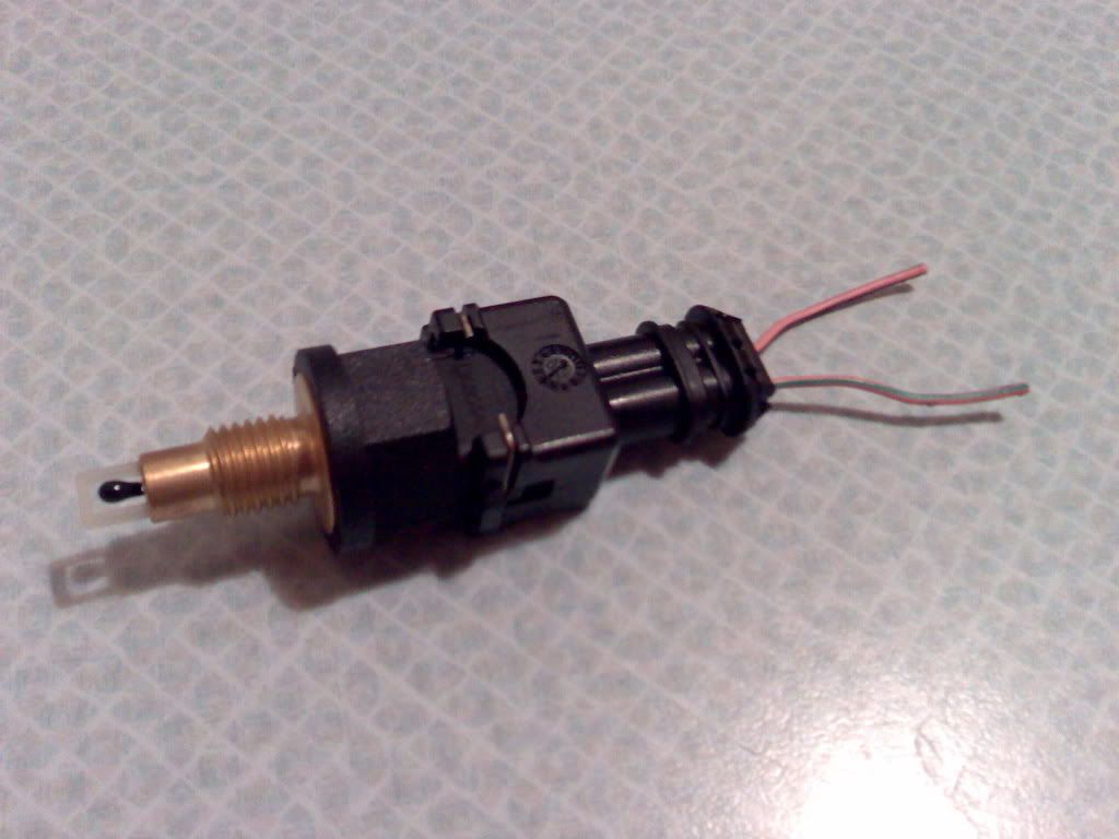

Actually unless he's changed it recently it's standard. Scott wrote a useful piece showing how the standard AIT sensor is *very* slow reacting, also in it's stock position it heat soaks like you wouldn't believe.
Actually I got a compatible high speed AIT sensor the other week (made for Triumph motorbikes!) but haven't got round to fitting it yet. I'll be putting mine in the elbow pipe between the intercooler and thottle body as it's less affected by heat soak there.
