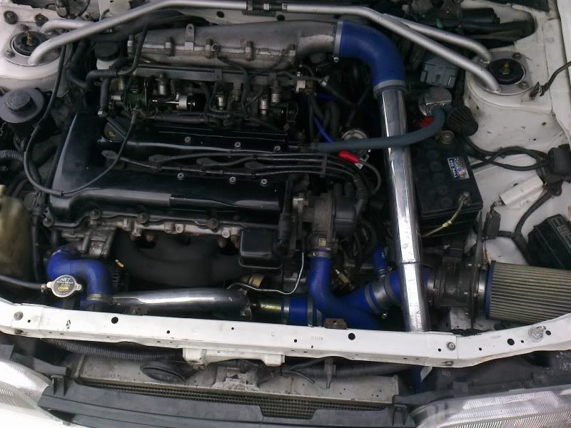

Put my turbo Technics hybrid turbo on from my old Grey Pulsar, plus changed the exhaust manifiold that i ported/matched and had ceramic coated.

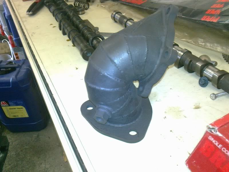

It also has a fabricated 2.5" turbo elbow that i had made to my spec.

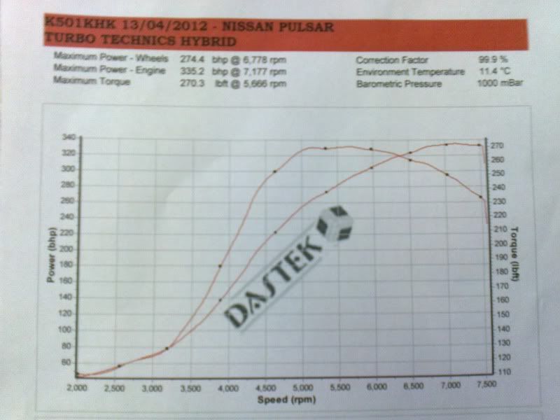

Added a little more boost to just under 16psi. Very happy with the results for standard engine internals/cams.

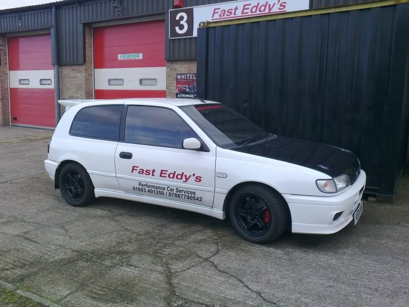

Got my trusty old Advan wheels on that i had on my first black Pulsar refurbed and on the new white car.
Won't be selling this car for a while.
