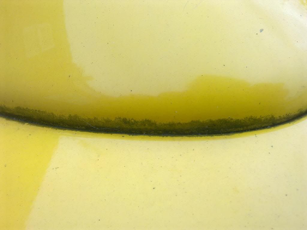

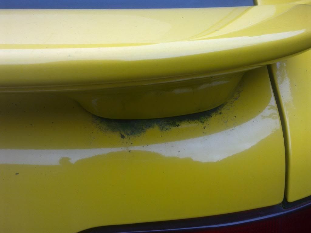

I put the battery back on and could not belive that she barely turned over once before striking into life. She realy had been becomming one with nature. From a distance that colour she wears still looks bright but up close she`s covered in green slime!:(

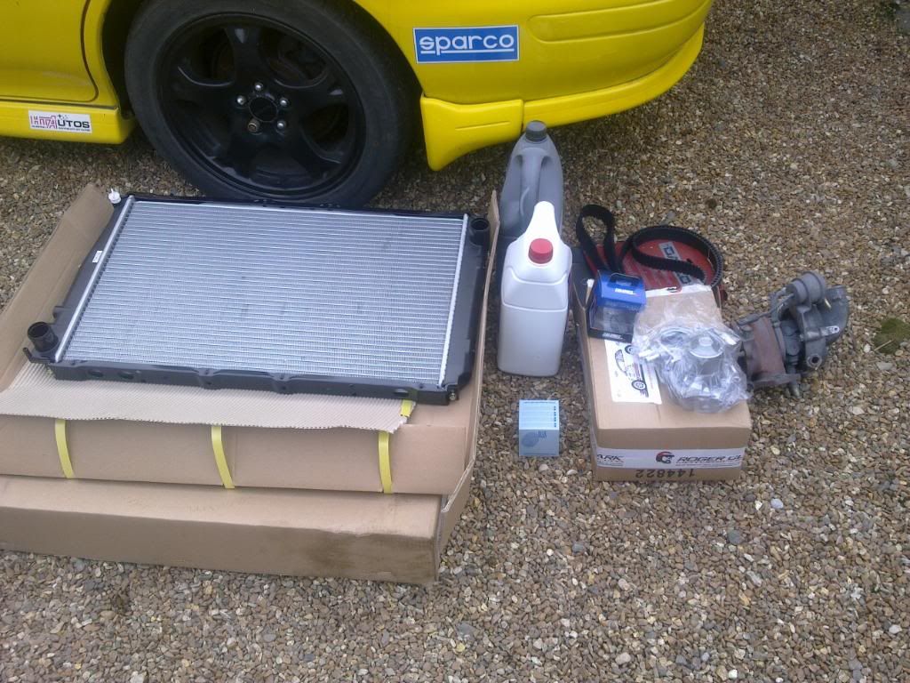

So today mission was to make a start fitting some of the parts that i have been collecting over the last year!
A new alloy rad, water pump, cooler thermostat, oil change etc.. and cambelt it at the same time.

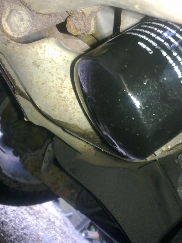

Ive had to get another cambelt today as the original one i had bought was left on the shelf in my shed (for god know how long) and the bloody chainsaw above it had leaked oil all over it.:mad:

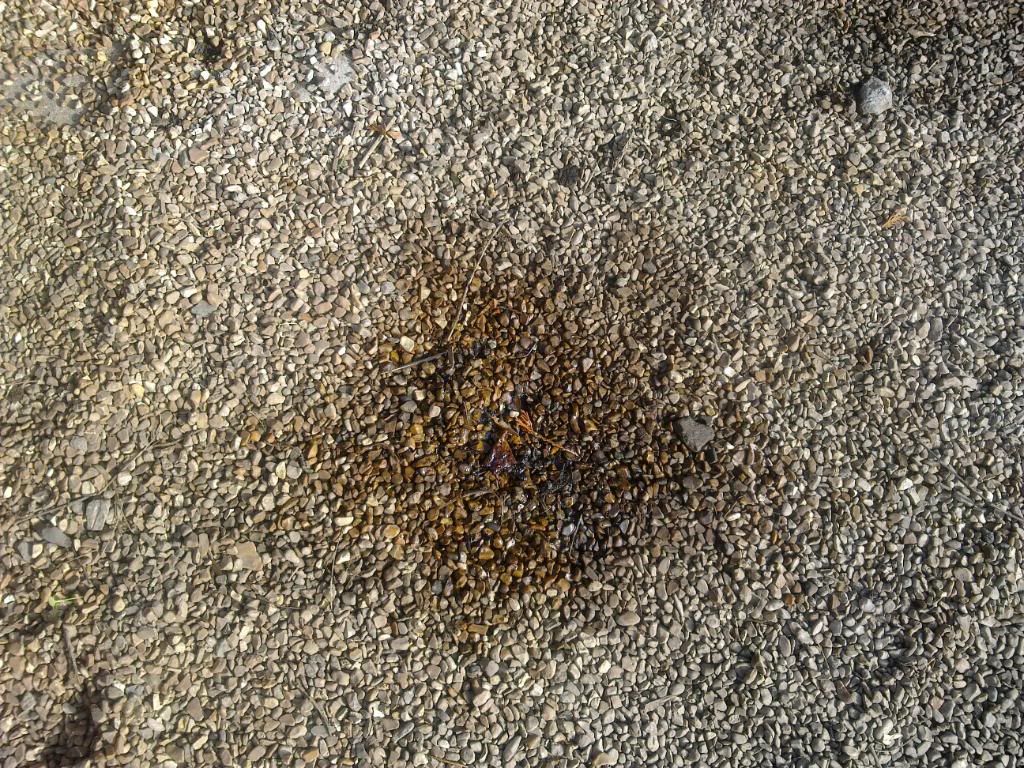

I moved the car to the garage and found a dirty great oil patch on the gravel beneath it.
But as soon as i got under the car, to my relief i found the cause
Nothing more than the oil filter had wound loose! Most likely my fault for not tightening it up enough last time around (just 460 mile ago) But i cant abide filters that have been over tightened (its a pet hate i have to deal with far too often) I`m just glad i found it now rather than when it had lost its oil and distroyed the engine possibly out on track.:eek:

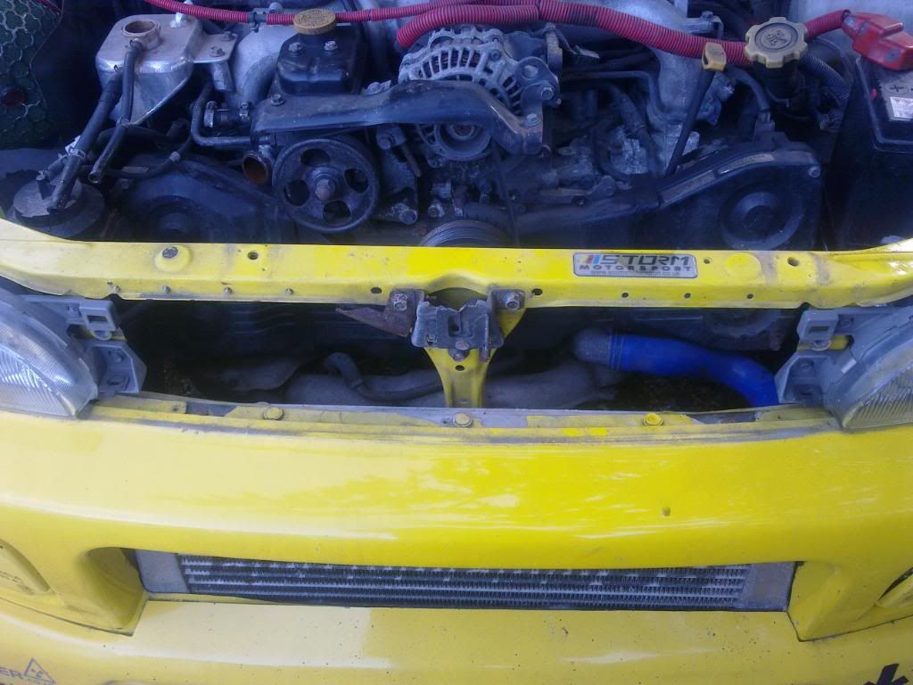

The strip down was going realy well and i had the rad out in mins.

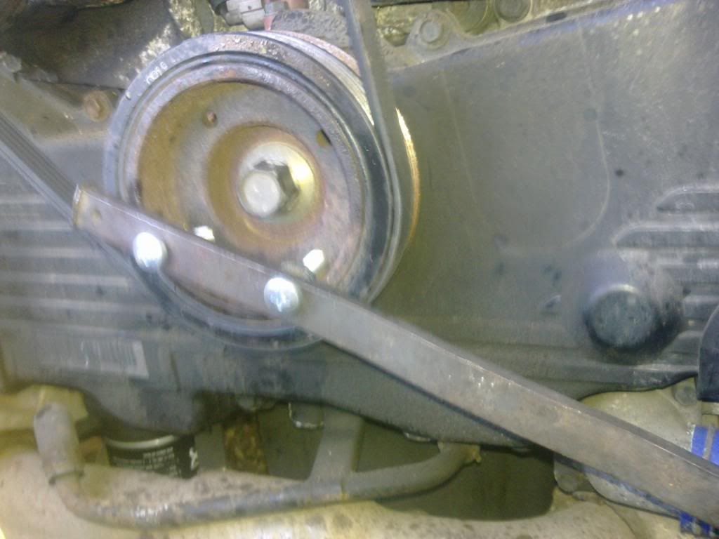

Then i had to make up a quick tool to lock the aux pulley off using a flat bar and with two holes drilled in it and two m8 bolts put through it to line up with the holes in the pulley
You can`t see in the photo, but i made the bar long enough that it would jam against the underside of the chassis rail so i could keep both hands free to pull on the breaker bar to get the centre nut un-done.
Again all was sailing along until i came to the cambelt tensioner......

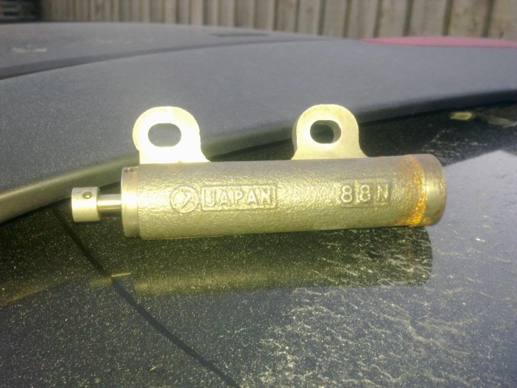

This is the stupid early type that has a seperate plunger behind the tensioner that had seized solid
My normal motor factors could get me a replacement for monday but at a cost of
