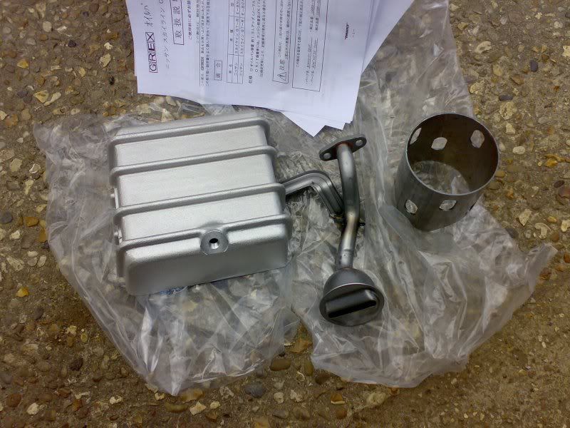

Has anyone got any pictures of a baffled or winged sump, as we need to get ours done.
^ that is an example of a subaru one. the oil pick up goes down into the well and is fed by effectively a pillar of oil above it. There are gates around the side of this to allow oil in from the main sump.
Oil drain down from the engine back on to the top of this tray and then down into the well.
i hope that helps.
