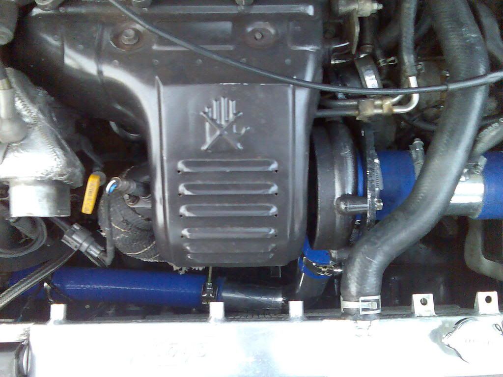

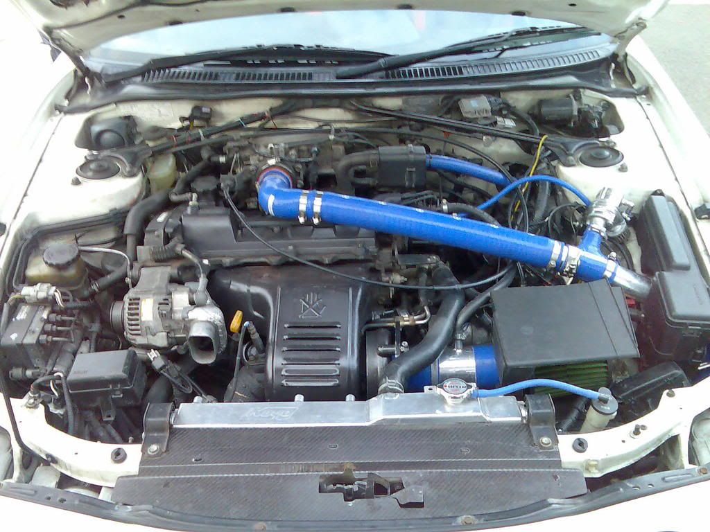

Since then I have have fitted:
Engine
Greddy Profec B
Blitz Access ECU
XS Power DP
Mongoose Exhaust
Straight Intake with Green filter (and home made airbox :oops: )

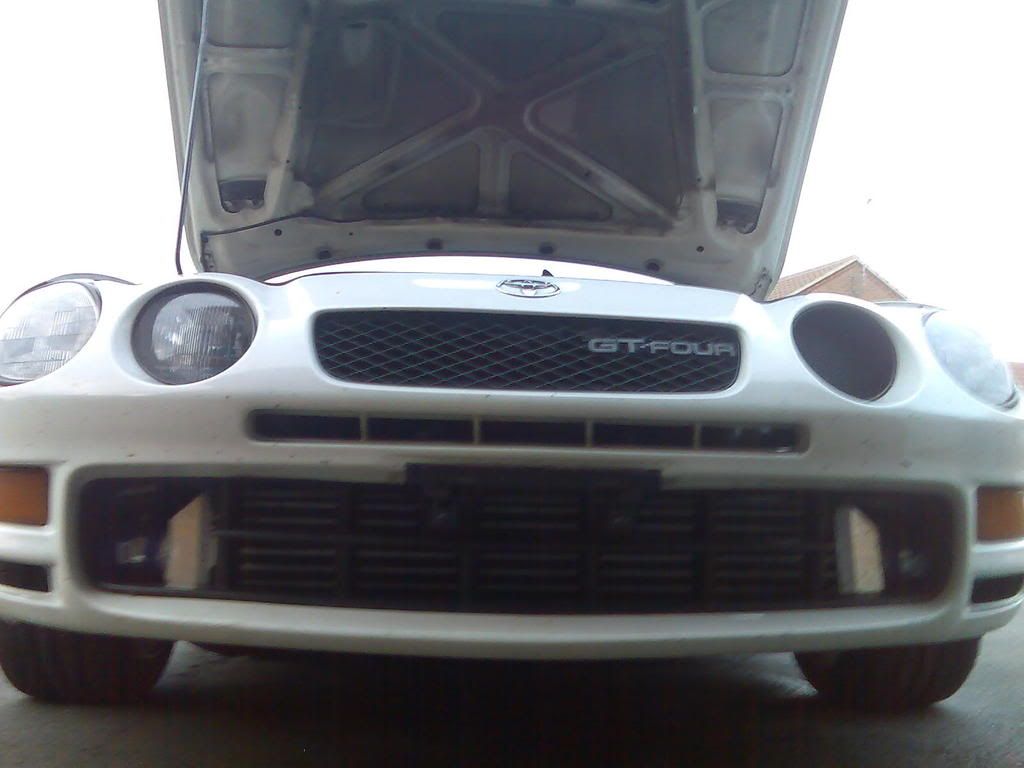

Pro Alloy FMIC and custom (home made :oops: pipe kit)
Koyo Rad
Oil cooler
Chassis
Whitline Adjustable ARB
Fensport Camber plates
Tein Springs
KYB Dampers
TRD Topmounts
Front Poly ARB bushes
Rear Poly Trailing arm bushes
Stipped interior, A/C etc
Relocated battery to the boot

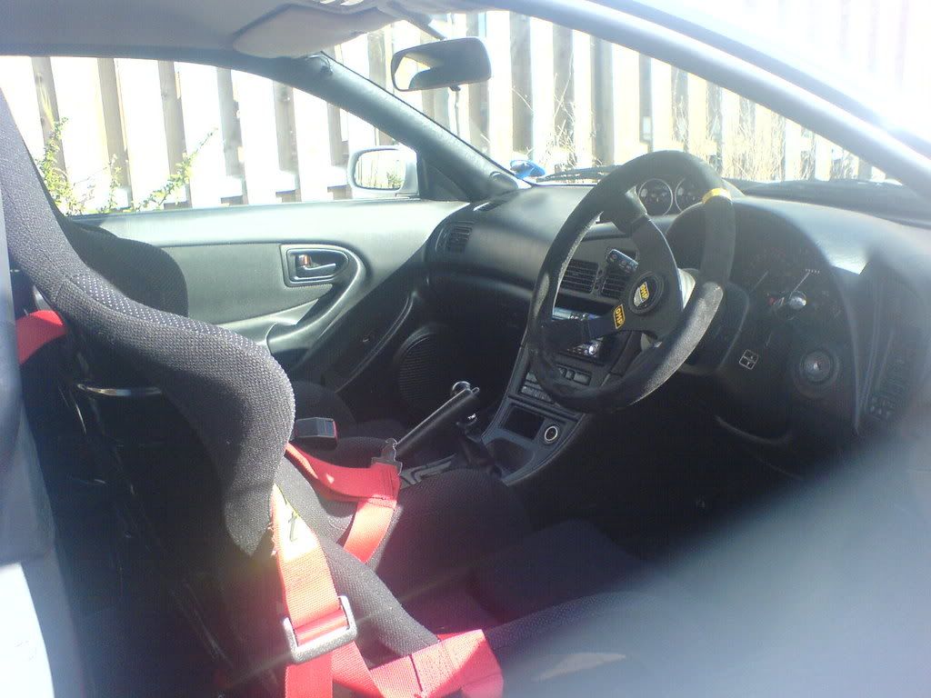

K Sport fixed seats and Bride Subframes
Sabelt Harnesses
OMP WRC Steering wheel
Track Wheels : Stock 3 spokes with 225 45 16 R888's
Road Wheels : 17x8 Compomotive Mo's with 225 45 17 Michelin PS2's
Body work
Removed Passenger main beam to feed filter
Removed rear wiper
Removed Electric Aerial

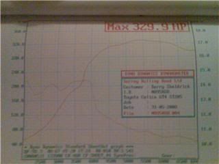

On this lot I made 330 BHP and 363 lbs/ft at Surrey Rolling Road using 1.3 bar on the standard hair dryer :lol: , injectors and cams. The car corner weighed in at 1355kg with half a tank of fuel, despite my best weight saving efforts :cry: I have removed over 100kg and its still portly! Although the weight was well spread around the car so its not all bad.
Anyway, as you may be able to make out from the crappy picture, the AFR's were "interesting" on the Blitz ECU:
Stays at 14.7 up to 3800rpm! :o
So I moved it through and bought a PFC. This is due to be mapped early August along with some SARD 800cc injectors so we shall see how the mapping goes....
Hmm - looks like it was staying in closed loop. No wonder you changed it :D

Yeah it was staying in closed loop for too long, you could feel the boost build but because there was no fuel, the car didn't accelerate hard. Once it hit 3800rpm and it came out of closed loop, off you went! :lol:
Russell, get yours checked buddy, I didn't like the idea of sitting that lean for so much of the rev range so I changed it. All of the Blitz's are slightly different so you maybe ok?
You can tell if its the same, the car wil seem to hold back until high 3 krpm then accelerate hard. By that time your boost gauge should have been at full boost.
