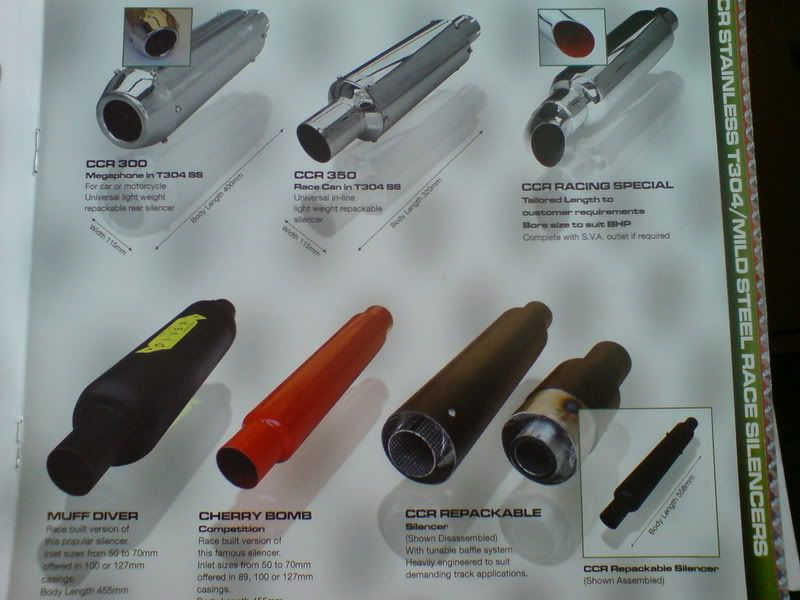

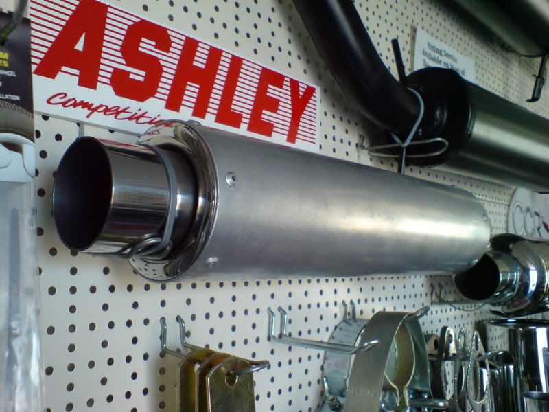

Jason,
There is no restriction as they are straight through resonator boxes.
I think it will be very loud with no cats, which act as silencers, and just a couple of these. Bm's are highly silenced with a couple of cats, a couple or resonators and a large baffled backbox.
Here are the ones that i do
If you want advise on this give me a ring mate.

they look perfect. if you are at the next meet we can discuss my options and the noise issue
