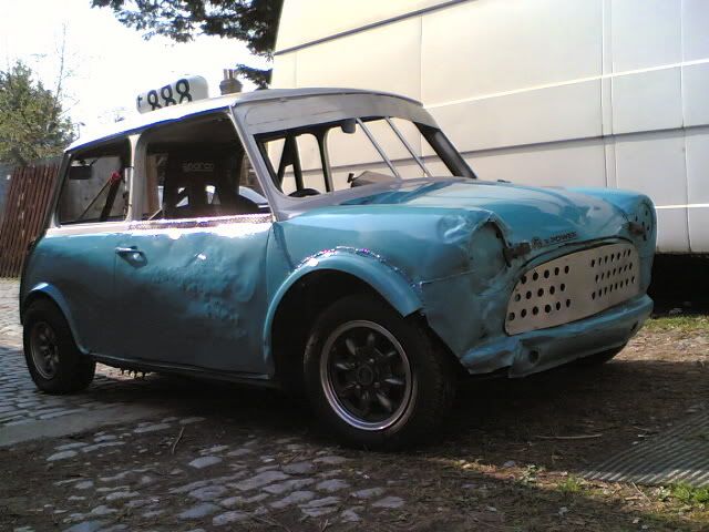

At the moment I am currently doing my road/trackish Mini;
Its a 998cc 84' Mini 25 and will have some MK1 60's styling.
The spec will be;
998cc A+
Head Skimmed 60 thou'
Janspeed Stage 3 head
Swiftune 1.5 Rockers
Double Valve Springs
LCB Maniflow
Maniflow Inlet
2'' side Exhuast
ITG HIF 44 Air Filter
Eletric Fuel Pump
Lucas Sports Coil
Rebuilt gearbox (3.4)
Centre oil pick up pipe
hopefully around 60 - 70ish BHP.
I have done also done StockCar racing from when I was 13 in my Mini at Aldershot
